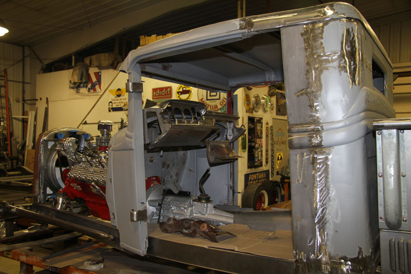

    You can see here from a couple of different angles that the cab stretch is lookin good, I am extremely happy with it.

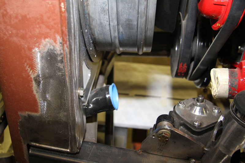

    The engine sets nice but, the alternator needs to be repositioned to top center of the engine. Here you can see it stick out the side of the engine bay.

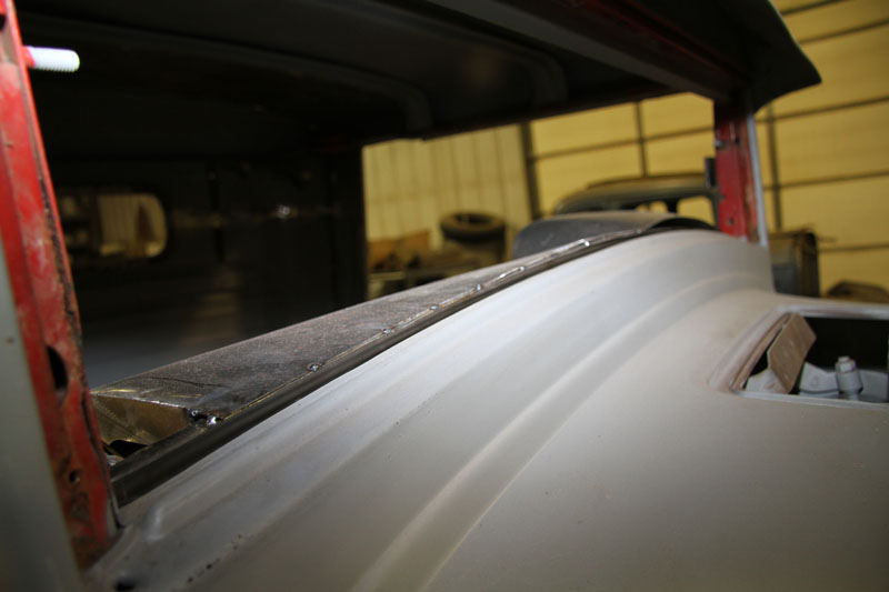

    Here is more detail of the roof stretch and door jam. Also, the fuel filter and pump are in.

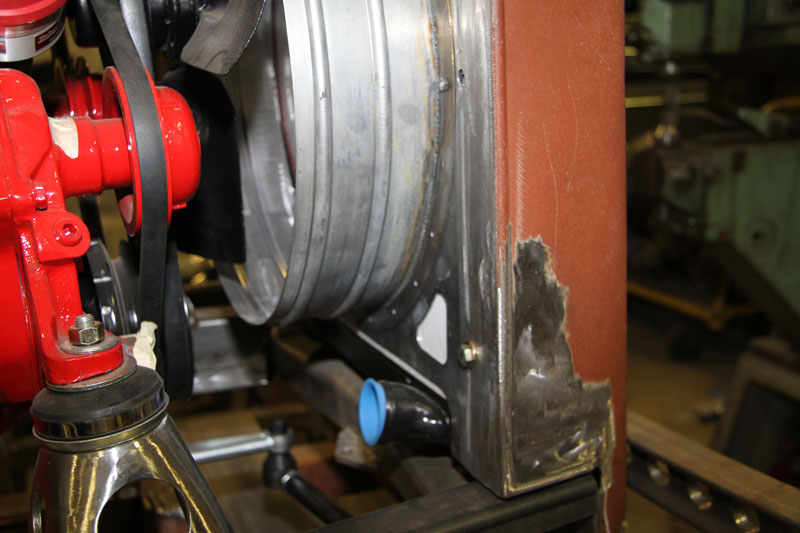

    The fan shroud is done. As I mentioned in an earlier post the fan has to be moved down and forward. Basically it will be centered in the hoop.

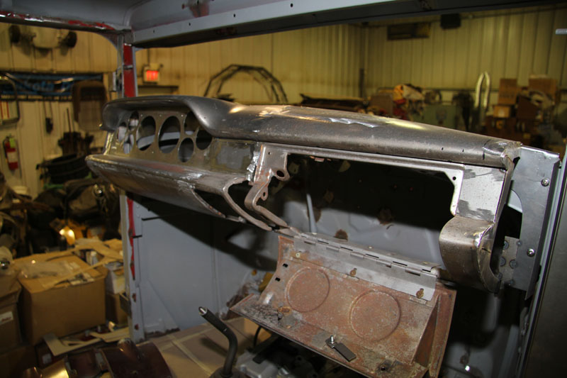

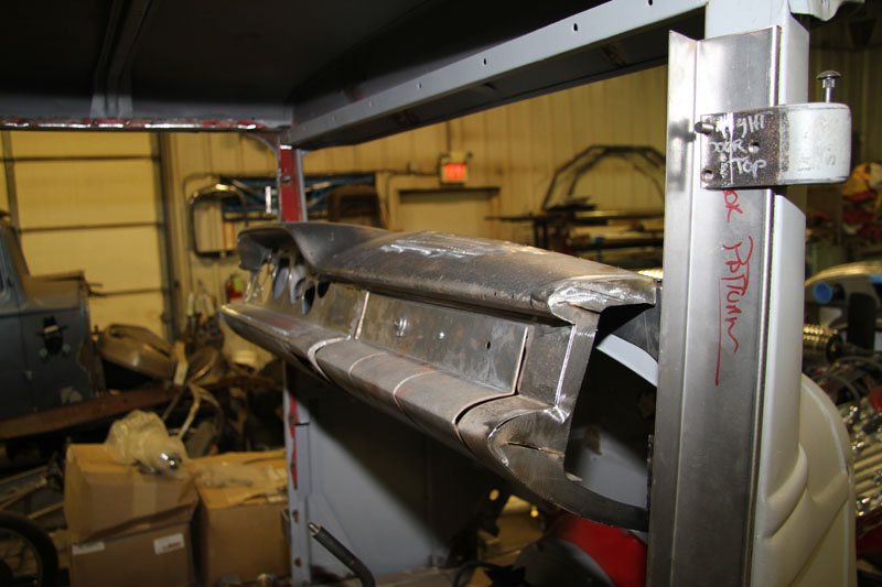

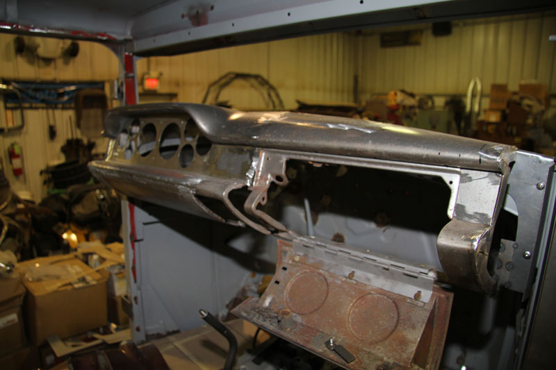

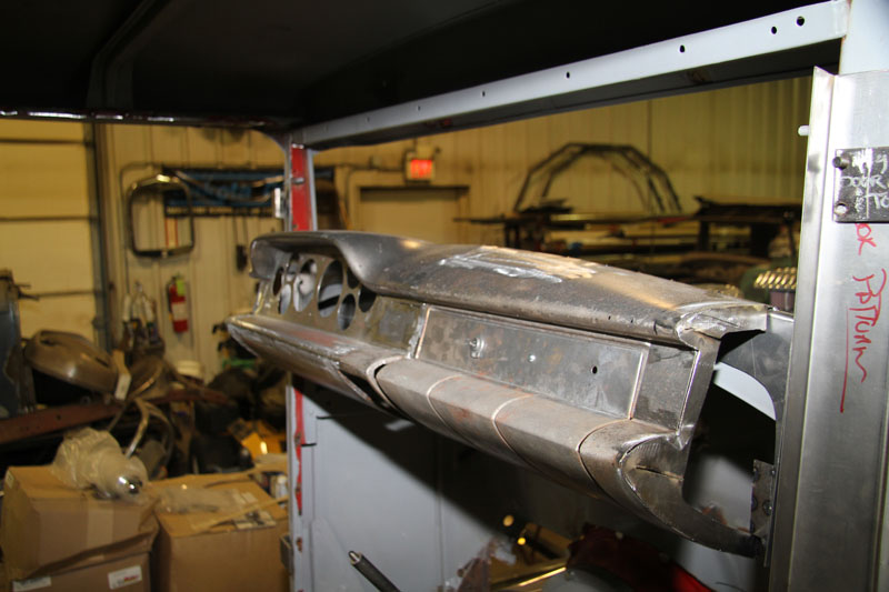

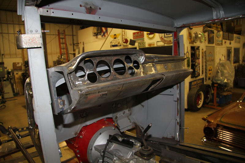

    In a previous post I mentioned the dash I'm using is out of a 1958 Impala. You can see the instrument cluster has been fabricated and welded in. The dash has been split and narrowed and if you are familiar with the Impala dash, it wraps around to the left & right sides. It has been split and the two ends will be boxed and will be mounted to the interior side of the doors so, when the doors are closed the dash will still wrap around. The glove box remains but, the ash tray and radio were cut out. It's comming together but there is a lot of m***aging to do. Once the fitment is right the original steering column portion of the Impala dash will be grafted back in and the turn indicator and high beam indicator LED's will be mounted in the area above the column where the automatic gear indicator is.
