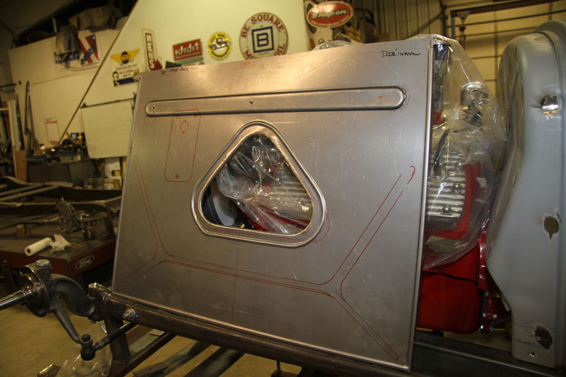

    Because the cab is stretched 10" (4" in the cab, 6" in the door) the entire door will be fabricated from scratch. Here you can see the door skin is being mocked up trying to get an idea of where the the bottom of the window will go.
  21. Retribution
    Joined: Aug 11, 2009
    Posts: 662
    Retribution
    from Western PA
    Here is the inner door panel.

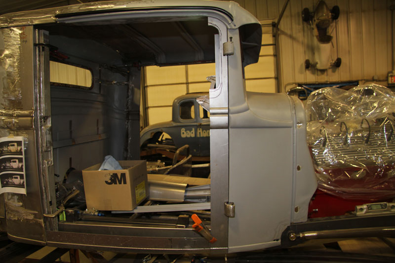

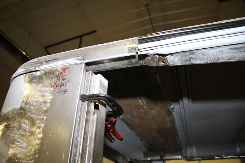

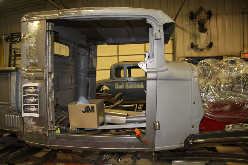

    In order to extract the actual door size, the cab need to be finished up first. New re-popped drip rails (R/L) were ordered. The originals will be removed and good sections cut out and welded on to extend the new ones to make up for the stretch. Also, the door frame above the door needs to be finished up as well.

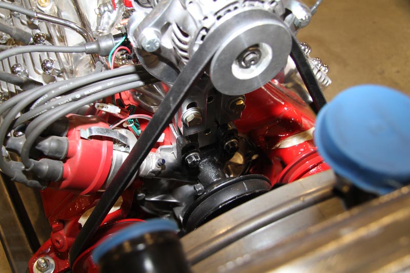

    The 34 is moving again. As you can see the fan is finally figured out. To get it center in the fan shroud AND have it adjustable took some figuring out. Also, it's off the table and on the floor. Now I can really see how high it's going to be, I set the chair next to it for scale.

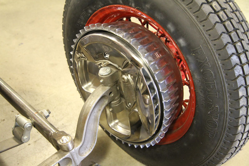

    Left front SoCal Speed Shop brake is installed, waiting on right, they shipped two left. Man they look really good, better than I imagined they would.

  30. Retribution
    Posts: 662
    Retribution
    from Western PA
    Both John's Industries rear brakes are installed too. The outer drums are polished just like the fronts. I got the last pair of polished rears before John's stopped selling them. Now you can buy cast only and you have to polish them yourself. I was really lucky.
