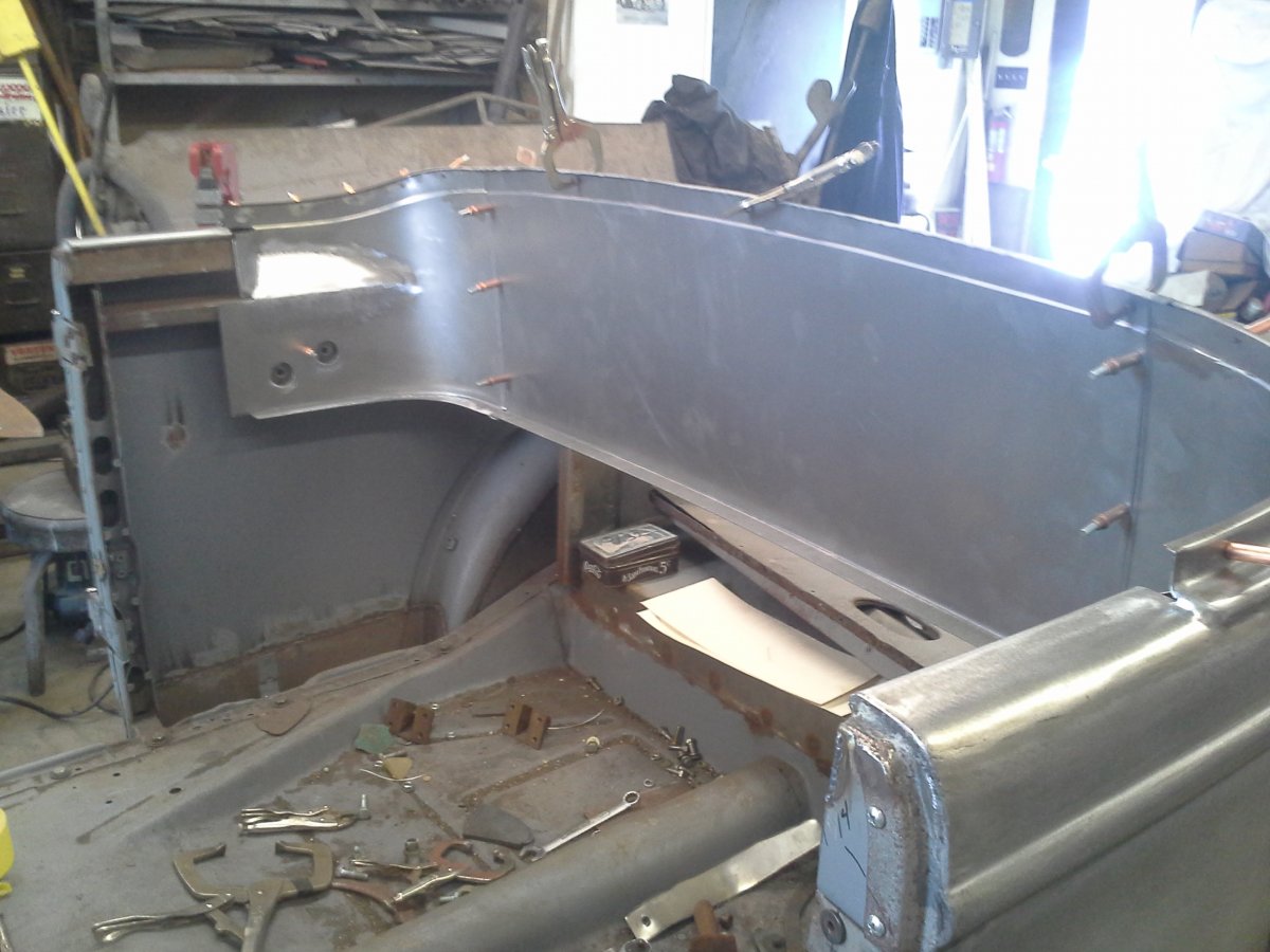

    It's not looking good for Detroit. ..this thing is fighting me. Got the top irons mounted. Trunk hinges are fighting me going to have to heat and bend them to get them right. IMG_20160205_134343.jpg 12654168_1151647028209291_8734724585484813944_n.jpg

    Made the area the top is gonna sit in. Gotta primer the back sides and weld her in.

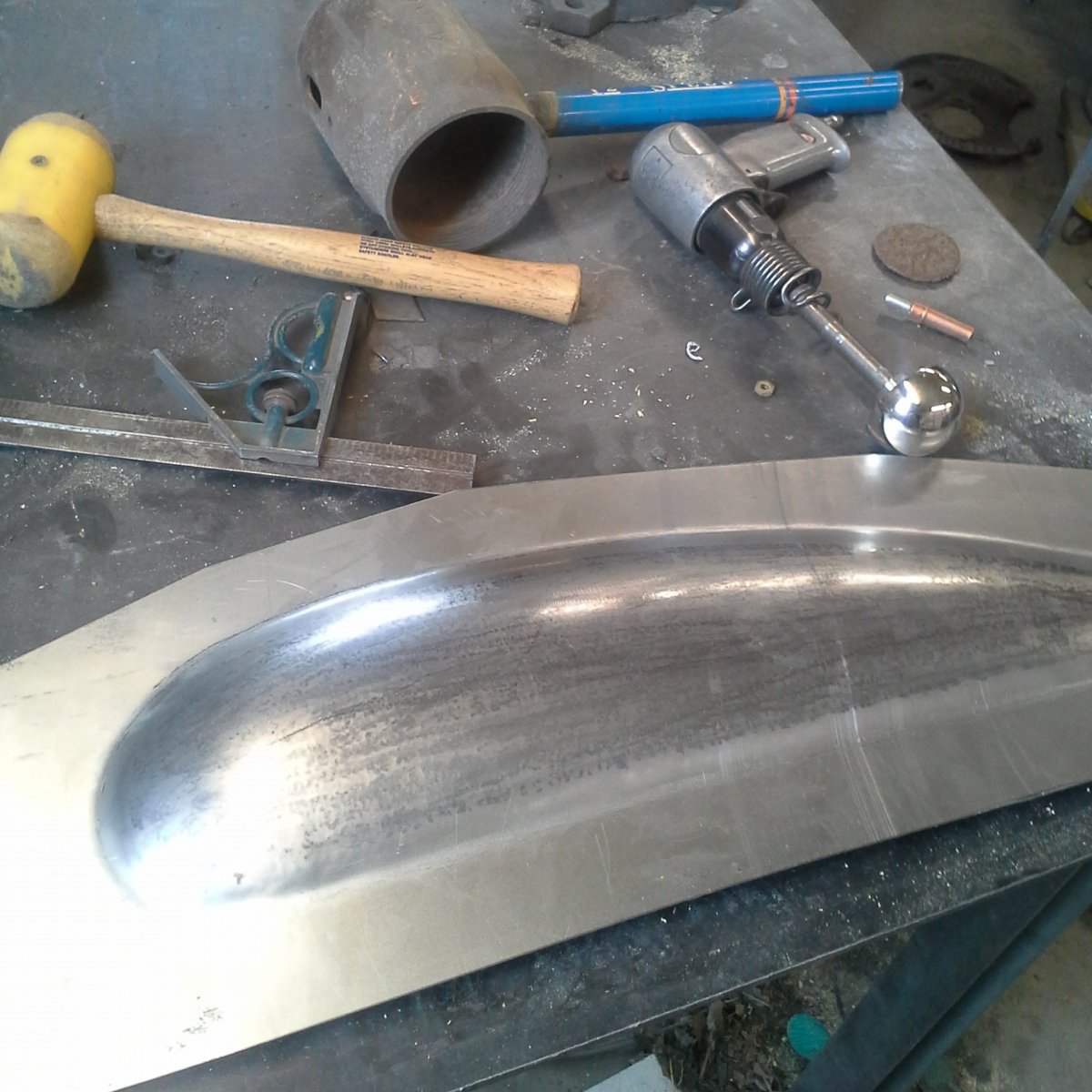

    I did get a good but done on the inner fender splash pans. I decided it was best to start over and make both sides at the same time. It would have been harder to duplicate the one I did a while back.
    I had the hammer form already. But this time I have some better tools. I used an artificial knee on the end of the air hammer to help form the bubble. Then planished it and it came out great. I still have a lot to do but they're coming out pretty good. Not to mention I've got a lot less time in making the pair than I had making the single

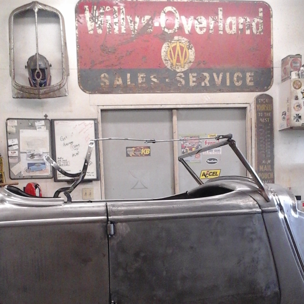

    I got my top bows and started playing with the top. Looks tall in the picture but looks just right in person. Had to raise the back bow just a little. 20160304_165959.jpg

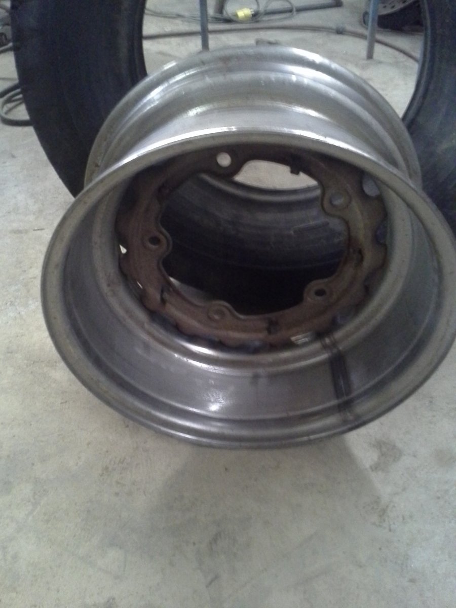

    Also picked up some 17 inch wheels for my 750/17 goodyears. They need narrowed about 2 inches but will work perfect. Will be able to make a Goodyear wheel center that pops on and can also run a set of spyder caps 20160304_170953.jpg
