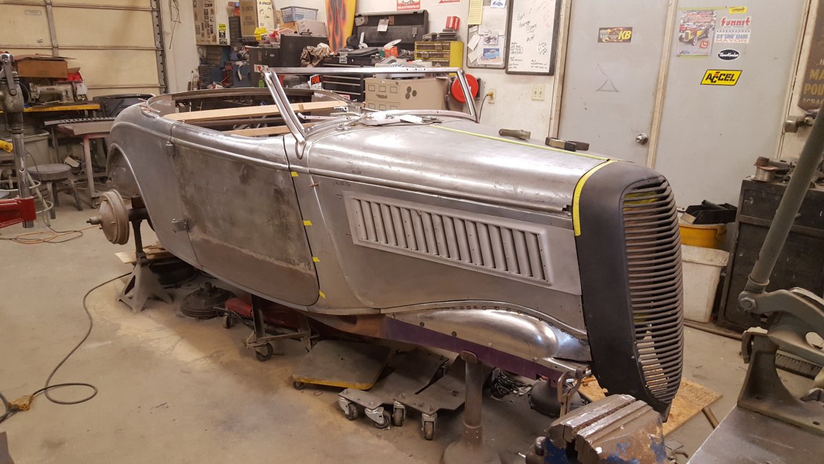

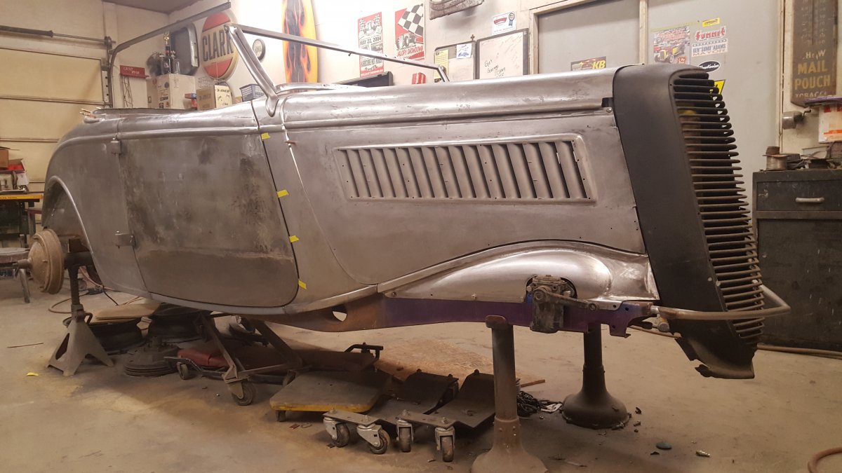

    Well I'm back on my car. Here's a current shot. I remade the splash pans below the hood. Both are now pretty much done. Decided to go with 35 hoodsides. One is done now. The deck lid is also fitted. Not too long till I tear it apart for paint. 20170121_154729.jpg

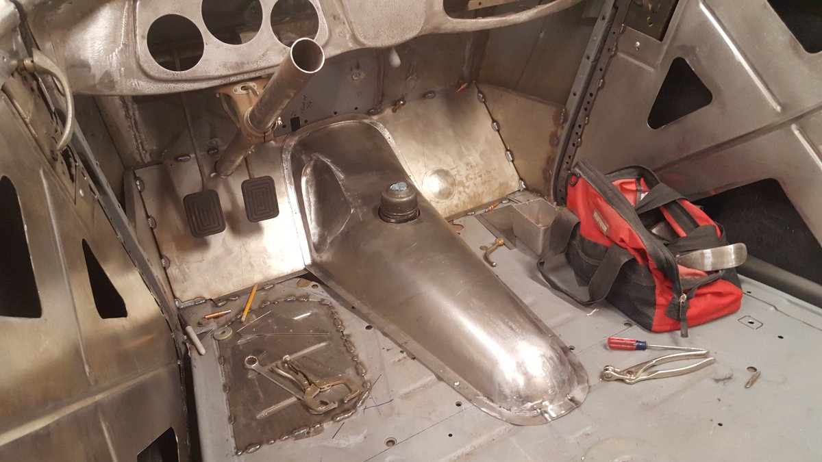

    Here's the trans tunnel with a recess for the gas pedal. 20170128_221652.jpg

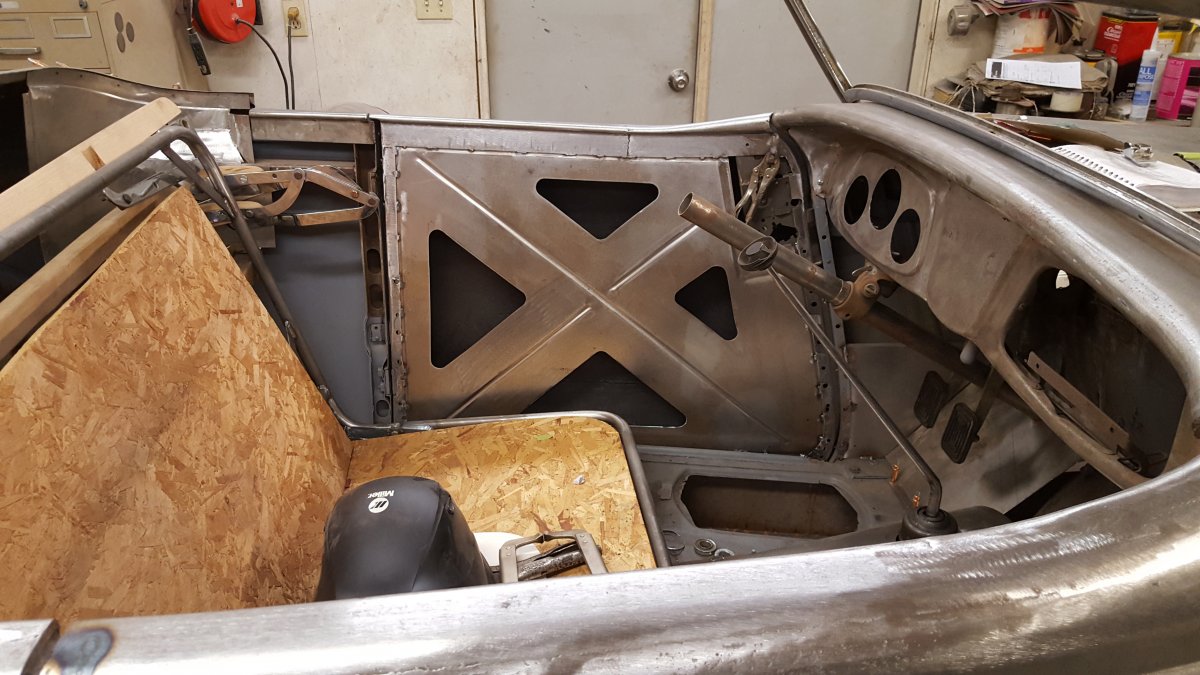

    Doors now have their inner structure and I also made a seat....sorry this wood was just temporary so I could sit in it 20170114_230055.jpg

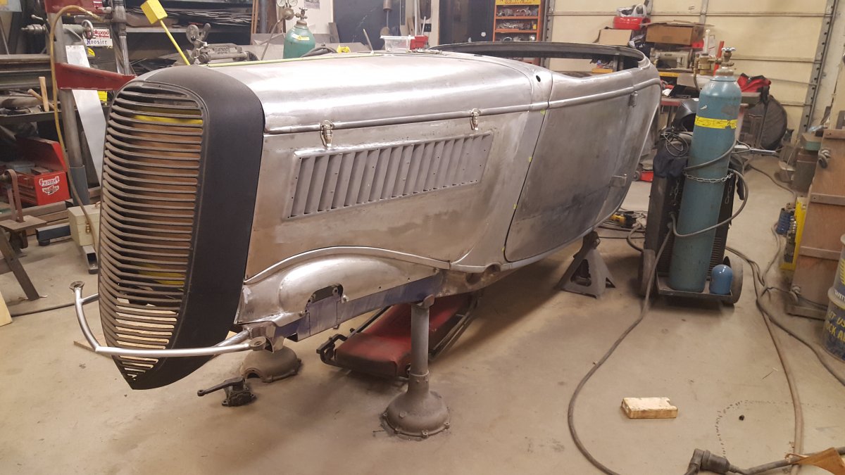

    Latches are on and hood is just about done with the gapping. 20170206_211500.jpg 20170206_182029.jpg

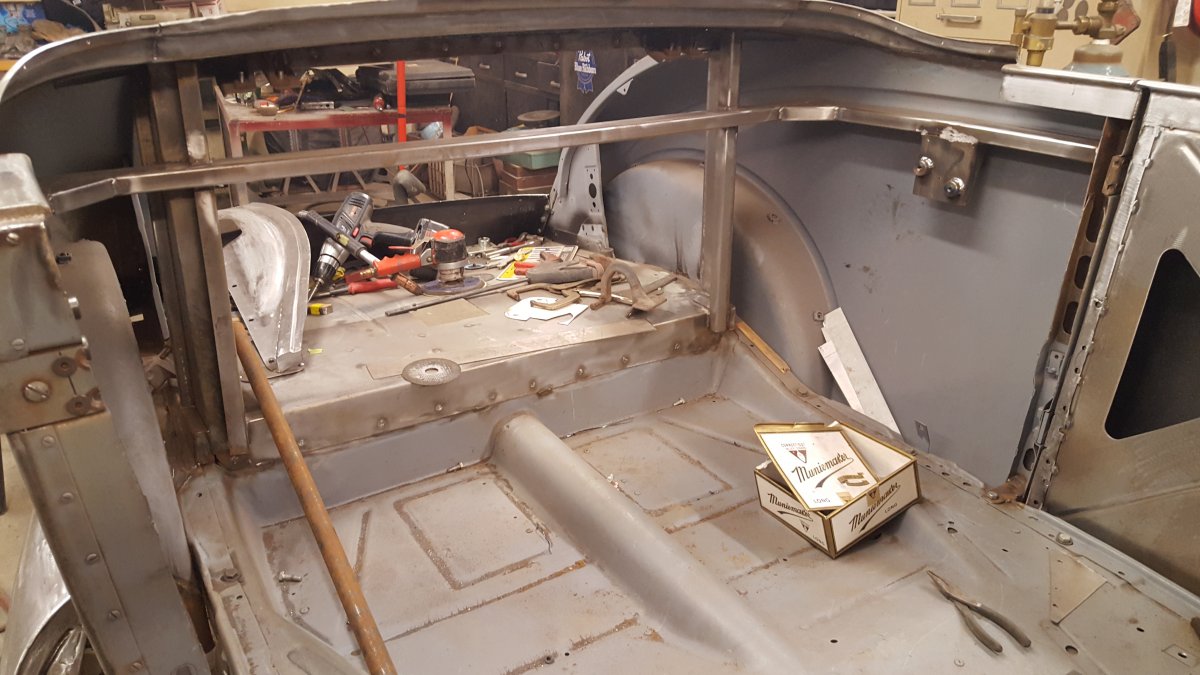

    Here's the bracing I added to sturdy it up and mount the top... 20170206_182049.jpg
