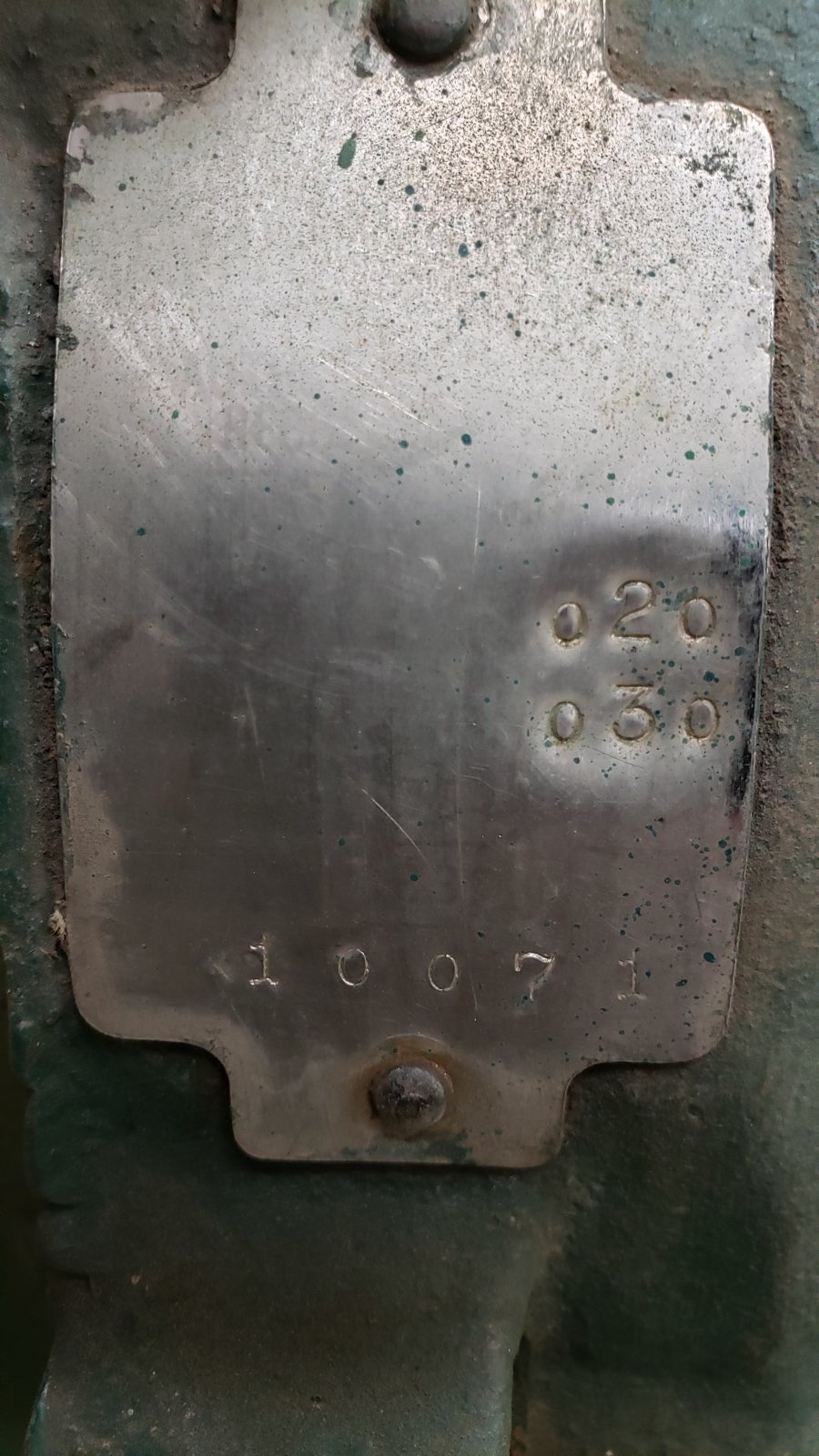

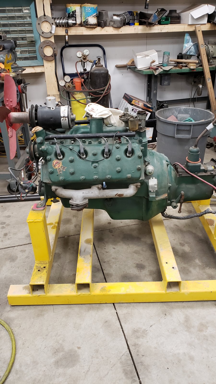

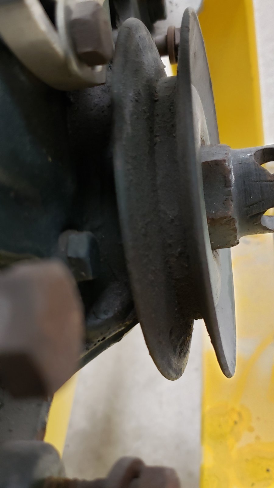

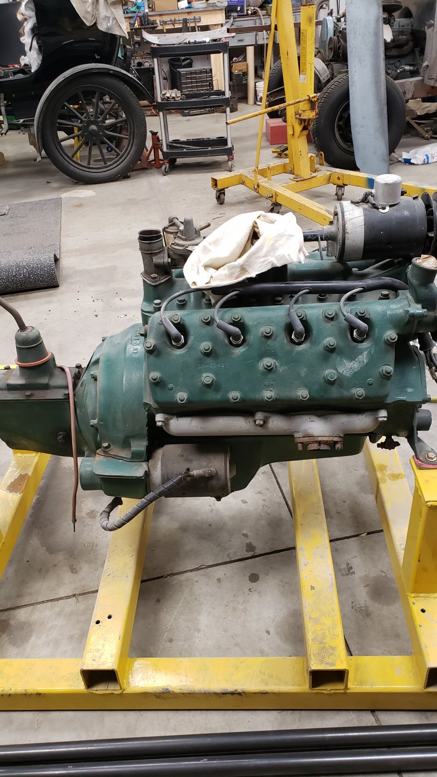

  1. I bought this flathead 5-6 years ago , I believe it has been rebuilt and never run . I started it and put it up in my mezzanine, It is cleanly painted ,has ford rebuild tags .
    No paint burned off , exhaust manifolds are clean pullies still have paint in them . I know I started it once before , but Been in heated storage since . Dump some oil in the cylinders and run it or ??? 20220428_211606.jpg 20220428_211056.jpg 20220428_211552.jpg 20220428_211314.jpg 20220428_211300.jpg 20220428_211239.jpg 20220428_211043.jpg

    First of all, if it is a '37, it has earlier heads on it. It really looks like an earlier engine. (EDIT : Ooops; I see you're from Canada. I'm not sure of what they did up there in those days. I do see a "68" on the right head, which, in the US at least, means 1936. Is there an "LB" stamped on it anyplace, perchance?)

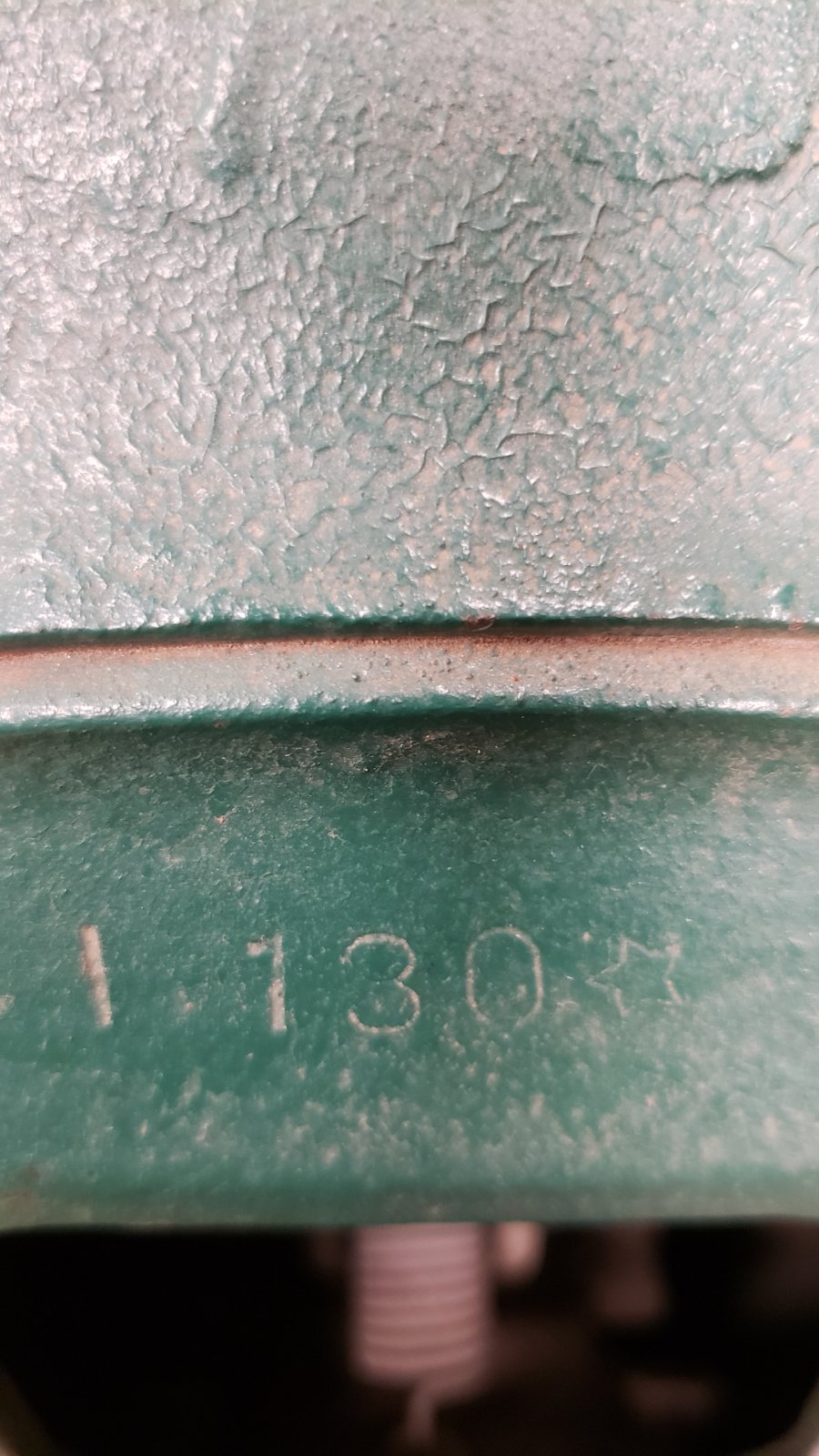

  4. Here are the numbers off the heads ,back of block and transmission 20220428_222439.jpg 20220428_222455.jpg 20220428_222405.jpg 20220428_222814.jpg 20220428_222828.jpg 20220428_223039.jpg 20220428_222650.jpg 20220428_222615.jpg

    It is a '37 - early '38 block with '36 heads.

  6. My observation :rolleyes: , Have you ever tripped over the yellow square pipes ? I would :oops: . Your real solid engine stand could be at least 8 inches narrower and needs wheels.

  8. The engine was on that stand when I bought the engine , 3 inch tube , was great for storing and transporting . But engine will go on my run in stand now .Dont know what I will do with the stand now though

  10. Mains or 30 thou , rods are 20 thou any guesses on what the bore is ??? Sure made a mess with the number stamp . With the wear on the crankshaft I would have to guess 60 thou . Cant see them sleeving the engine back to standard . Dont really want to pull a head !!
