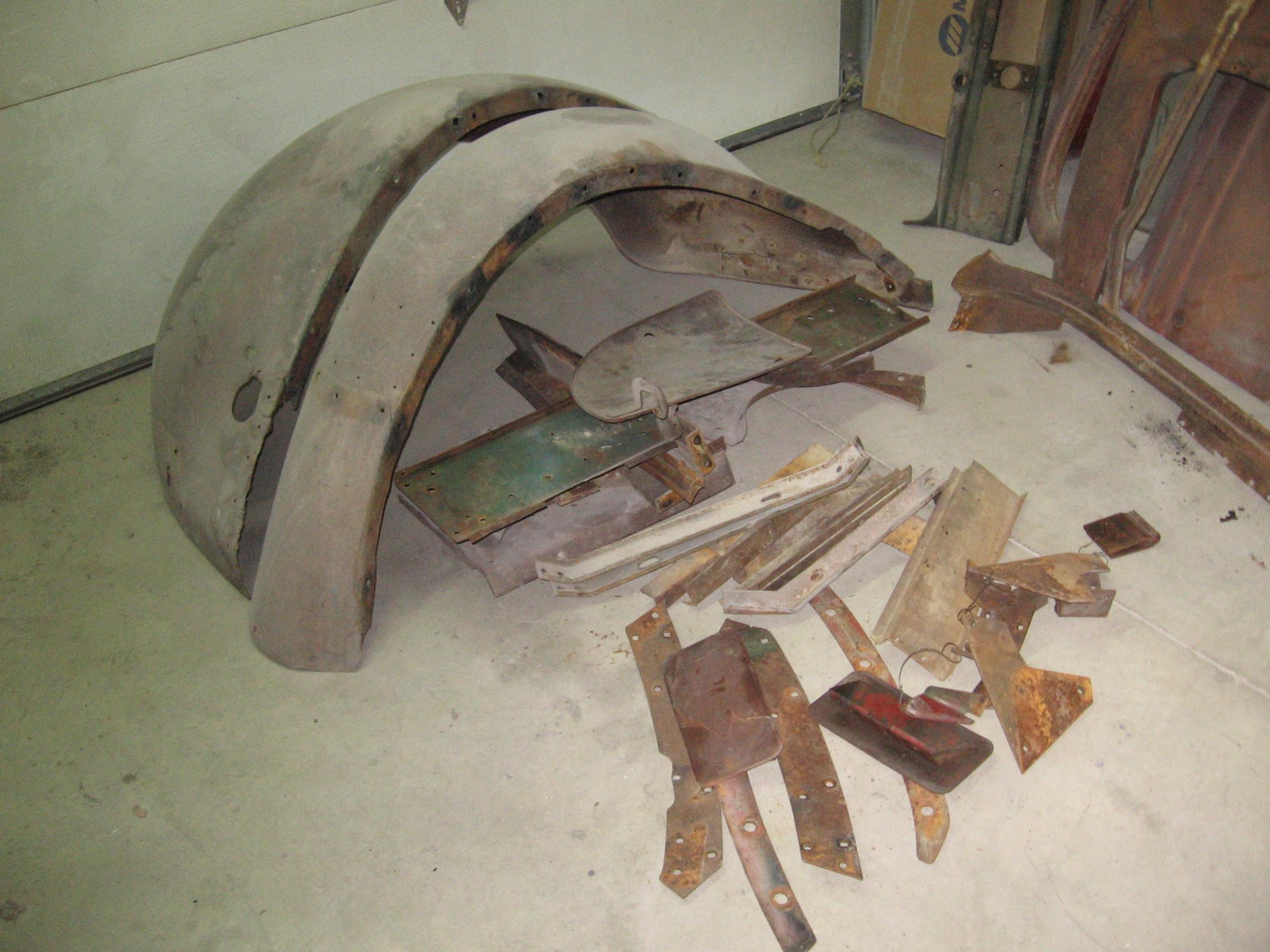

    So for the last couple of weeks I have been tearing this all apart
    so I can sandblast it.
    The rear panel had been caved in really hard and the seam between
    the two panels had been arc welded at some point.
    I made the decision to cut the panel right off for repair and the seam will be replaced with a fresh 2" piece of metal with the body line rolled into it,hammer welded.
    I may end up building a whole new rear panel, but will determine that when the repairs start on that part.

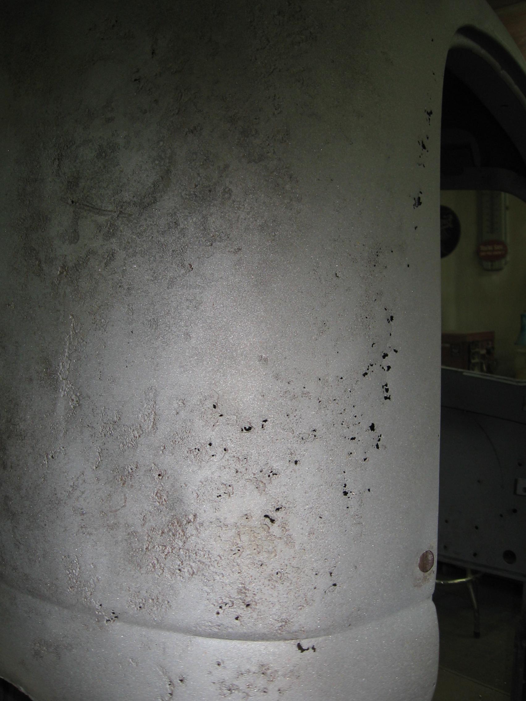

    I did 3 1/2 hours, lots of brackets and parts and angles, but it'd done.
    A few surprises.
    The truck had sat in a swampy area on its back right corner and I knew there was lots of rust perforations on the top corner, I didn't realize there would be any on the right door, but there is.
    No big deal, it is all repairable.
    The real nice part is all the sills and lower cab are really solid with no rust through at all. I tend to look at the positive!

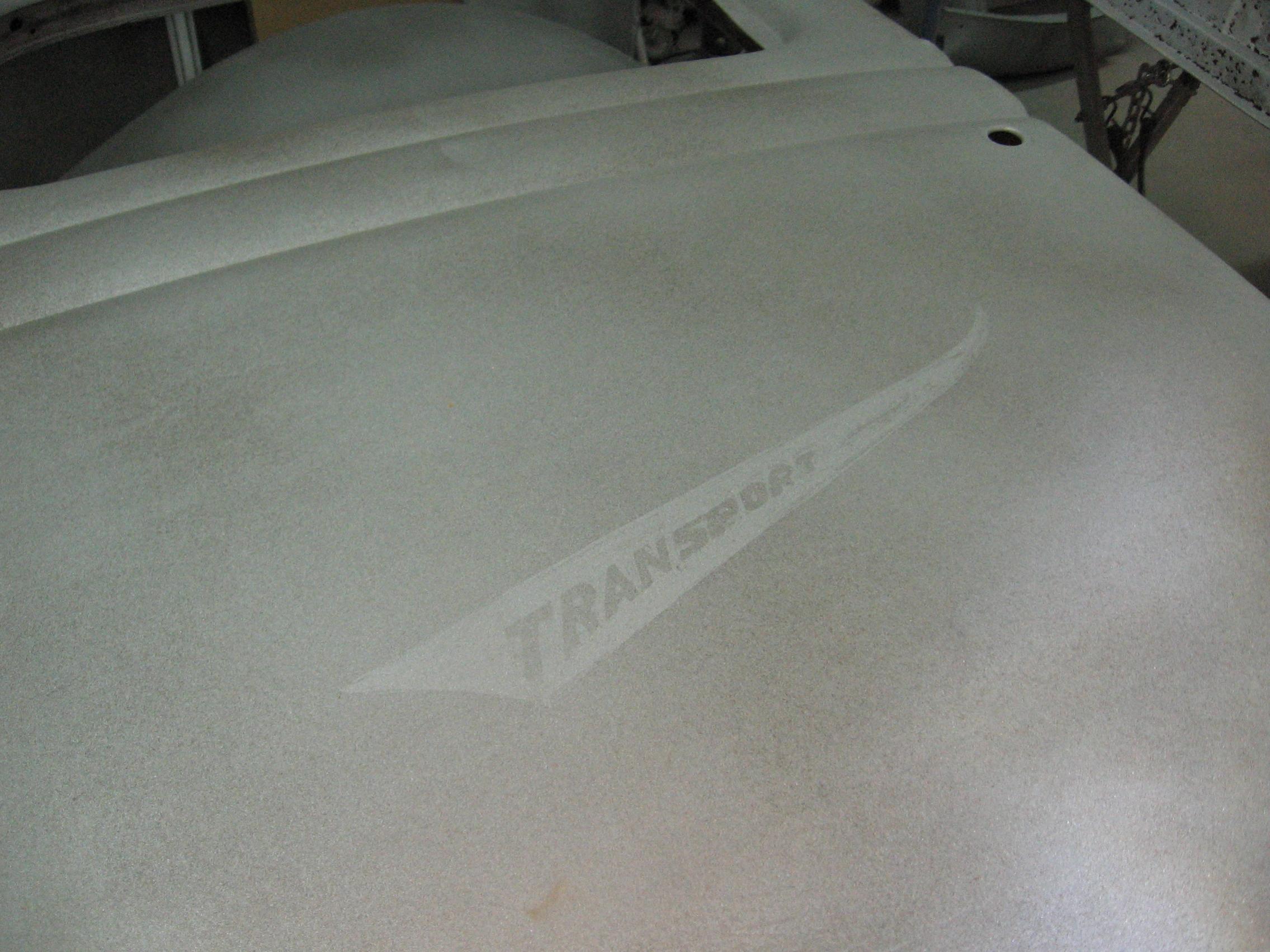

    The doors had this really cool Transport logo, I did take a few pictures of it and measurements in the thought I may replicate it.
    The doors were blasted very well, but the ghost of that logo remains!

    Hey did you ever figure out what the company's name was?
  5. DAVEO!
    Joined: Dec 4, 2011
    Posts: 291
    DAVEO!
    OH MAN!!! way cool!!! i been wanting to build a COE for a long time still looking for one gonna build a slammed car hauler if i ever can get a hold of one. great work! subscribe!
  6. I was told that the companys name was
    DelDay Transport
    Pex, another COE guy up here told me he had another one of their trucks with the same logo.
