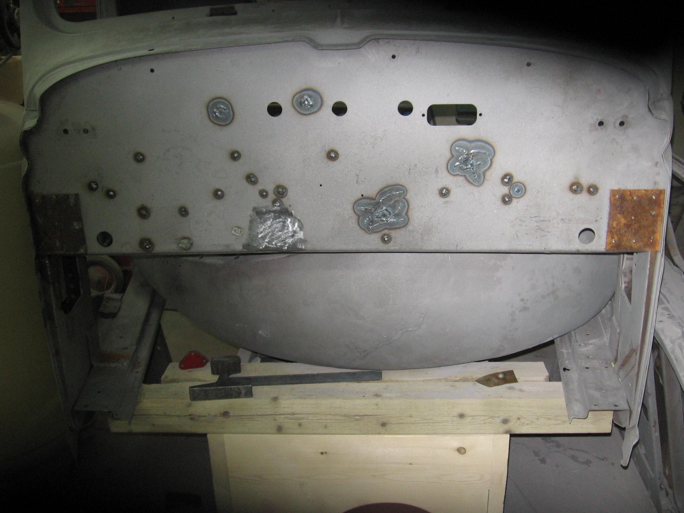

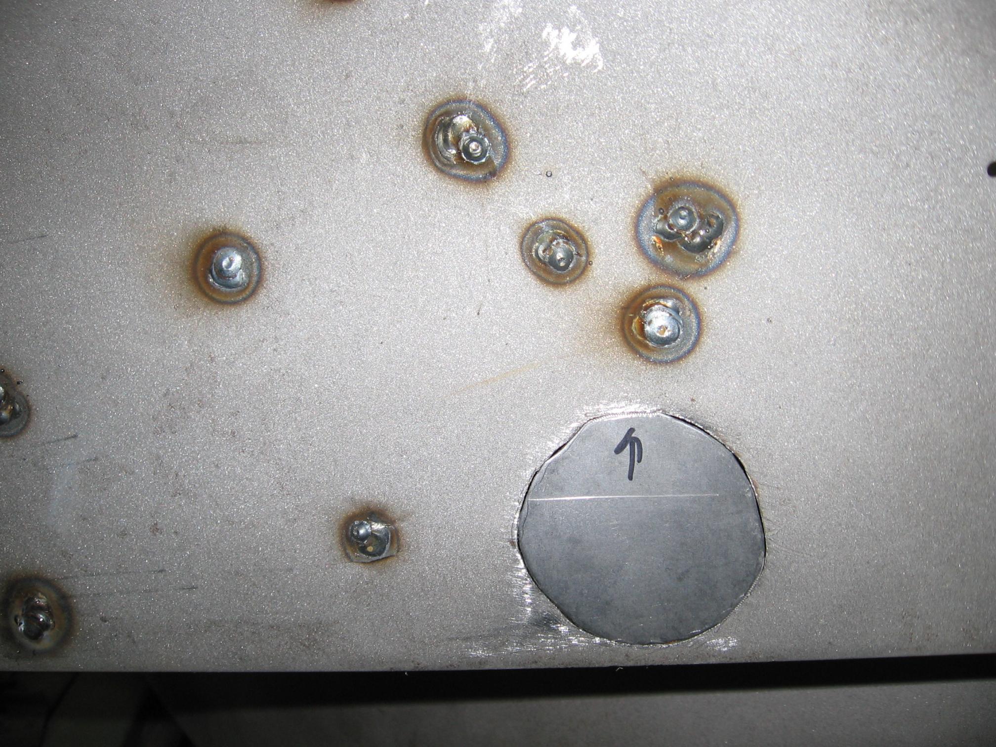

  10. Ok, little update.
    Despite all the things I got on the go right now, I said damn it all,
    this weekend is all about the COE.
    I decided to try and get the firewall issues crossed off my metalwork list.
    Included in that is broken spot welds, torn and previously repaired and re torn metal,
    bent metal around the p*** side side cowl vent, multiple holes on the firewall, etc...
    The broken spot welds were drilled through one thickness, clamped, and ****on welded with the mig. The torn metal and anywhere I had to put a piece of metal in was welded with the tig. The bolt size holes on the firewall were done with the mig as well with a piece of copper backing it.
    I welded up a total of 26 holes on the upper firewall, the lower part will get attention tomorrow, I have already spent some time welding up holes on it, but have to dig it out of the cab and see what has to be done yet.
    I also have to make a piece to go in the inner cowl vent lip.
    Sunday will be all about grinding welds and some hammer and dolly work.
    I will post a pic of the completed thing.
    The squares of rust in the pics are where there was a piece about 4" that runs vertical.
    All the spotwelds on it were broken and the inner lip was cut and bent over.
    they will get sandblasted and re installed.
    All the trucks I get seem to have had a hard working life with many make do repairs along the way. Now we make it all right.

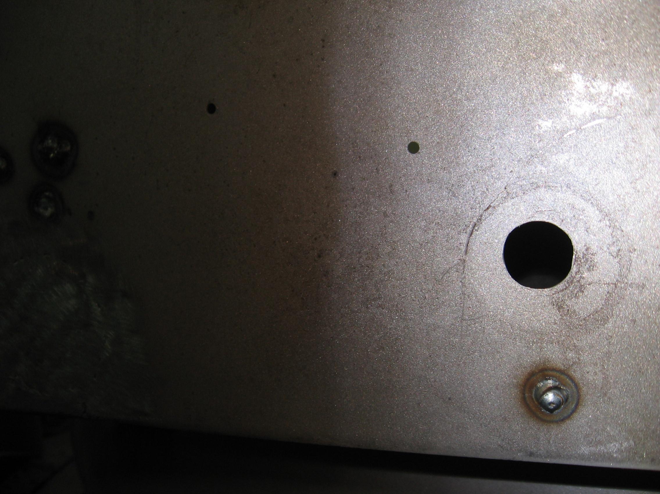

  11. Two of the bigger holes were from a heater that was rigid mounted
    to the firewall by the pipes, that caused stress on the metal and there were cracks to weld also.
    Once heat was in the panel, a few more cracks exposed themselves,
    In retrospect, I probably should have just cut out a bigger area and done one patch,
    but already headed down that trail, I just welded the cracks with the tig.

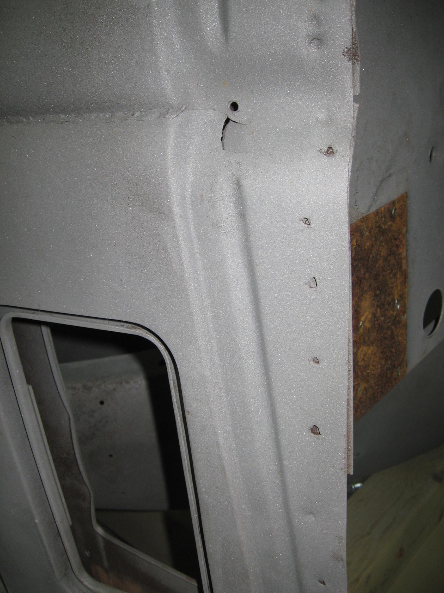

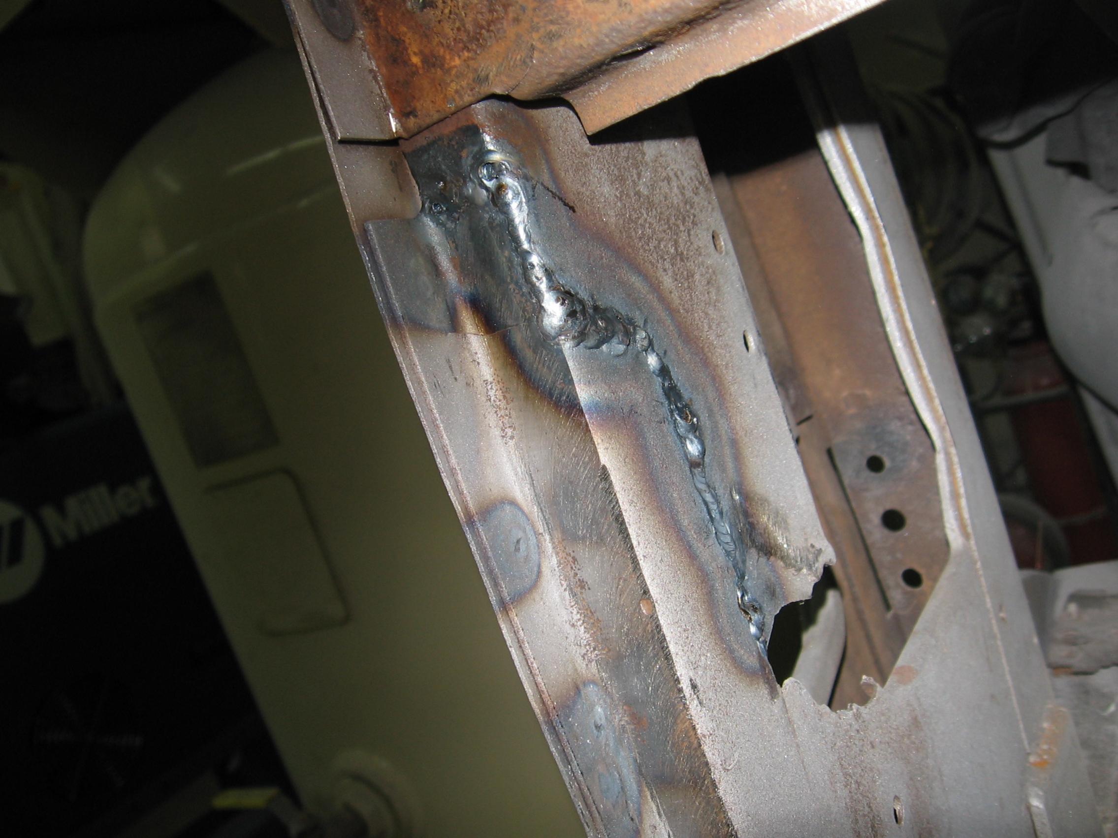

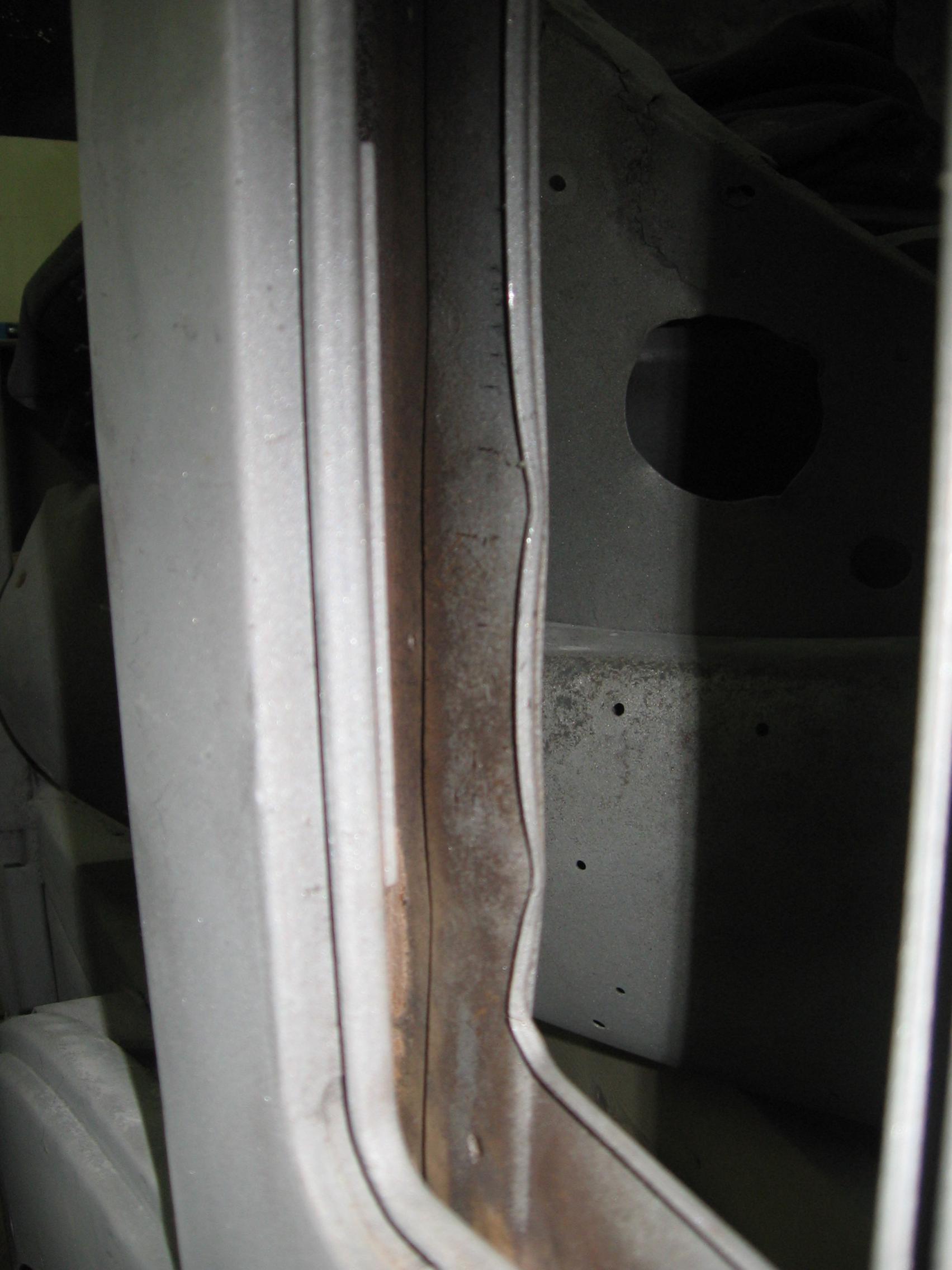

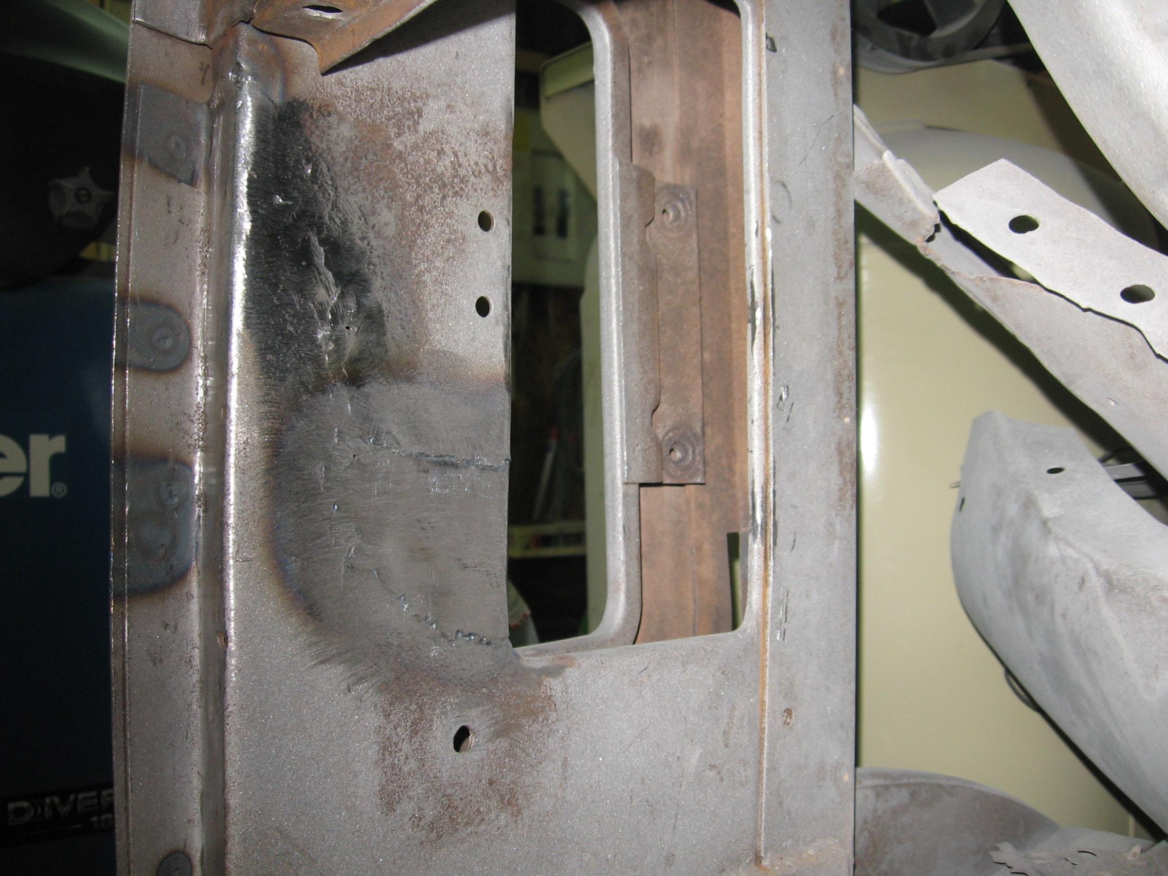

  21. Thanks guys and glad my project is providing inspiration for others.
    Here is a wee update.
    The firewall for all intents can be crossed off my metalwork list.
    I still need to grind and dress the ****on welds on the side brace pieces.
    The torn out metal on the side vent has been repaired also.
    Seems like almost every part of this cab has suffered some major trauma at one time, so the list of repairs is a long one. Bit by bit, it's all forward progress.
    Here's a few before and after pics.
