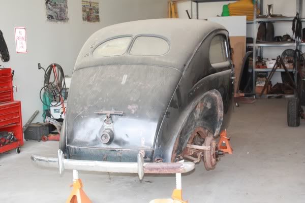

    Here is what I started with
    Blown apart
    The inside

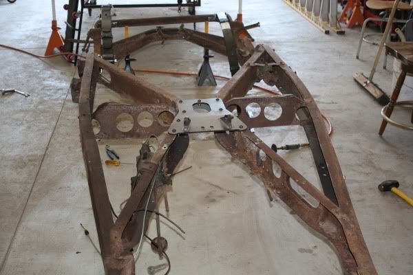

    The frame work begins

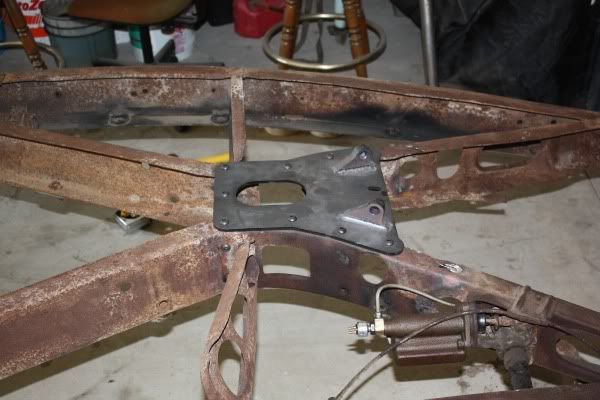

    The new center section is in
    Front axle,mono leaf,shock mounts and shocks installed and the bones are split and on the frame.I still need to adj. the joints on the bones to get them right.

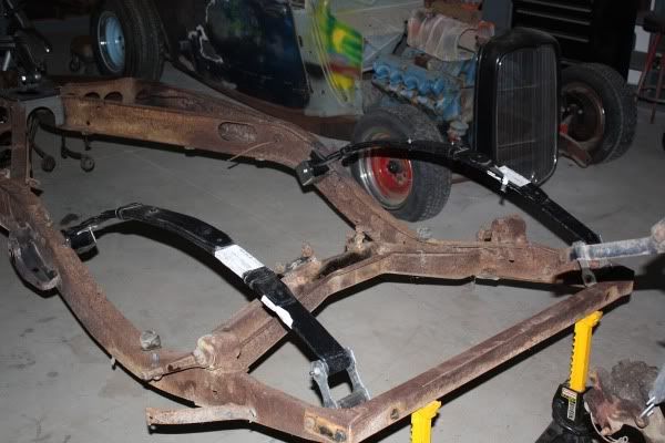

    And the last of the pics for now.....the rear suspension.
    Laying stuff out to get an idea
    And the hangers,shackles and springs are in,

    Hi, where did you get the wishbone split plate from, and are they car or truck tierod ends? I am looking at making a plate for my 40, but if one exists allready...
  8. kelgar50
    Joined: May 29, 2006
    Posts: 180
    kelgar50
    from socal
    The center kit came from Magnum Axle Co. but I can't remember the cost.Really nice kit and easy to use it came with the bungs and tie rods for the bones,top plate,rear plate and the bottom plate and other than welding in the bungs it is all bolt in.
