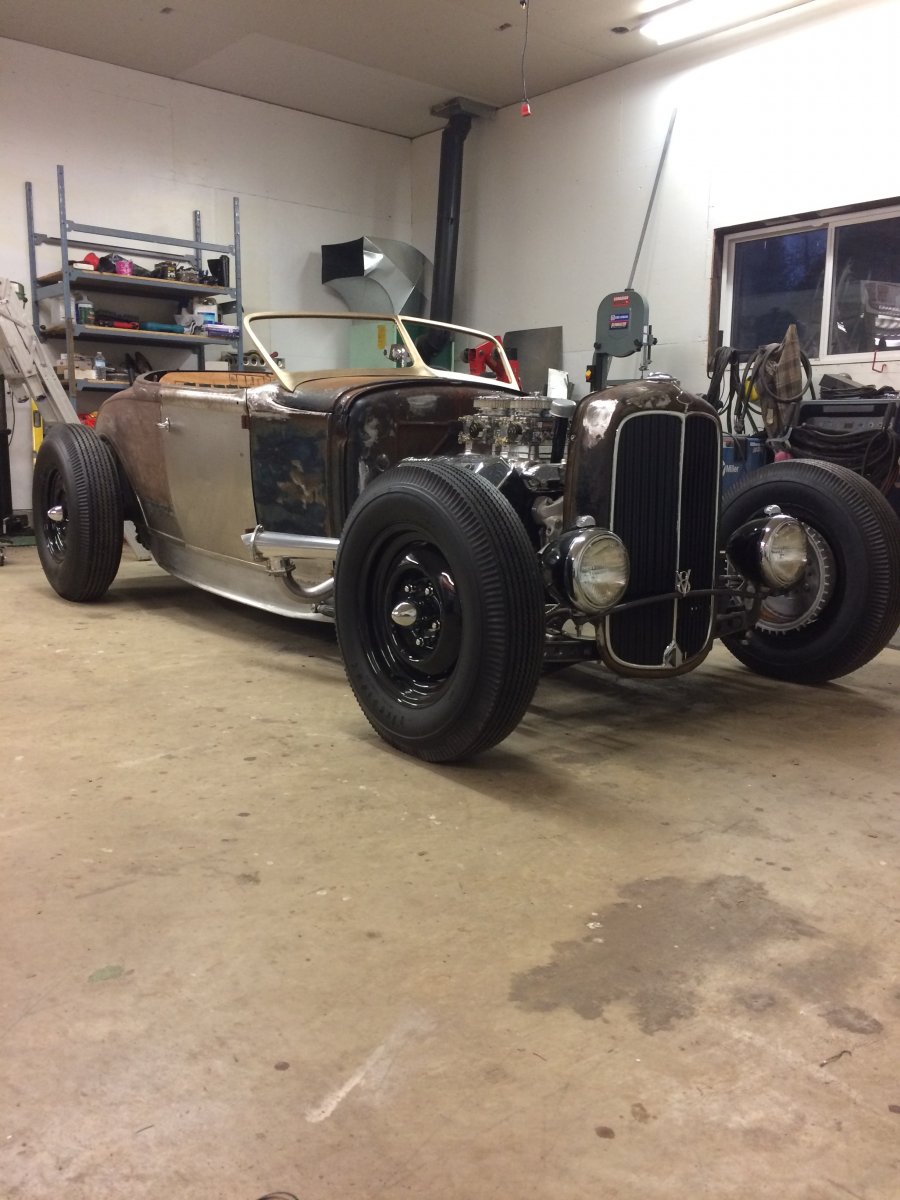

    She gets my heart racing, great stance! :)

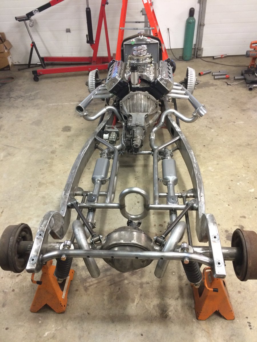

    I see you put a tail-shaft loop at the rear, what happens if the front universal joint breaks, where does the front of the shaft go after it digs into the road, you should have a full loop at front as well.

    I haven't posted in a long time but I have been doing a lot of work on the roadster, I torn the car down to the bare frame, finished all the welding on the frame and wish bones, built an aluminum fuel tank, mounted the fuel filler and some other odds and ends. I also have been restoring the pines winterfront grille insert, I reinstalled It into the patina 32 grille shell for now but I will come out again so the shell can get painted

    well its been a really long time since I posted on here. I went about a year without working on the roadster, got a little burnt out on it and last winter I decided to put a 5 speed in my Acadian and do a few other things so that took up some of my time. this past july I made a decision to get my car running in bare metal for july 2016 for a show we have called deucedays, only happens every 3 years and cars come from all across north America to be there. so this past September I started working on it again. I ordered up a steering box, column, wheel, built a structure under the dash to hang the column and to support the cowl, built a custom seat frame, and now have pulled the body off and I started to build exhaust for the car, its going slow but I am making progress on the car and really hope to drive it into deucedays 2016

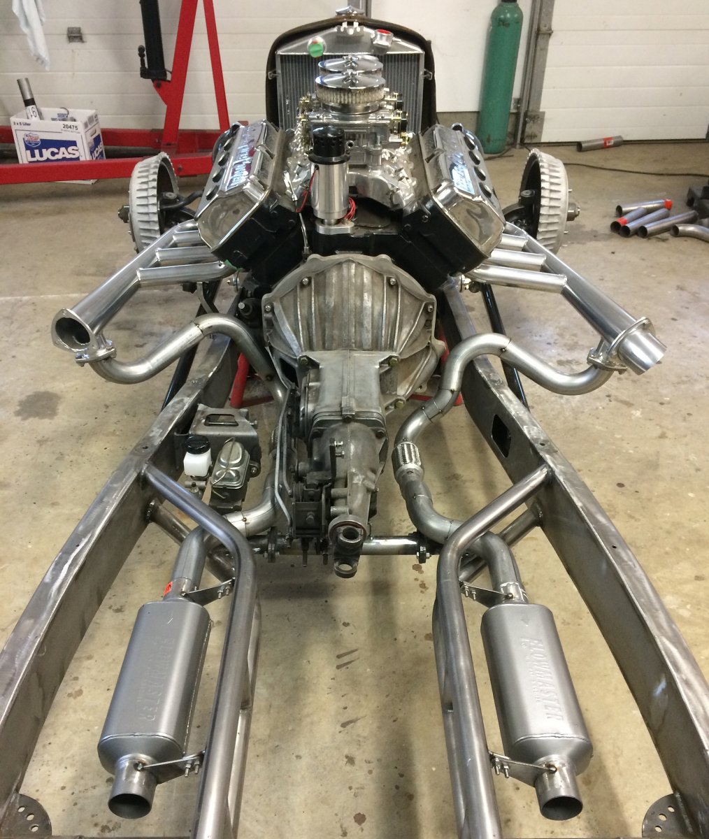

    got a little more done on the exhaust this weekend

    I would be sure to use STEEL bushings in my shifter arm linkage instead of the normal plastic ones with the exhaust that close.
  25. Brand Apart
    Joined: Jan 22, 2011
    Posts: 815
    Brand Apart
    from Roswell GA
    Heat shields could be in order
  26. Blue One
    Joined: Feb 6, 2010
    Posts: 11,520
    Blue One
    from Alberta
    Not steel. Oilite bronze would be the proper choice. Look it up :)
  27. loudbang
    Posts: 40,347
    for sure anything but plastic. :rolleyes:

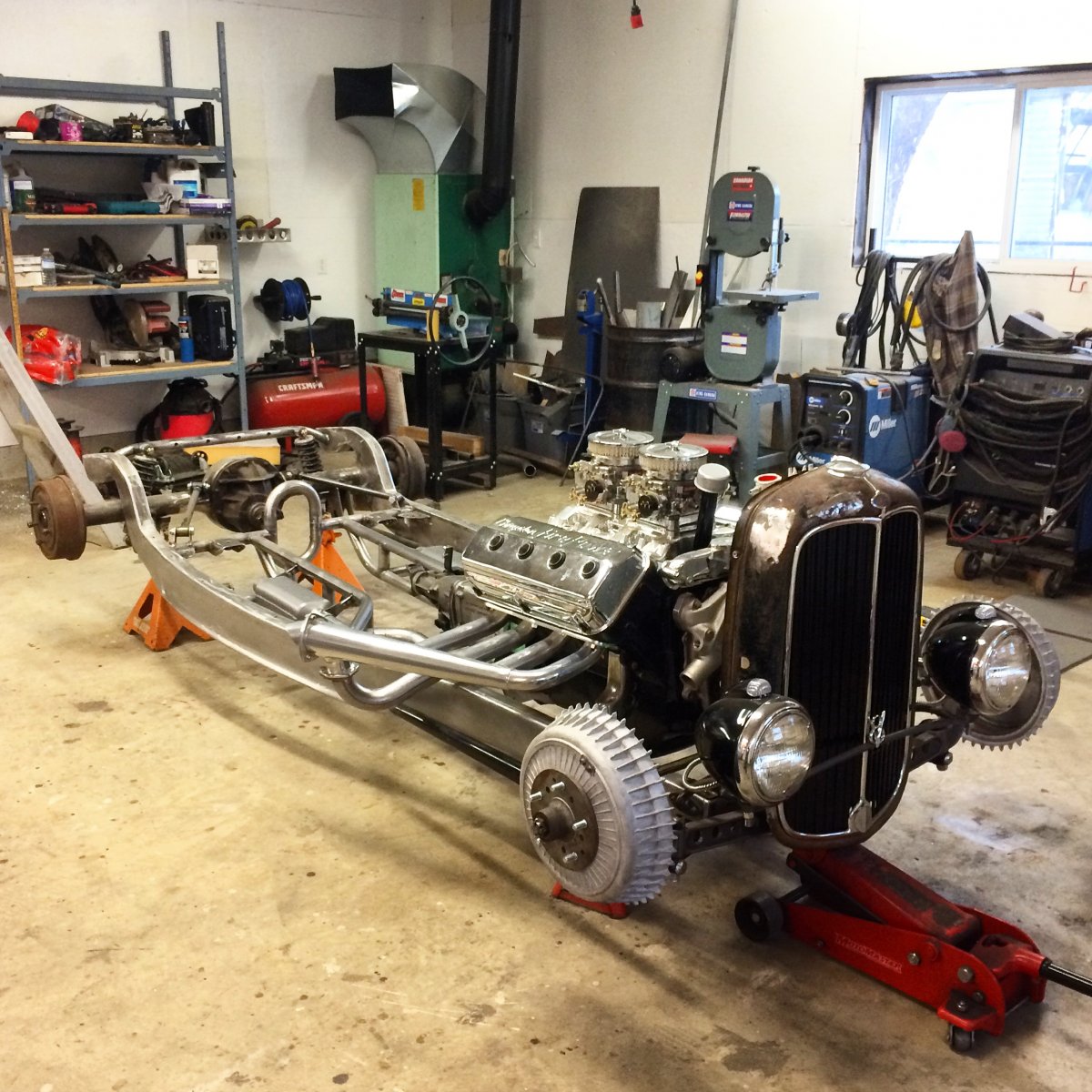

  28. Here our a couple pictures I took of Neil's Roadster frame with the tailpipes & hangers made.
