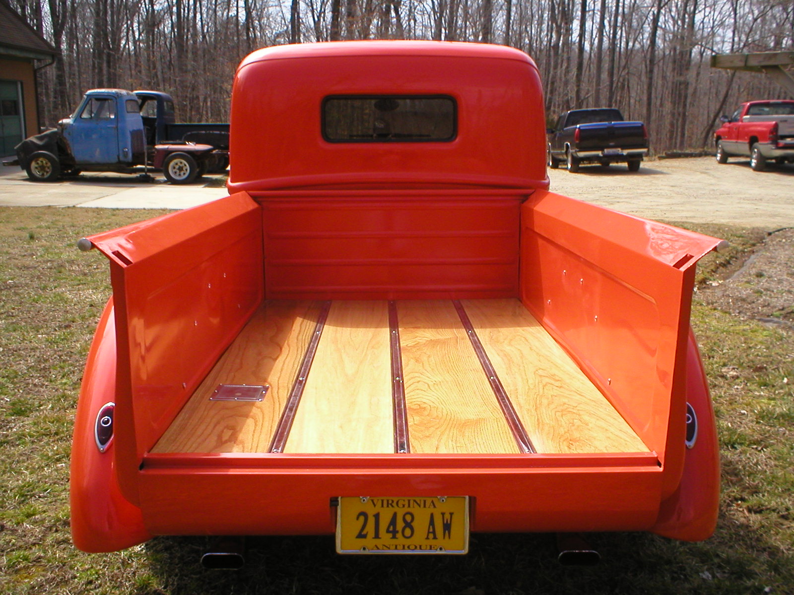

    In so far as the interiors of 40 p-ups - they aren't too hard to do your own interior for as long as you are OK with a more utilitarian style/look. I used brown fiberboard for patterns, bought some thin foam for backing (like headliner material only denser), bought the material to closely match the seat out of the local upholstery/sewing shop, and made and upholstered everything myself - less than $350, including the seat - 3rd seat out of a 94 Chevy suburban - fits in there like it was made for it! I also used the upper console out of the same vehicle - put my AC controls in it, working lights.
    I also did my own bed wood - bought the hardwood from Home depot and already had the strips - cost me, total, less than $200.

    Hey, MJ40's, I am no where in your league when it comes to upholstery! Nice tech article BTW and I will probably use some of your ideas on my present 40 p-up project. I never checked the width of an S10 bench seat to see how it fits in he 40 p-up - the 3rd seat out of the suburbans works well from 92-98 I believe the range is. I also have a 96 Mazda MPV 3rd rear seat that has the correct size going into my project. When I get back on it I'll post a build for it.
    Love them 40 Ford p-ups ....
