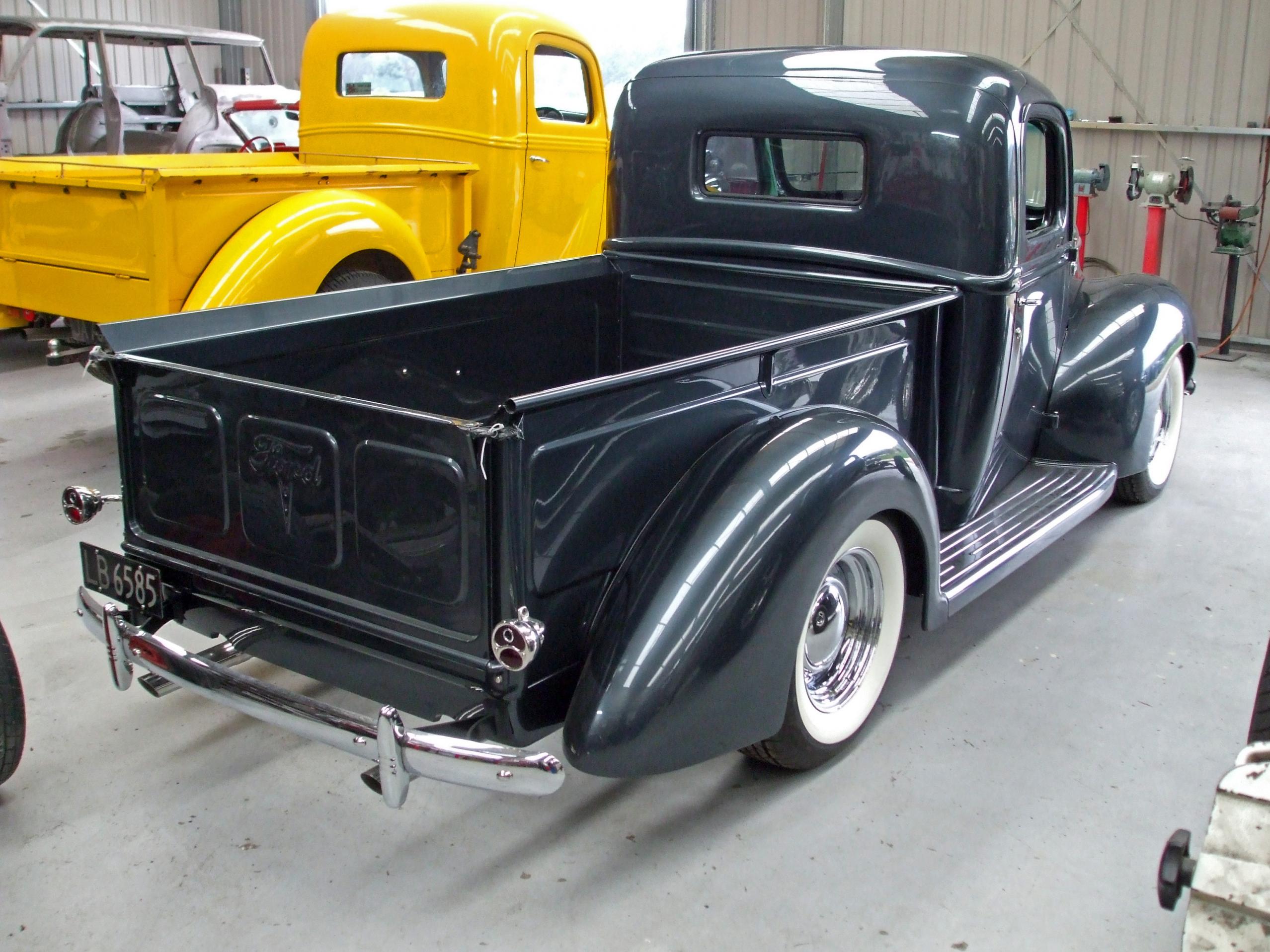

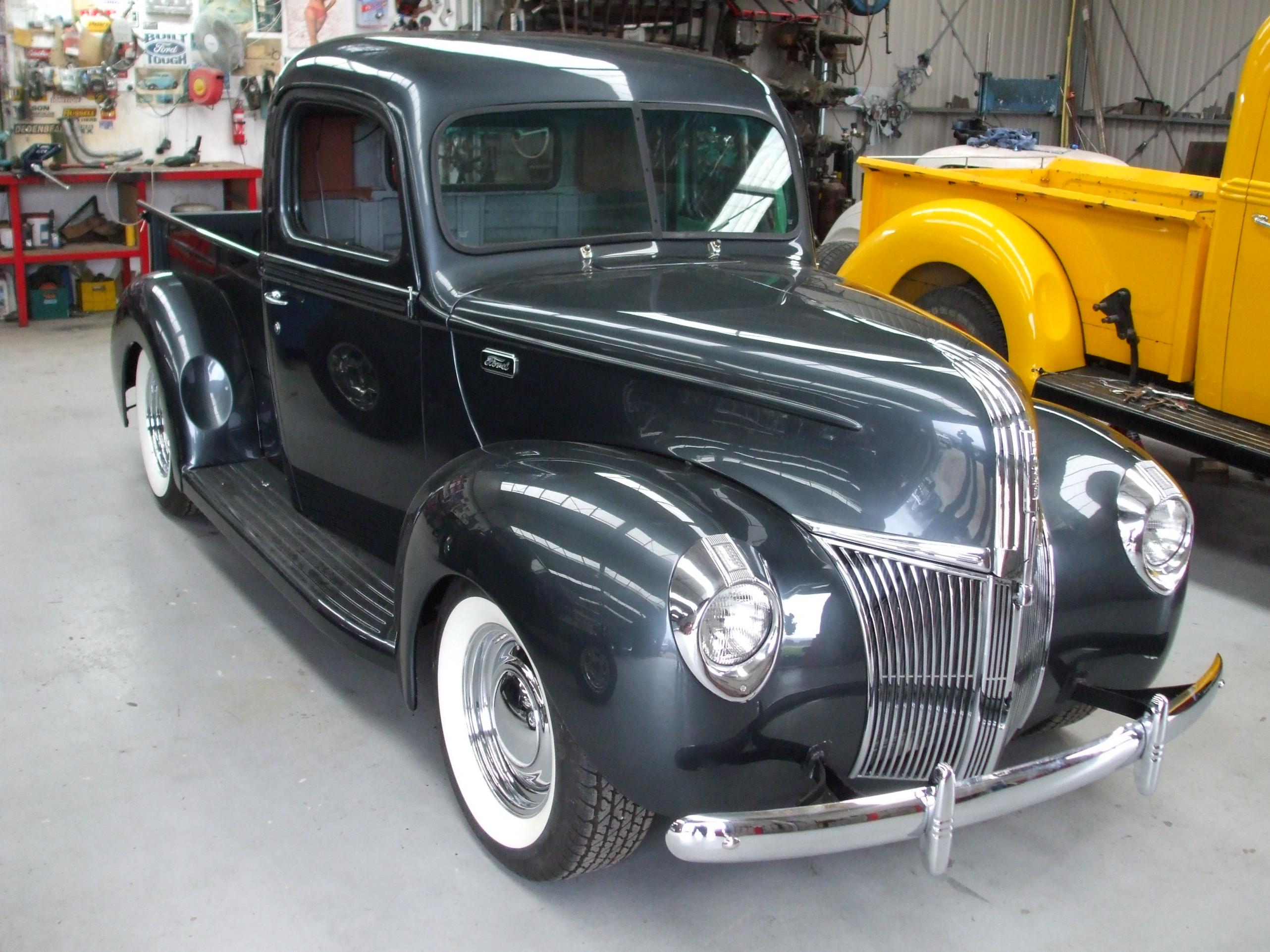

  23. Looking good, in my opinion these are one of the best pickups ford ever built, Its going to be a good looking truck and I really like your choice of engine. Theres just somthing about those nailheads and there vertical rocker covers.
    Photos of a little 41 that we have just finished for a customer, nice plain and simple little truck.
