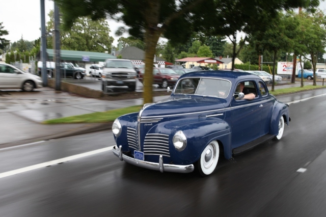

    Love this pic by Chadly. Rolling in the rain.
