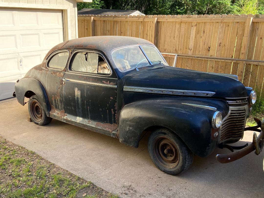

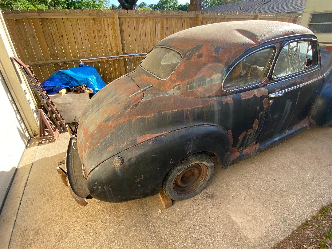

    I recently scored this 1941 Chevy Coupe Special Deluxe. It is 100% complete, 100% stock original and in excellent condition. Although some of the body trim is not shown, it is all there. As you can see in the pics, I have more dents to deal with than rust. This car is remarkably solid for its age.
    My plans are to install a donor sub frame with P/S & power disc brakes, Ford 8.8” disc brake rear end, A/C, and tilt steering. I'm building this car solely to cruise the highways and country roads. My objectives are a good ride, dependability and comfort.
    I would love to hear you guys’ thoughts, suggestions, do’s, don’ts and so on. I will post up more pics and continue as I progress along.

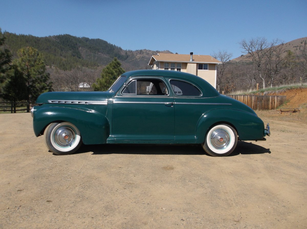

    glad to see you got it home . you can change your mind a thousand times now . but once you cut the frame theres no turning ,so think of all possible outcomes first . I CUT IT 3 TIMES AND ITS STILL TO SHORT , all stock minus 2 coils . stock height tires DSCF5421.JPG
