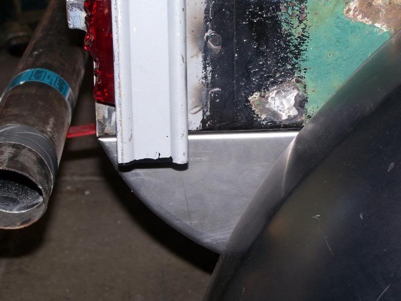

    102_5950.jpg 102_5951.jpg I made those rear pieces this afternoon, hammer and dolly on these around the edge and broke the tops over angle iron again. I think it finishes off the back side neatly.
    the soft edge gives it more a finished look, at least it does for me...lol

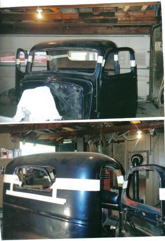

    truckchop.jpg truckchop001.jpg truckchop002.jpg truckchop003.jpg I was asked about the chop on the truck and let me say first and formost this was my one and only chop and I had no idea what I was doing. Those of you that know me will get a kick out of one of these pictures. Yes that is me with hair, a mullet no less, and yes it was something other than gray...lol
    I took 4 inches out of the roof and 2 through and under the rear window. Here's the tape lay out, these are from around 1994 I think.
    Here's that funny picture...lol Hey lets hack the roof off, why not.
    At this point I wasn't to sure if this was such a good move, I was scratching my head to figure out how to make this thing fit back together. I had no guidence so I just chopped things apart and tried to put it back together.
    Here looking at the weld lines you can see what all I did, probably could of got away with half the cuts looking at it now. It was back together and I was happy it made there. The chop did stand up to the garage cave in pretty well to my amazement.

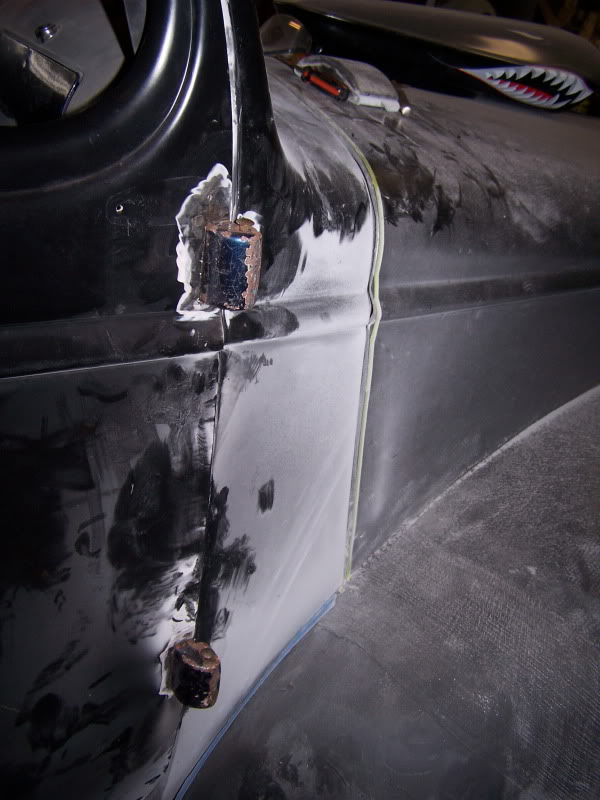

    100_6091.jpg 100_6090.jpg I've let the ol truck fall on the way side while working on the new car (henry j).
    But...... I went and did it, I committed un-suicide !
    I had enough screwing around with these suicide doors and all their problems. I cut out the smooth I gave it 17 years ago and put the lumps back on and the doors open and close great. I still need to move the strikers n latches back on the back side but did I say the doors work great now....ha ha
    I still can't find the upper hinge for the drivers side so I only did the one door so far.
