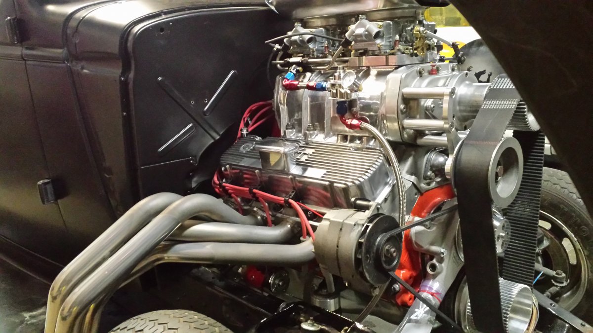

    Got the trans back and started the process all over again with the correct A-N fittings this time. Had my helper out in the garage and ask him if the new seats were comfortable, had my answer 5 minutes later..lol
    He did help me to get the combo back in though.

    So hey, let's keep plugging away at this thing. Time to run fuel lines (twice)...lol First was mounted to firewall then I thought that's not NHRA legal so let's make it legal just in case I want to take a trip.
    After trying the regulator in a hundred locations I decided on a bracket off the blower itself . In this spot valve cover access is good as well as the fuel line not laying on anything hot. 20160203_154729.jpg

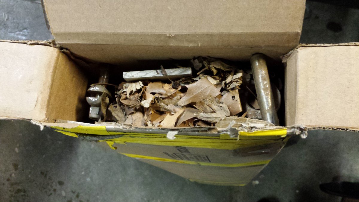

    Other than that I picked up some wheelie bars for the Henry J that came packed with freaking leaves. I've seen some weird packing material but never leaves...lol 20160210_151214.jpg 20160210_152436.jpg

    Got to laughing about the leaves and forgot the picture of the seats. 20160108_180605.jpg 20160108_180605.jpg

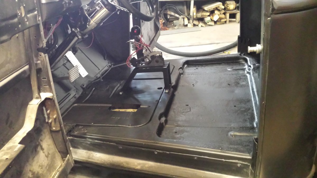

    Floor is painted and the seats are in for good, im feeling good and 20160604_133737.jpg 20160605_152915.jpg moving right along.
