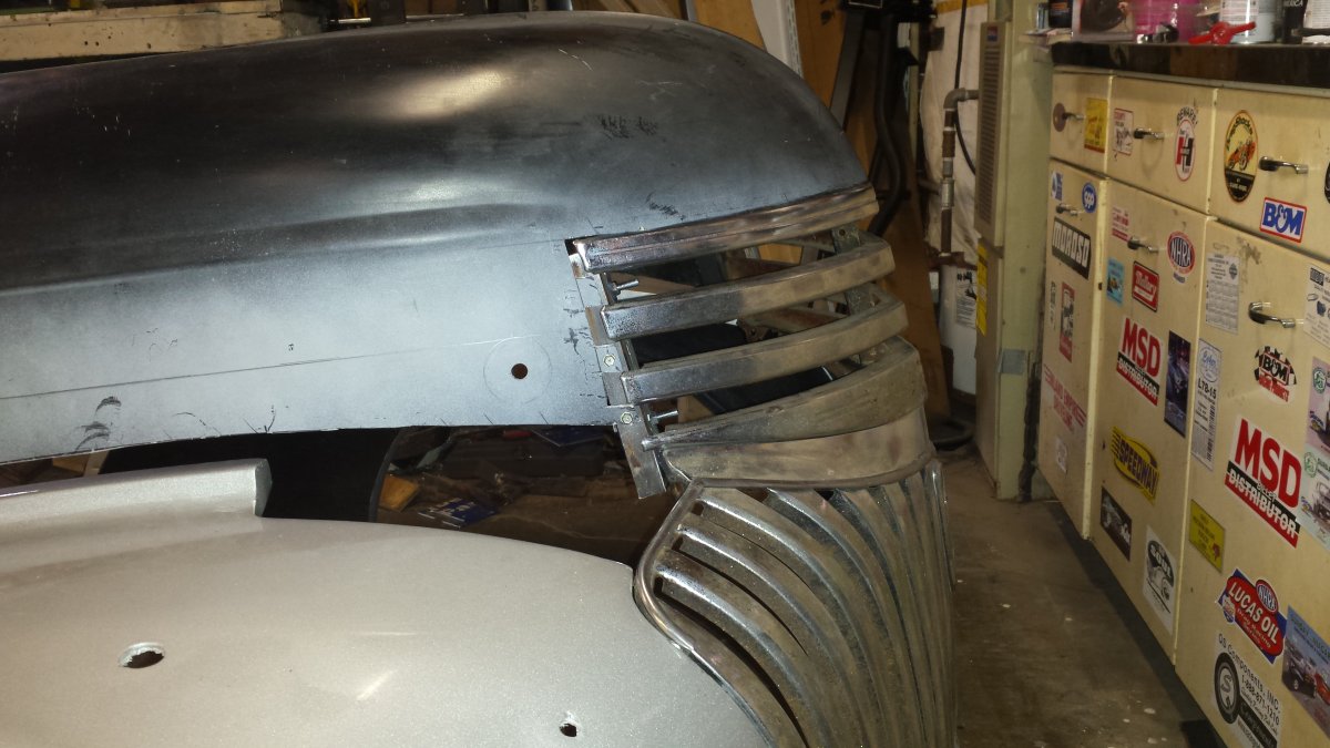

    20160812_141535_zpsossjlqpn.jpg 20160812_142027_zpskktphu5z.jpg 20160813_114850_zpsm8hawsir.jpg Well I started the process of installing the new fenders, no easy task when there are zero reference points to go by. I got creative and made this height jig up so at least the fenders and hood would be the same height as before.
    With that done I put the new fenders with grill and chin bolted together in place for a trial fit, fenders flush on top of running boards.
    Fenders measured to low according to my jig, by about a 1/2 inch, chin was in same spot though. I raised the fenders but that brought fenders off running boards.

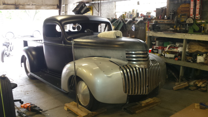

    20160812_171652_zpsxfbdbdu7.jpg 20160813_185318_zpsechelowg.jpg 20160813_150957_zpsa1dooa9m.jpg 20160813_151053_zpseeqeaks3.jpg 20160813_162004_zpsaiyc2bep.jpg 20160813_162853_zpsfcnustsy.jpg I split the difference at a 1/4 till I get this hood cut out of the one piece tilt, marked out and ready to cut. It's hot and humid with cutting fibergl***...yummy
    first trial fit, needs some off the back of the hood, the other front clip must have been forward all along
    took 3/4's off the back and sneaking up on it
    taking a break before t******* a little more off the back

    Sure was, sweat was puddling in my safety gl***es. I figured out that when they did the mold for my old front, they went right over the grill, that's why it's not the same shape as these new fenders.
    Trimmed more and locked this down, nice transition from grill to hood, next step mat/resin the gaps. 20160814_115625.jpg 20160814_164417.jpg 20160814_164347.jpg
