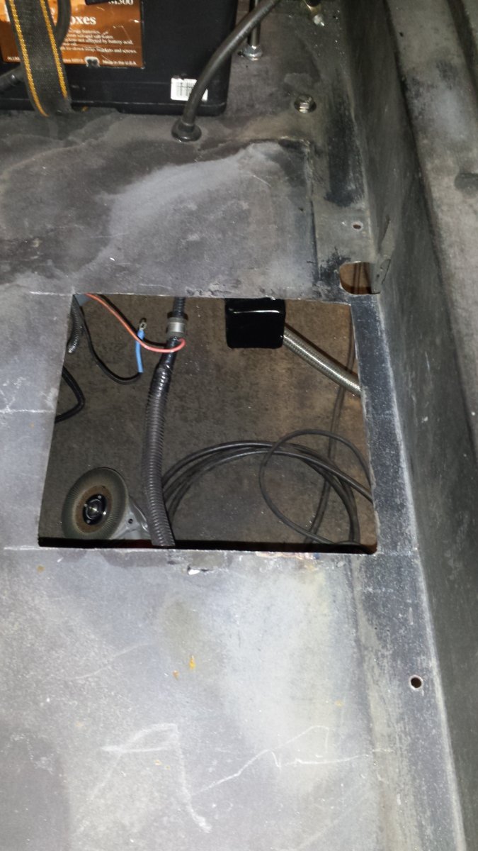

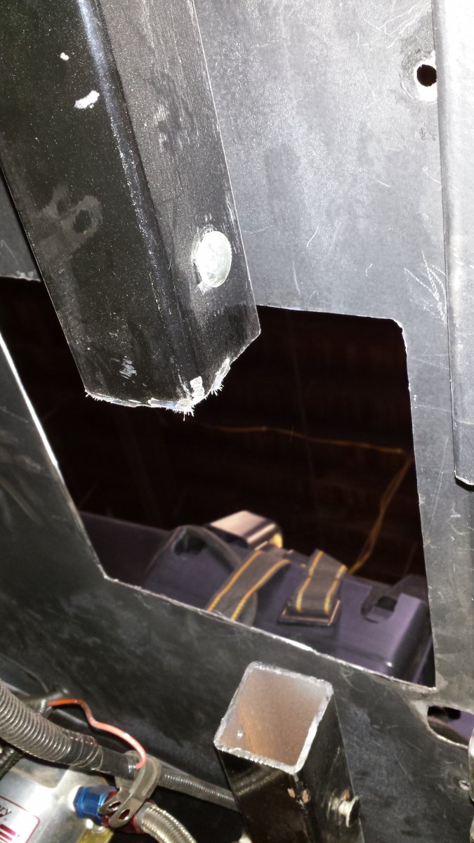

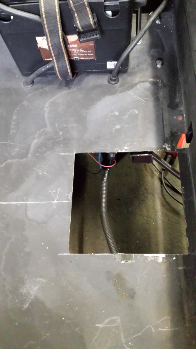

    I took out the weeping plastic flat bottom fuel cell and replaced it with an aluminum cell with a sump and bigger AN fittings. As always these projects turn into more work than expected like cutting the bed floor, cutting and dropping rear frame crossmember, cutting rear bed cross seal for AN fitting clearanc, making new hold down straps and making new lines up. 20170215_141937.jpg 20170215_142302.jpg 20170219_172335.jpg 20170228_170941.jpg 20170310_163515.jpg 20170418_154647.jpg

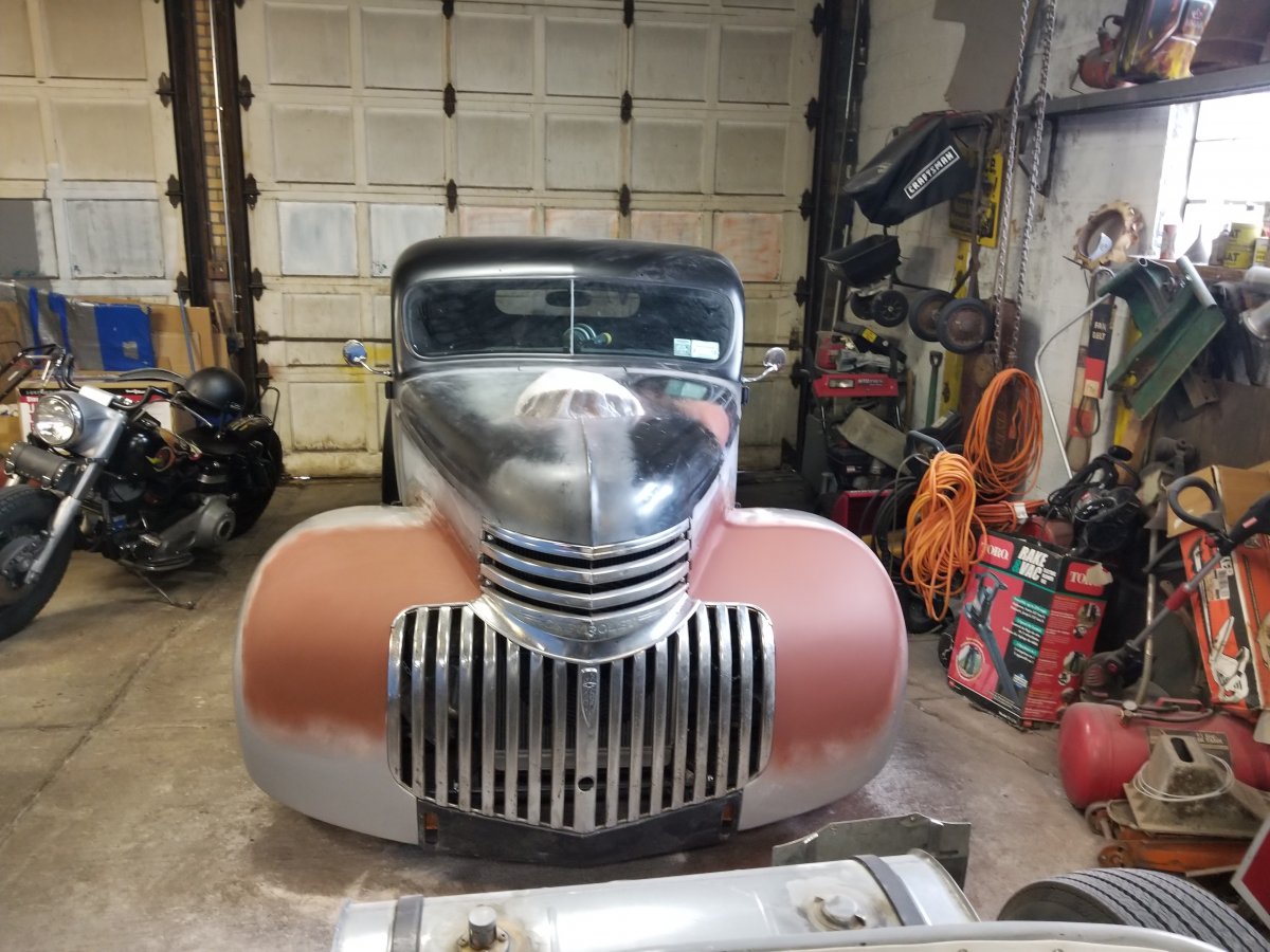

    20160814_164347_zpsm3kgnyba.jpg 20170919_135417.jpg FB_IMG_1507745769135.jpg FB_IMG_1507745779709.jpg FB_IMG_1507745795600.jpg FB_IMG_1507745822516.jpg Smoothing the fenders of the headlight bucket indentations, coming up with a compound curve backer was a bit of a challenge.

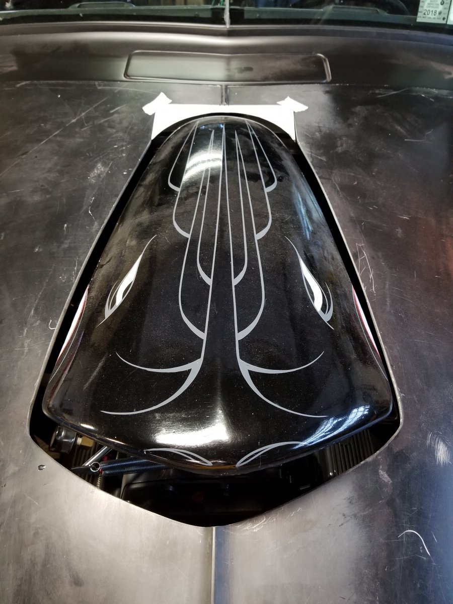

    Cut open the surfer scoop and reformed that too to hold two 6x3 filters and sit just right out of the hood. FB_IMG_1507746487427.jpg FB_IMG_1507746496236.jpg FB_IMG_1507746503367.jpg FB_IMG_1507746509030.jpg FB_IMG_1507746516164.jpg FB_IMG_1507746522907.jpg FB_IMG_1507746533492.jpg FB_IMG_1507746538719.jpg FB_IMG_1507746560346.jpg

    looks good, getting good with the gl***,,,lol

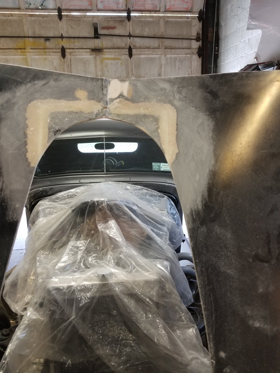

    One more little section to make, filling in part of the hole that I cut for the other scoops. 20171010_180042.jpg 20171010_180113.jpg

    Gl***ed in and ready for filler, oh the joy of body work..lol 20171013_171804.jpg

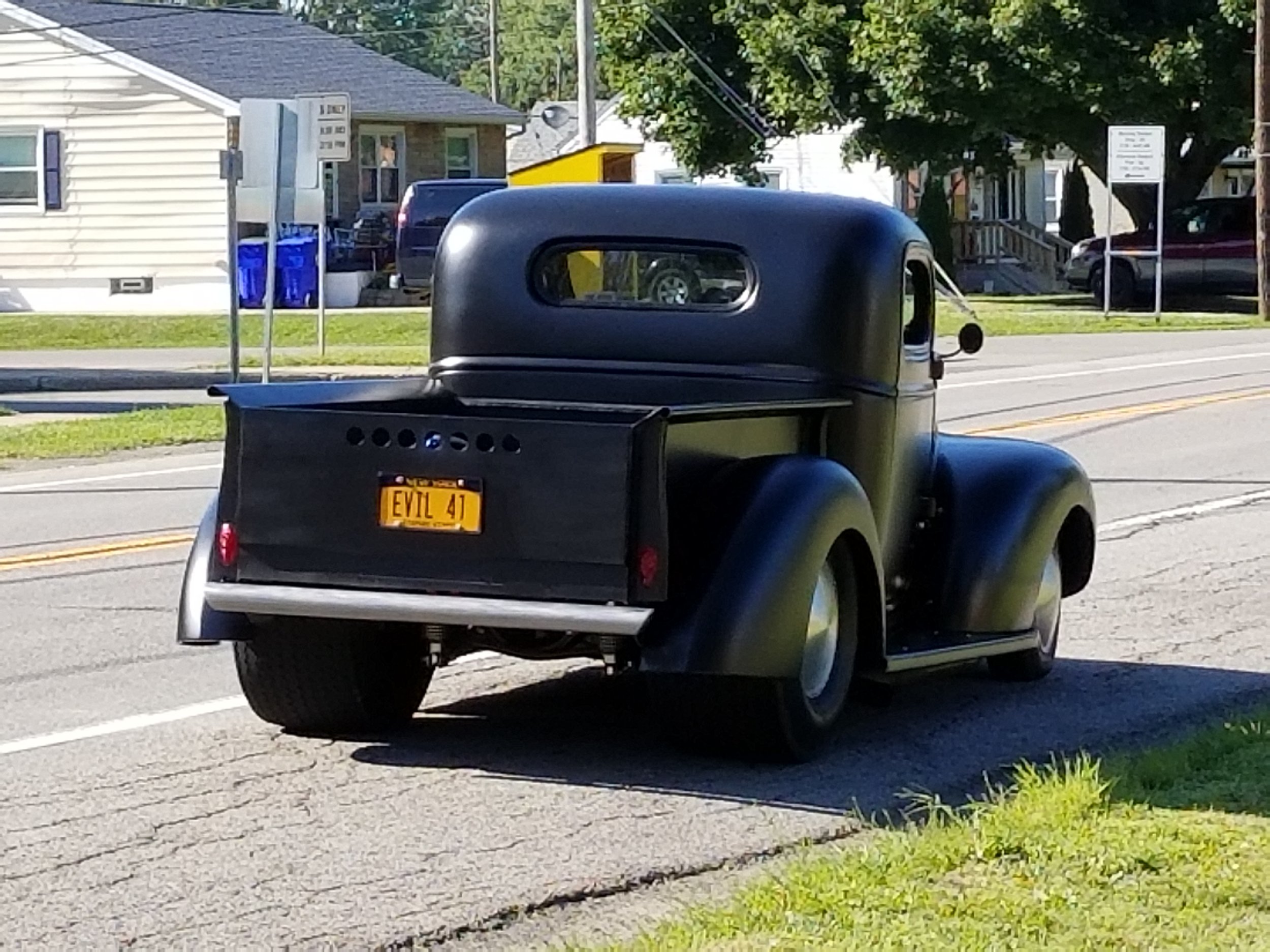

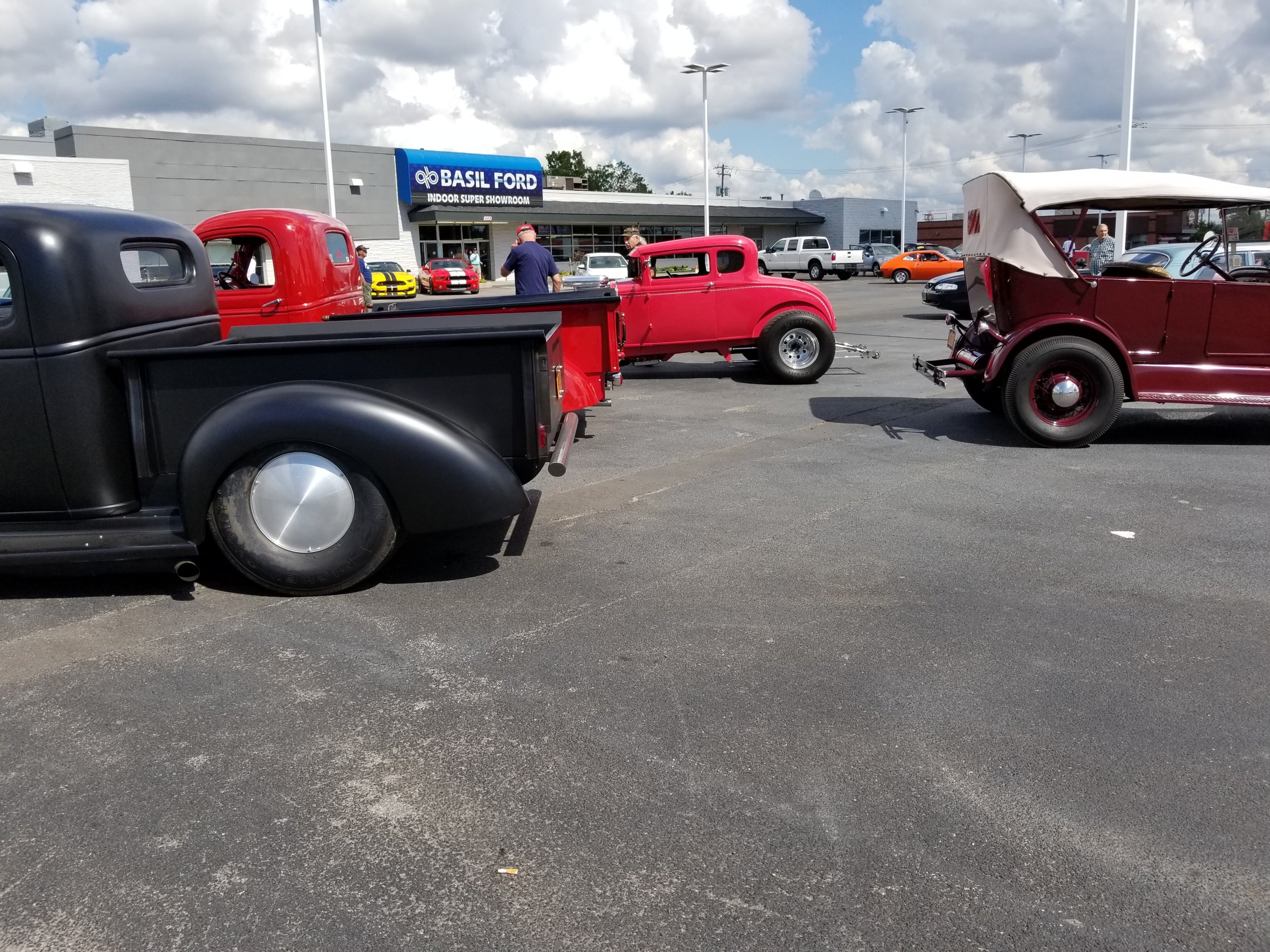

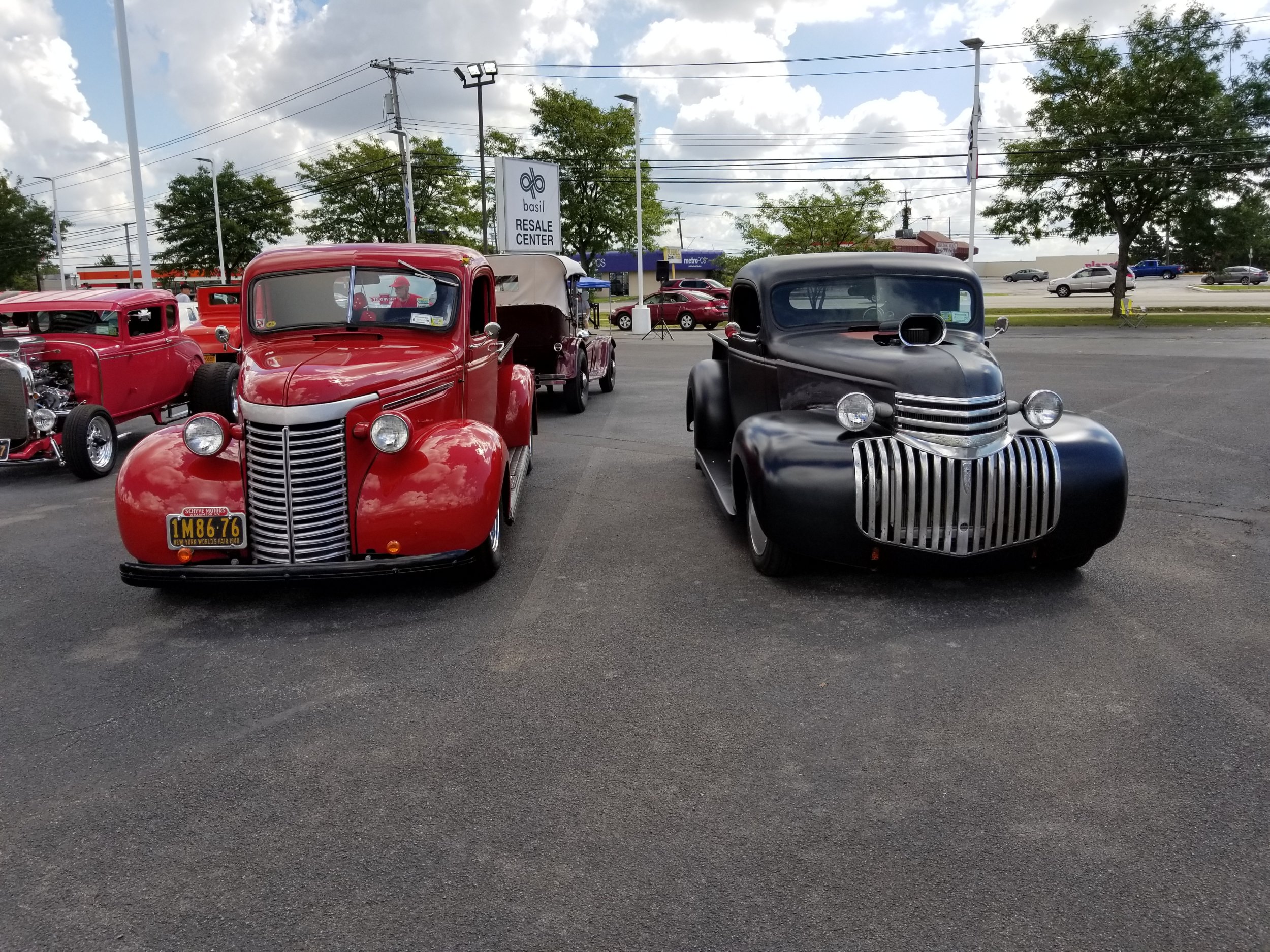

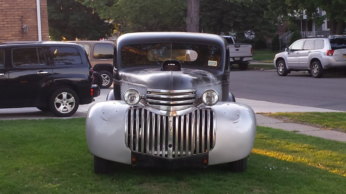

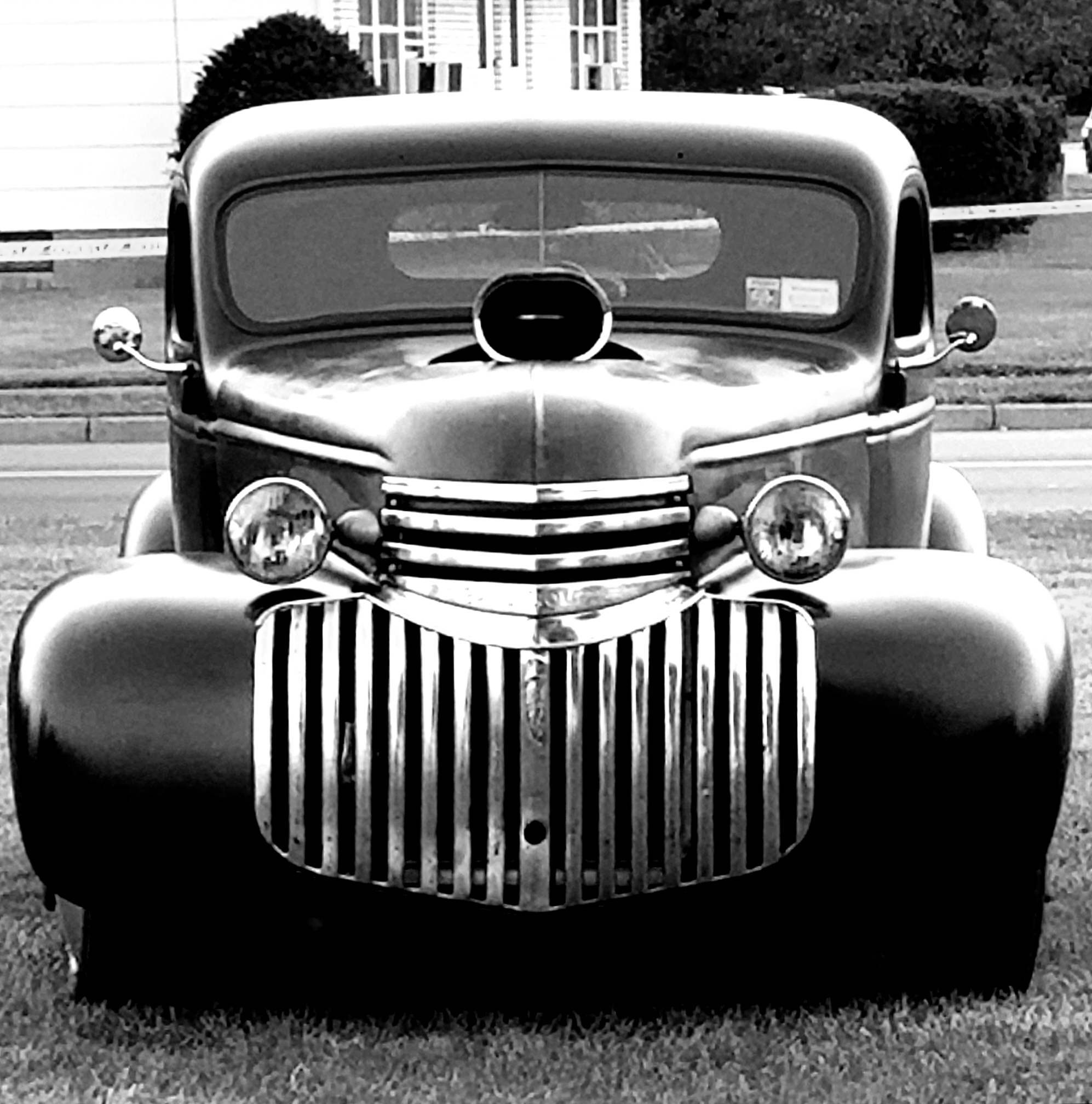

    Since we have this off topic side of things I figure I might update this forgotten thread.
    I never did do the hidden headlights but kept them up top on the 1940 headlight stands.
    It was running pretty good so I just drove it without any major changes for a couple yrs.
    I found a 40 to compare notes with at one show, I've altered everything on this truck except the cowl.

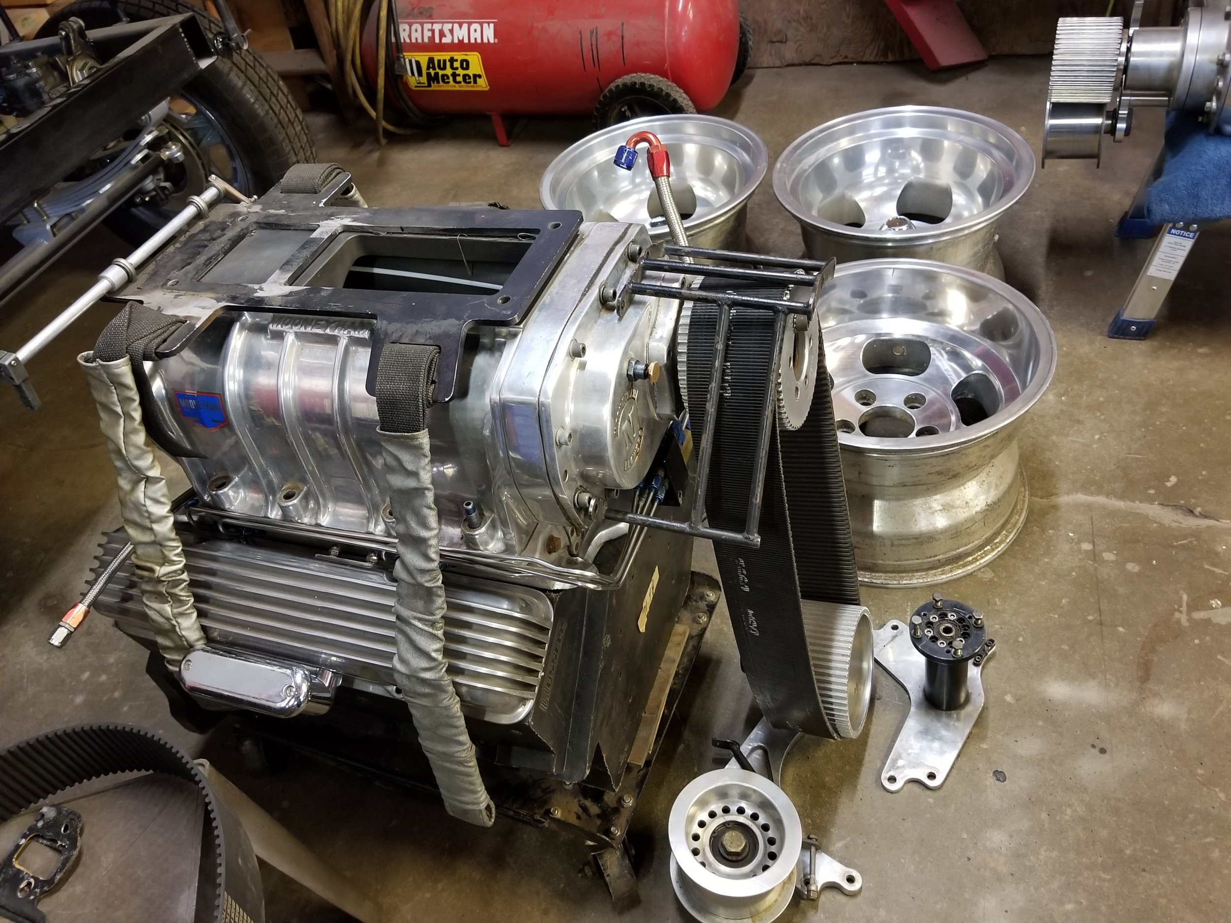

    In 2019 I decided to fix an oil leak at the front China wall, it was small and at first I thought it was coming from the blower.
    20190619_150705.jpg 20190619_151511.jpg 20190619_151658.jpg 20190619_154225.jpg
    Gasket looked like it was leaking and there was some fuel in the pockets of the intake.

    It was about this time that I became my own worst enemy on only fixing a small oil leak.
    If you remember back I was originally going to do a 496 so this 6-71 on the 540 always kind of bugged me as being to small and inefficient. So I decided to get an 8-71 and preferably a vintage Mooneyham.
    I find one on marketplace and bought it, but what showed up wasn't what it was.
    Front discharge delta and was actually a 6-71, the seller honestly didn't know and issued a refund.
