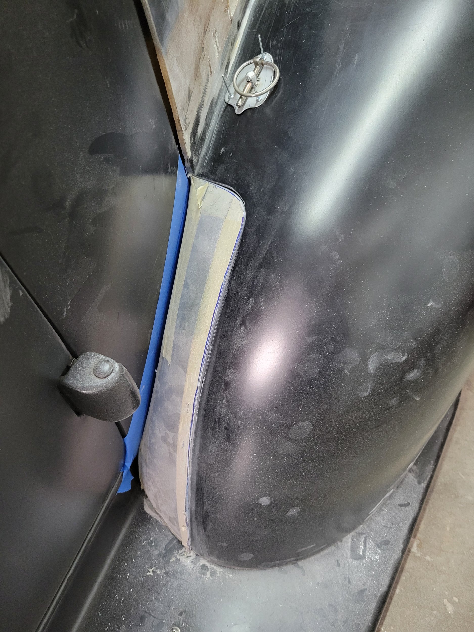

  2. So I ended up using a hood pin on the inside roll of the fender so it's unseen from the side.
    It stuck up kinda tall and would've needed a slot hole in the fender to work with the arc of the tilt.
    So I trimmed the head off of it a bit
    Then I sketched out a design for the plate that the safety pin rides on
    But I was unsure of the orientation I wanted

  3. Next up was getting those fender sections I cut off back in 2016 to mount to the cowl, as with any fiberglass parts when they lay loose they distort shape.
    At first I was going to form a lip on them for the fender to ride on during the tilt but in the end I just made a nice clearance gap between the two pieces. I also made a couple tabs off the running board to hold the fender in place once it's closed.
    I'm hoping that a few heat cycles will get the hood and the other parts back into a tighter fit to the cowl. I'm also hoping that by adding these pieces back it won't be so damn hot inside the cab.

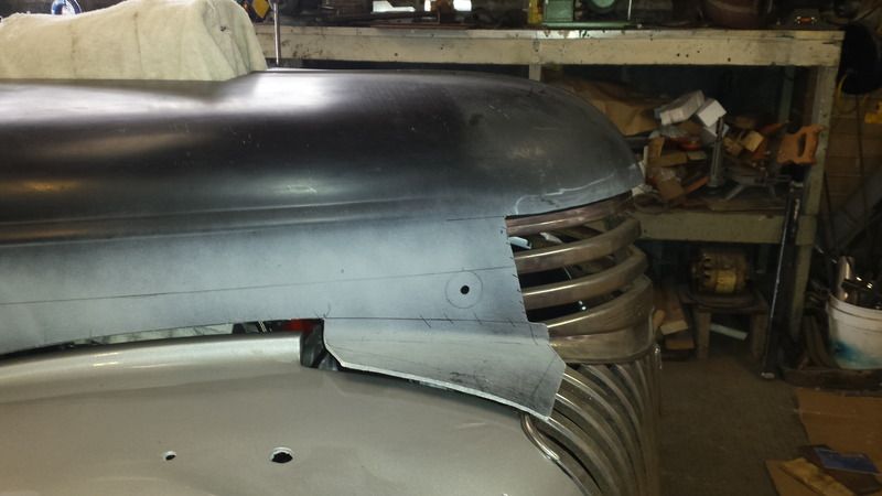

  4. The front hood was so out of shape to fit the fenders, which were stock dimensions, I had to cut pieces free then cut them up then try and glass them into some kind of blended shape. Notice how the hood sits over the top of the grill.
    This is how stock parts fit with grill on the outside
    I gave it a guess to where the grill was supposed to go, since there's no reference points, but kept sliding the hood back to get a better fit on the nose and ended up with this hack looking job.
    Since I didn't want to narrow the nose I decided to buildup the back side of the hood so the grill could connect to that like stock then figure out the outside fit somehow.
    I then carved out a spot for each grill bar to nestle down into

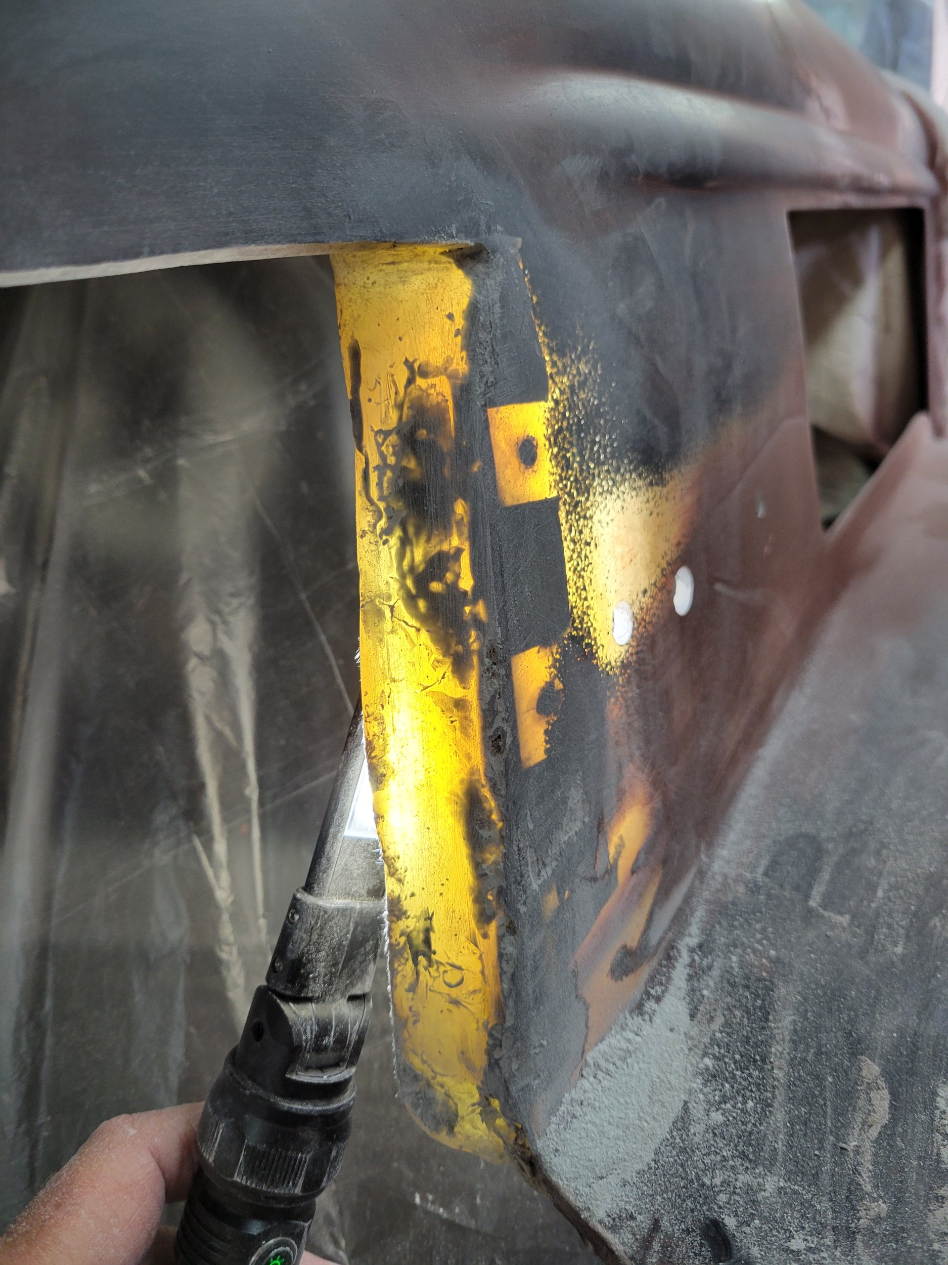

  6. Sand, sand and when you think your done sand some more

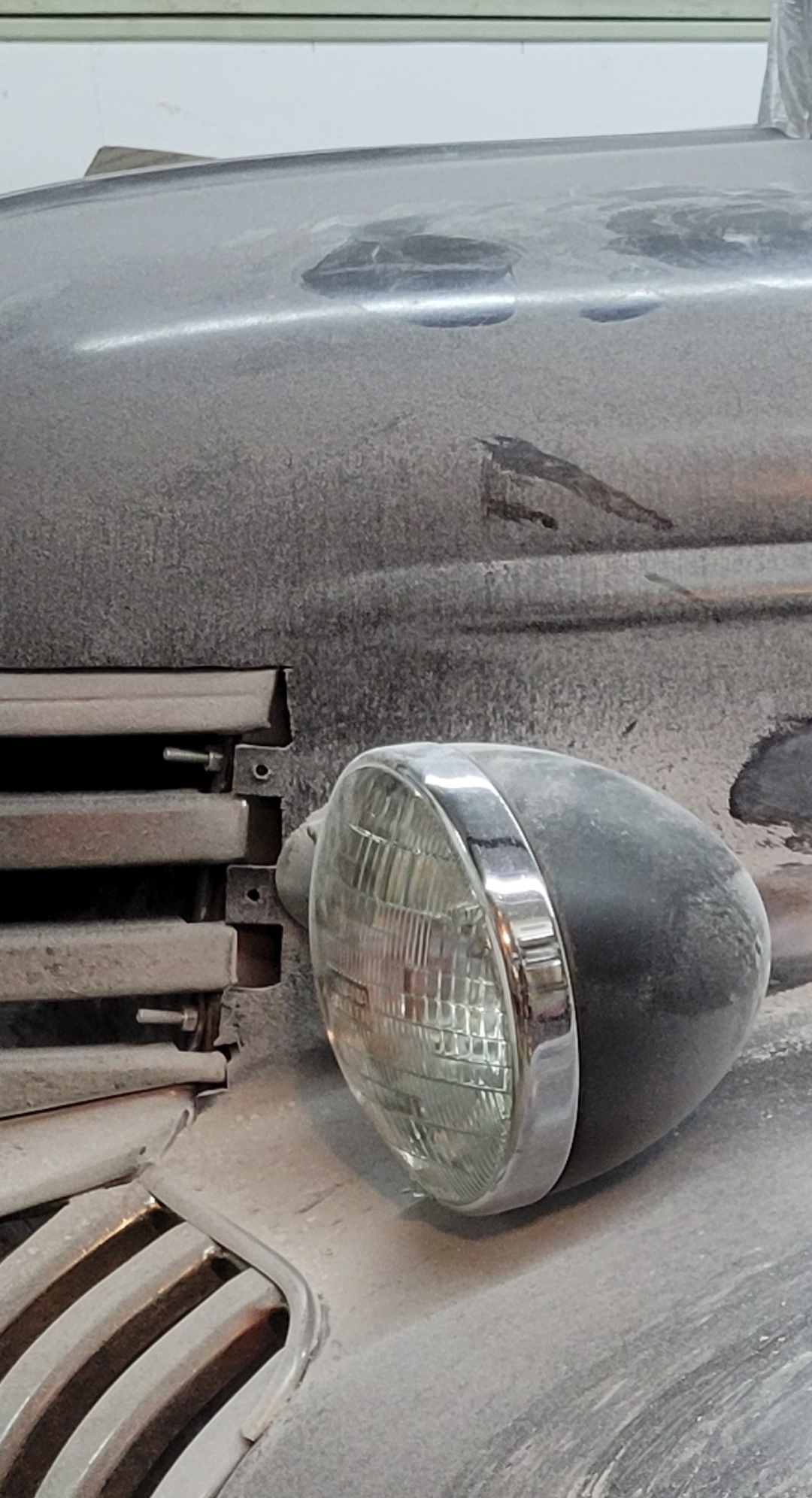

  8. I got the headlights back on, starting to look like something now
    I'm liking the new hood windows too

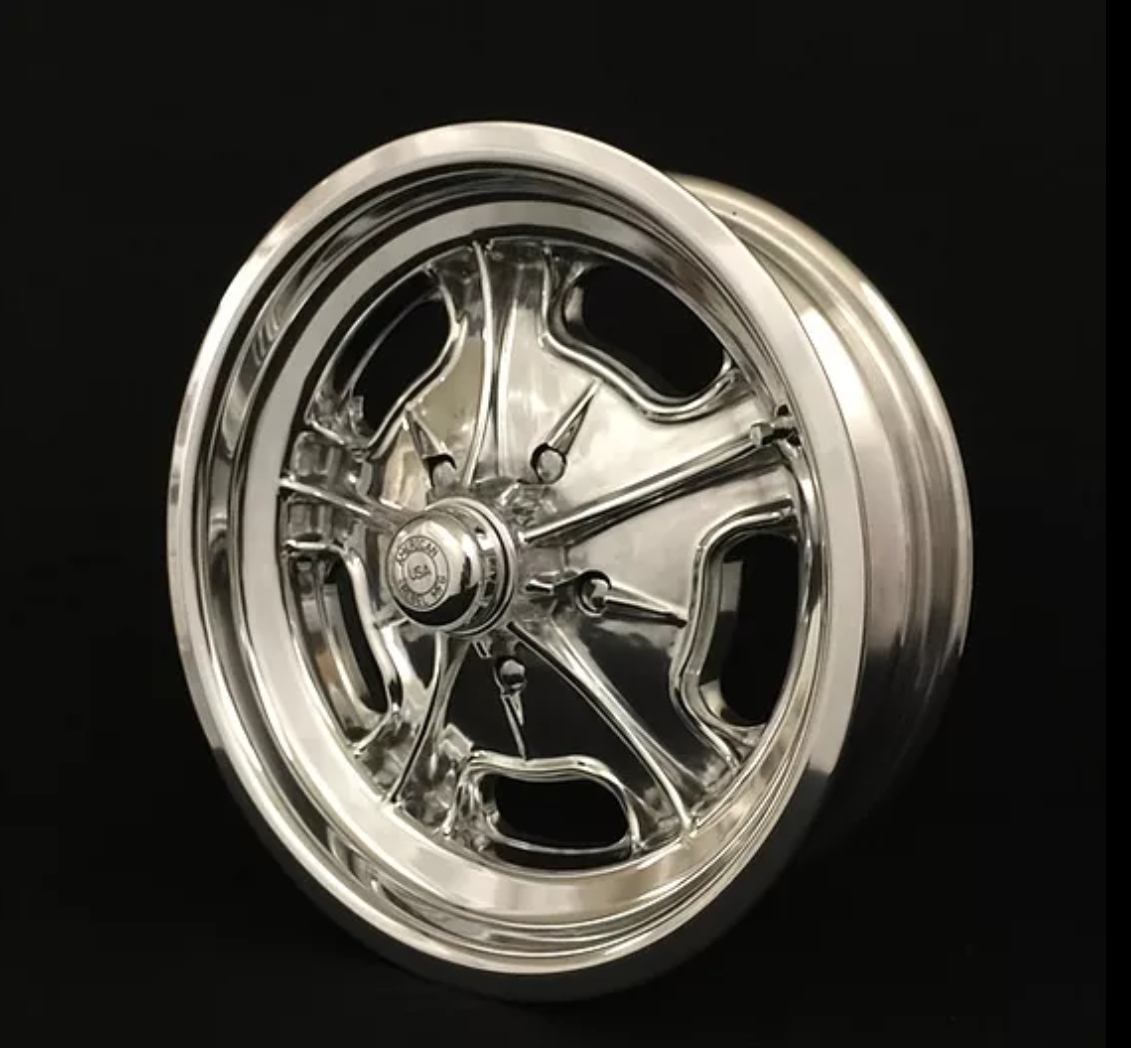

  10. I didn't get everything done on the list, but got a lot done in a years time.
    I still need to paint the door panels, figure out the side windows and decide on a front rim to match the new rear rims.
    I've pretty much narrowed it down to these two American Rebel's, leaning towards the starburst

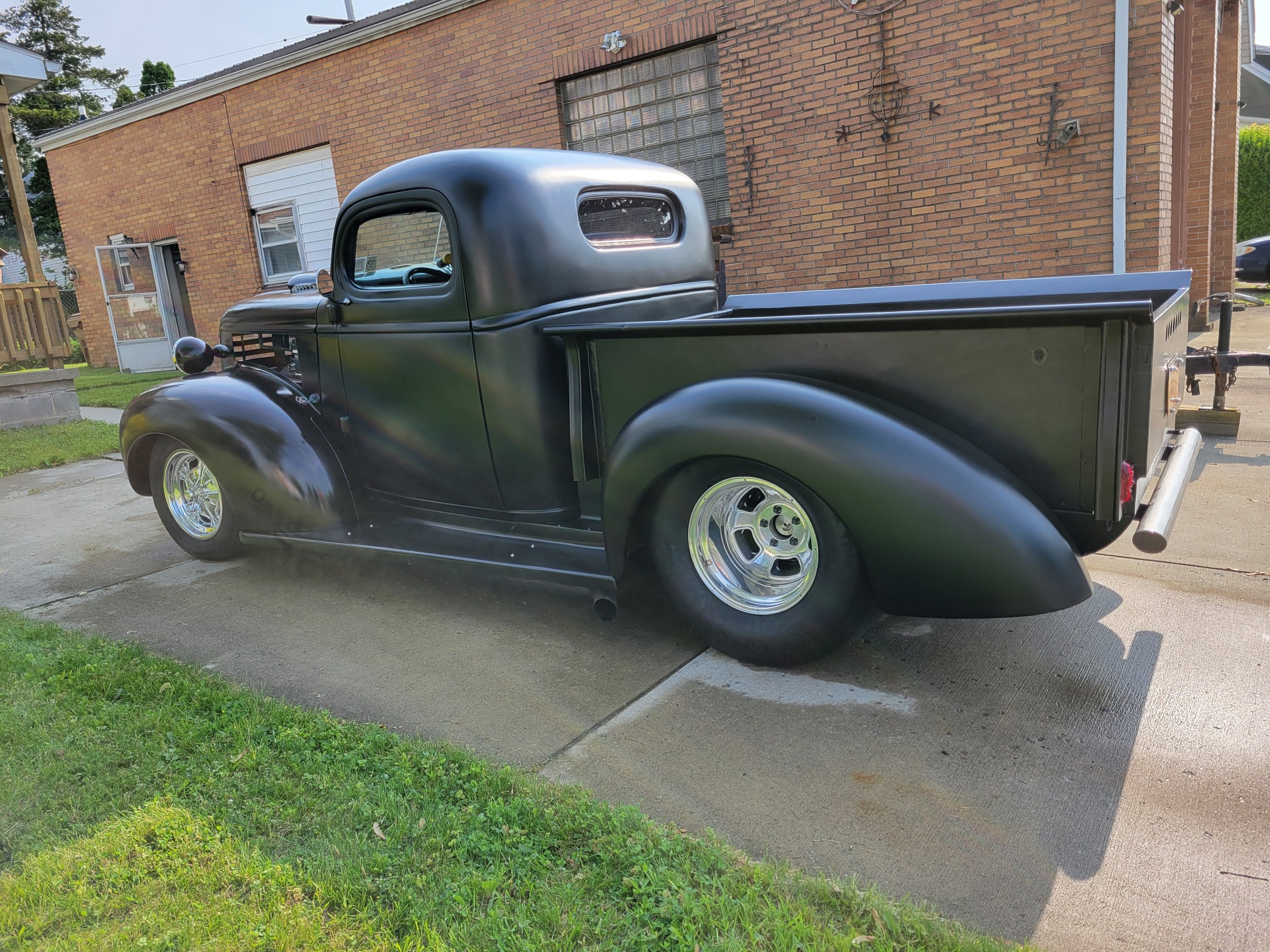

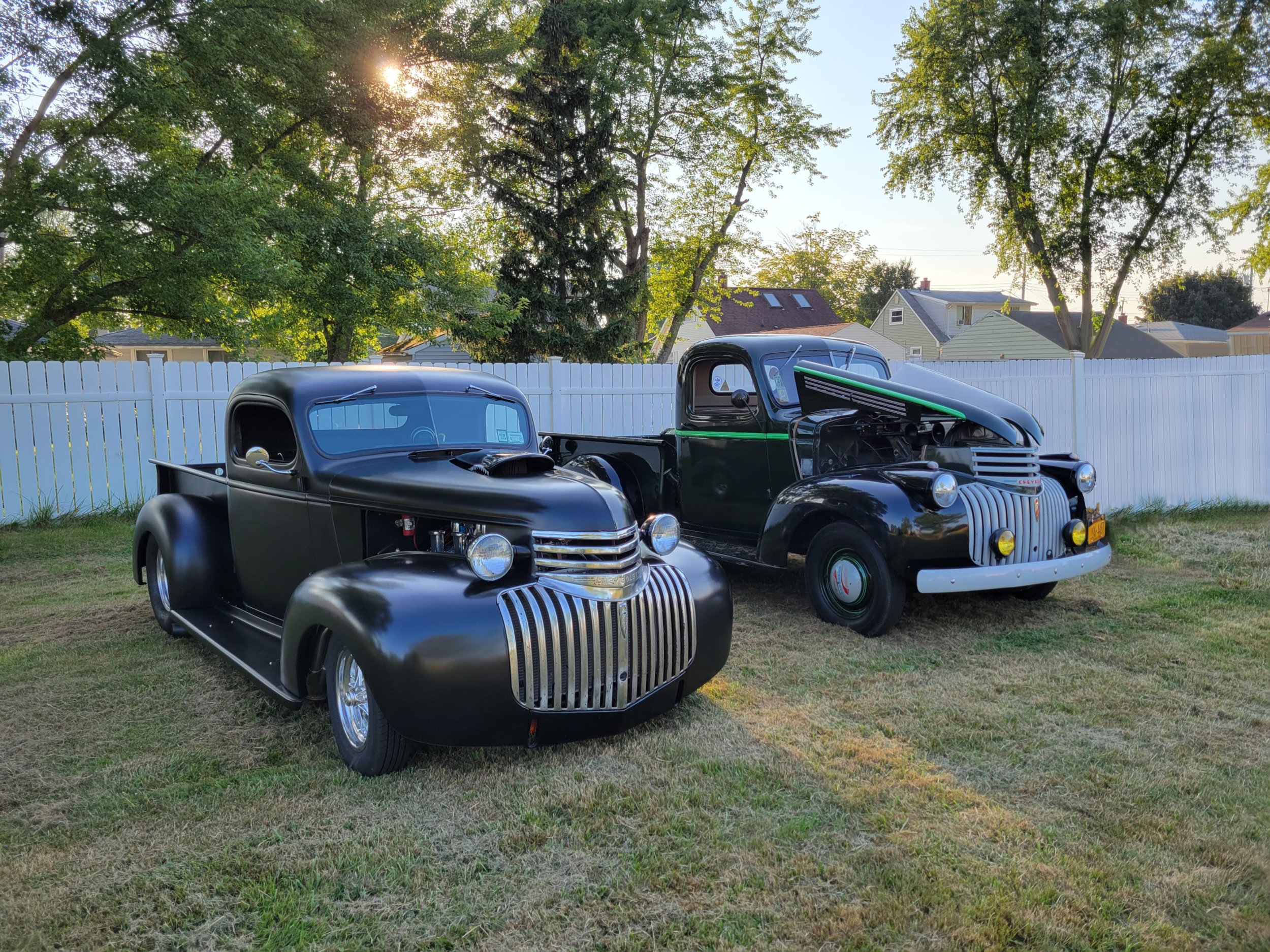

  14. I was finally able to park next to a stocker for a side by side comparison check.
    Altitude difference from roof to the ground is most noticeable
    Headlights moved, fender tops rounded off, hood and fenders molded together, custom made scoop, shaved bumper, running boards widened at rear and straight level body line from nose to bed rails
    Shortened wheelbase, shortened bed, shaved doors, smooth running boards
    This shows the bed sides being raised to better line up with the body lines and bed slid forward to eliminate the gap between cab and bed
    This angle shows the rear window moved down 2 inches and chopped 2 inches. The bed is 4 inches narrower and rear fenders are 2 inches wider, of course custom bumper, tailgate and taillights.
    Every piece has been modified on this old truck with the exception of the cowl. Maybe a couple more changes to come down the road, who knows.
