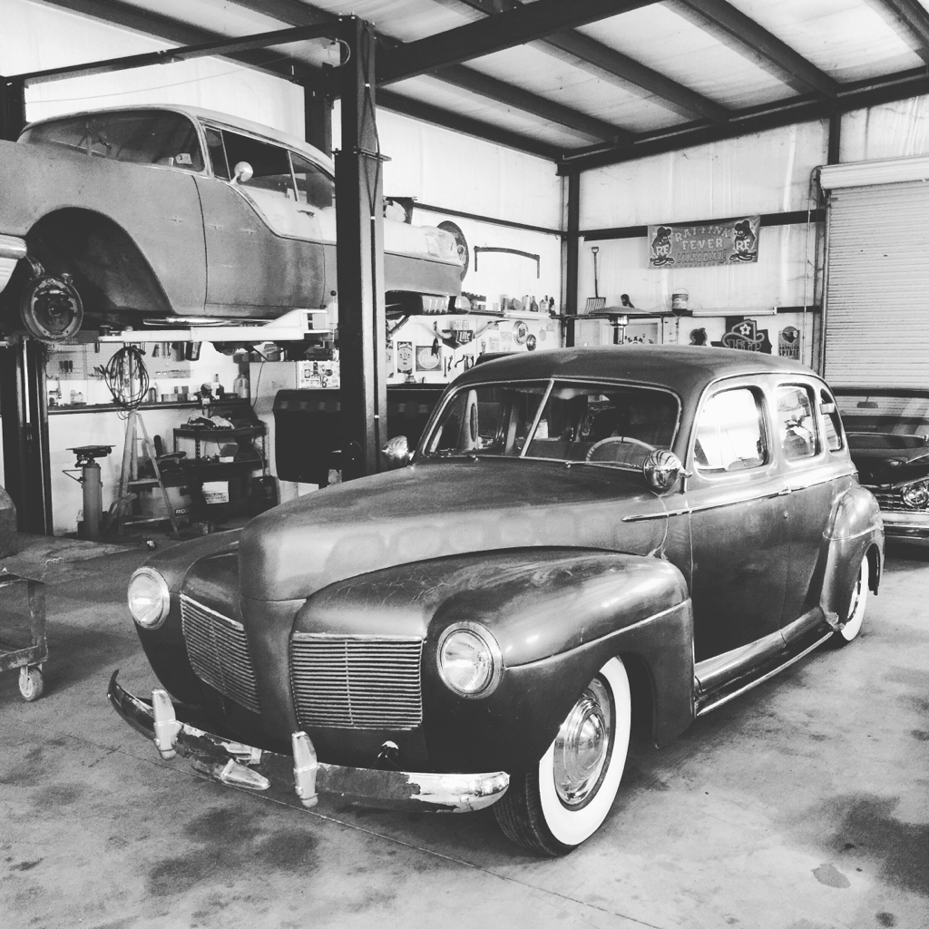

  3. eric54chevy
    Joined: Jun 3, 2009
    Posts: 988
    eric54chevy
    from TEXAS!
    ROCKER77 likes this.

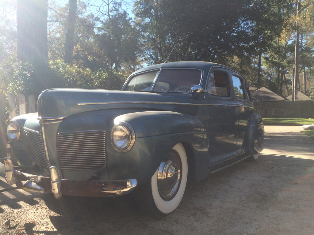

    Eric54chevy, that is one nice Merc. I had the exact same one when I was 18. I love the front on the Merc's better than the Ford's. Here is my 41 Tudor:

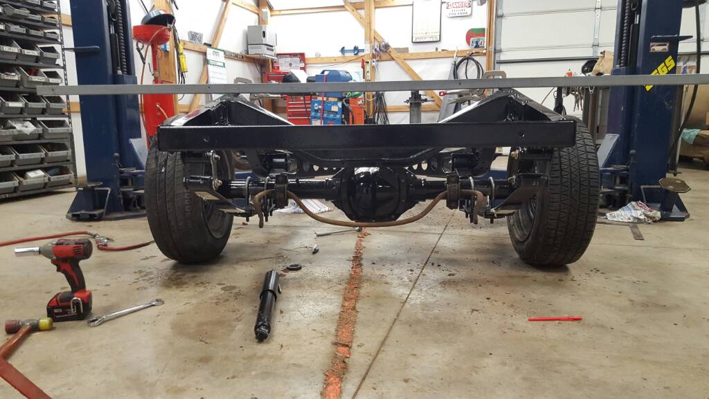

    Nice and warm here today, made a little progress. Axle hung and centered. Next step is to locate and weld upper shock mounts. I might be able use the factory anti-roll bar.
    Free tires and cheap wheels will have to do the job until I find the right ones.
    On to the front axle.

    Looks great! Ive been down with the flu for the last week so no progress on my end.
    Looks like the 8.8 is a great fit too.

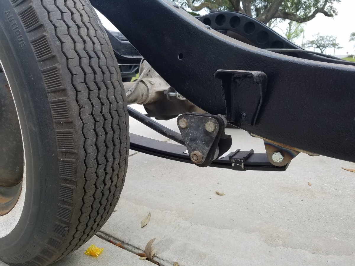

    Well...not a whole lot of progress on my end. But, I did finally get the rear axle bolted in. On a good note, the factory drag links and torsion bar line up pretty well with the 41 chassis and should be an easy mount. Also, I took the advice of Cosmo50 and purchased a cheap set of wheel adapters so I can use the stock wheels as rollers until I decide what wheel and tire combo I decide to use.

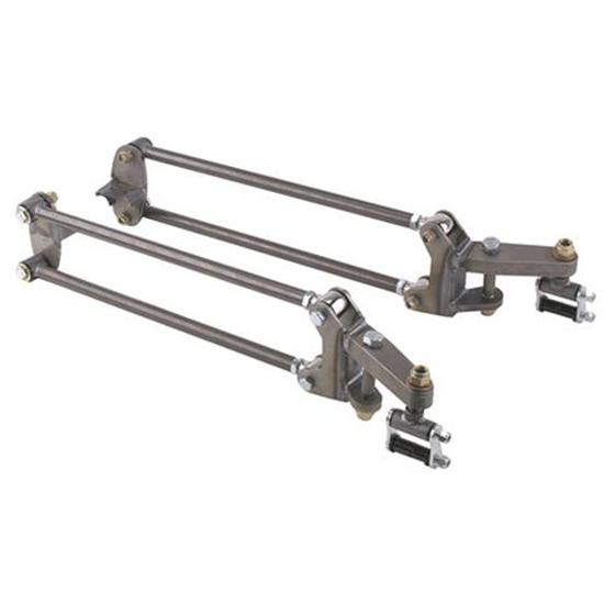

    I am thinking about trying to make this set up work on my 41. Its a 4 bar with spring in front of axle mount. Its for a 35-40 car so I need to find the dementions for a 40 Ford chassis to see how close it is to the 41. Has anyone had any experience with this setup??? Here is the PDF instructions:
    916-39108 Instructions

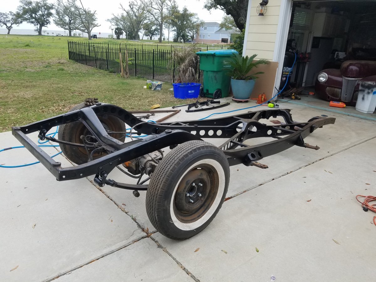

    Ok....not much interest in this slow moving thread I see...LOL....While I do plan to go thru the eng/trans, for now its a perfect mock up for the mounts etc....As you can see from the pics the eng/trans is temp installed using Chassis Engineering bolt in mounts. Once I have it all set up, I do plan on running a weld for the mounts. There is plenty of clearance on the right side with the headers, the left side may be a problem. The stock steering box fits fine without an exhaust manifold, but the headers I had laying around wont fit the left side....But no big deal....I will figure out something! ;) Also, in between the eng/trans install, I decided to get the brakes taken care of. Since the Speedway front disc brake conversion came with new calipers, pads and hoses, and since Im installing new lines and master cylinder, I figured now was the time to install all new calipers, pads, rotors and hose lines in the rear. Im going to go with a Speedway master cylinder and mount that just bolts in for the 41 Ford. Once that arrives, I will be able to make all new lines and be done with the brakes.
    I am very pleased with how easy this Ford Explorer 8.8 rear has bolted in. It required very little modifications to make it fit. The torsion bar and drag links are almost a bolt in! Wont be long before the body goes back on!

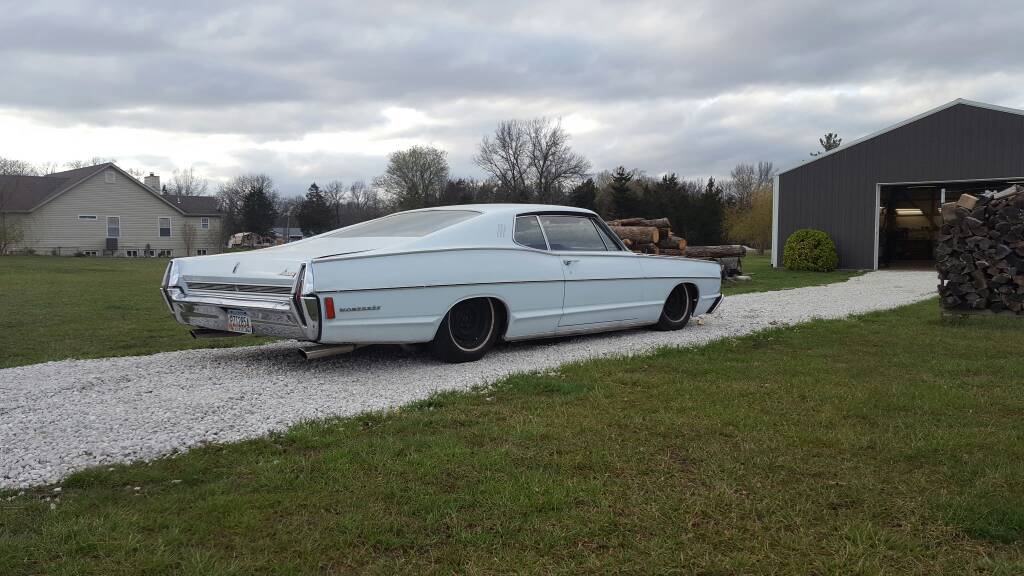

    You are making good progress! I have gotten bogged down in a customers build, but it's almost done. Making real good money for my project. I did land a 50 Mercury overdrive for my project, and my axle goes out next week to be dropped.
    This is what I've been doing, can't recall if its hamb-able, but oh well[​IMG][​IMG]

    That Merc looks good!
