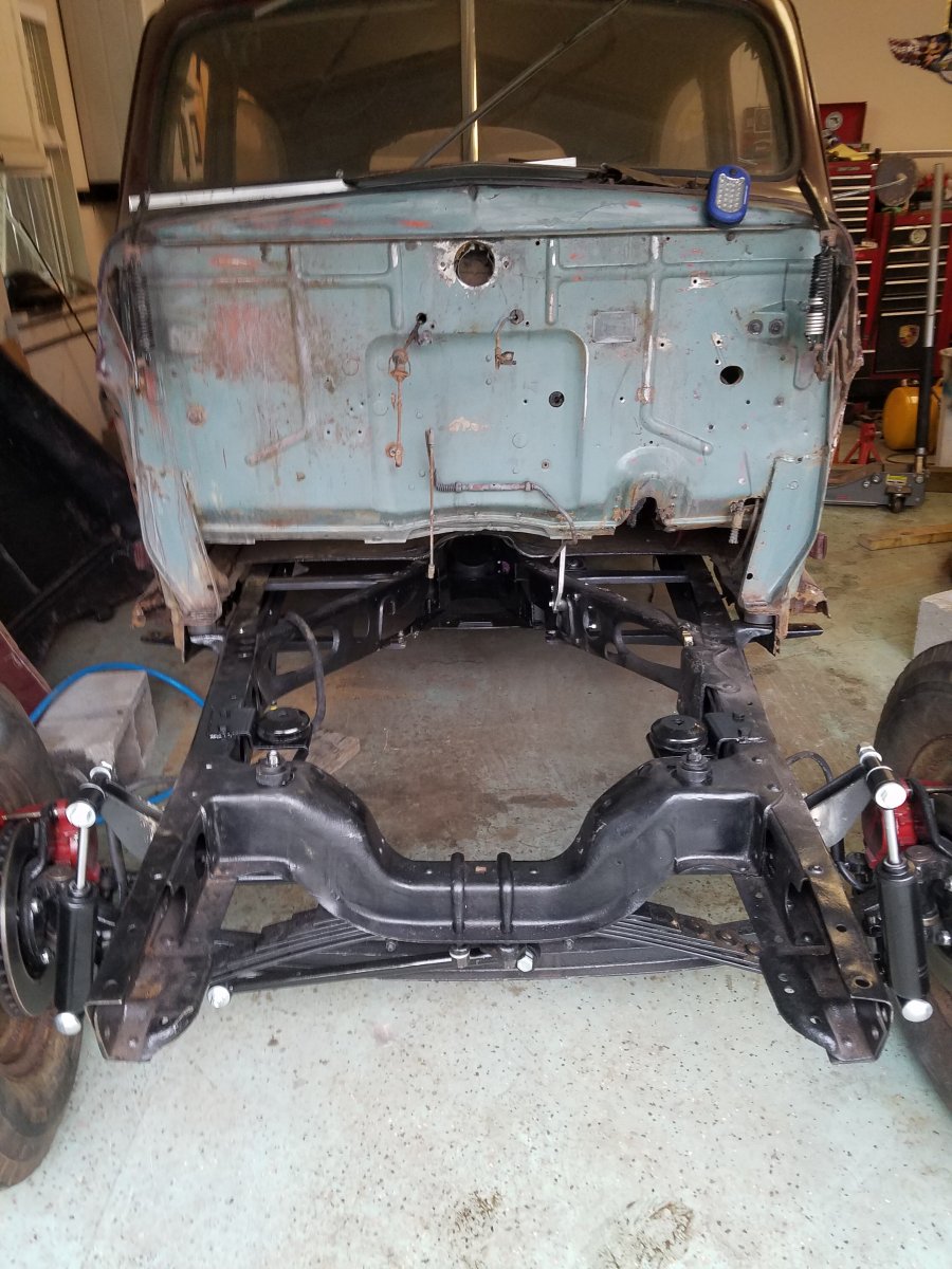

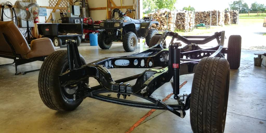

    Made some progress this weekend. Axle arrived Friday late afternoon and it was go time. Brakes and rotors and shock kit on. Going to set motor and build trans crossmember before i mount the sway bar kit and panhard bar. Tires are a little wide for my taste, but got all 4 for $50. Will work for now. Almost finished with the lower end on the flattie, bearings checked good, and i found a later style oil pump and pickup in my stash. Hope to have it in by Tues[​IMG][​IMG][​IMG]

    Wow those front shock towers seem awful high. Is that a kit or something you fabricated?
  3. Hyvolt
    Joined: Jun 12, 2016
    Posts: 279
    Hyvolt
    Towers are only 8 inches above the frame. Looks tall with nothing else to compare it to.

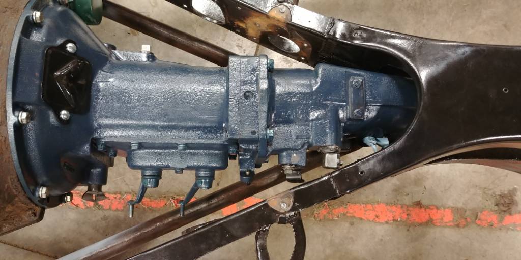

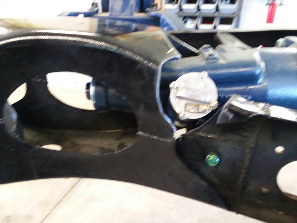

    [​IMG][​IMG][​IMG]
    Alright, mocked up the trans and motor tonight. Looks like i will not have to split the wishbones, but i will have to make some notches for the solenoid and governor. Dont know yet, haven't got under it to tell, but thinking i may have to c notch one side of the wish bone. Anything wrong with that ?

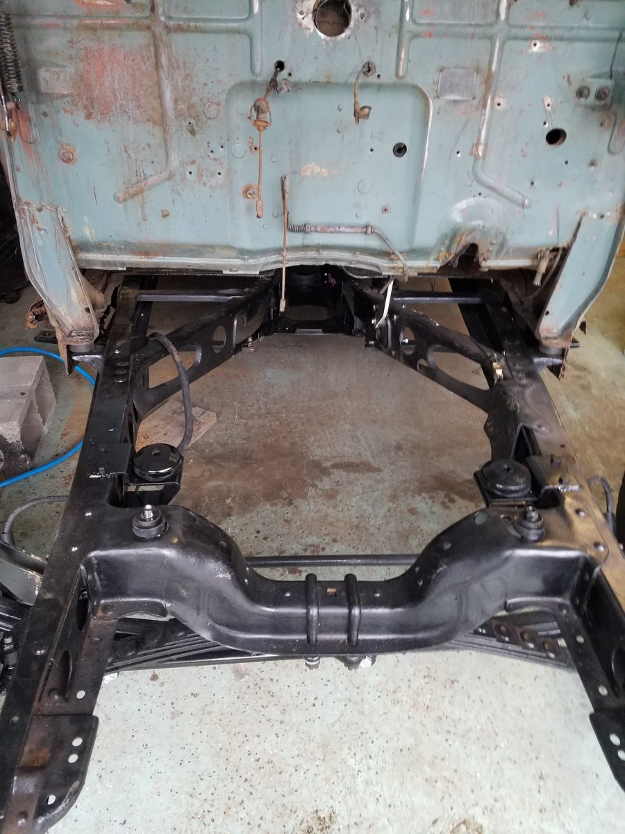

    Looks like the X member box might make access to the governor a little challenging. Hopefully it will at least fit in the space. You have to allow for a little twisting from all of that flathead torque too. As for the the solenoid/wishbone issues. I am no expert but I would be reluctant to cut and notch the wishbone.
    The spacer would be helpful but may change your front axle camber a little. I don't think there is all that much movement of the wishbone that close to the pivot point but that is just an assumption. It would seem that the lower the car the less movement you will get out of the wishbone.
    When working on that front axle and spring height stuff keep in mind that you still have over 1000 ponds of body to add on which will lower the car some more. I kept watching mine get lower and lower as I added weight to the car. I eventually I had to swap from the reversed eye spring to a standard spring to get tire clearance.

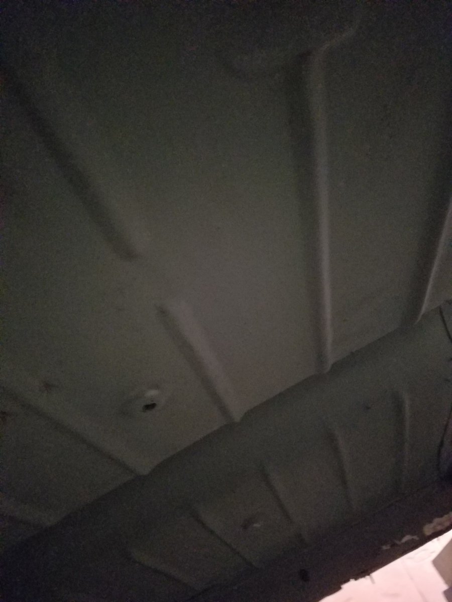

    Also, still had some day light left so I decided to lower the body onto a safer work area. The floor boards are in very good shape but had a lot of surface rust. I crawled under and got my black and decker grinder going with a wire wheel. What a nasty dirty job!! I got about 3/4 of the bottom of the floor boards done when the grinder gave up the ghost!...lol... I sprayed an etching primer on what I got done and will spray paint or undercoat it when I get a new grinder and finish up the back part. You can kinda see in the first photo the surface rust I still need to address. But...still got a lot done today!

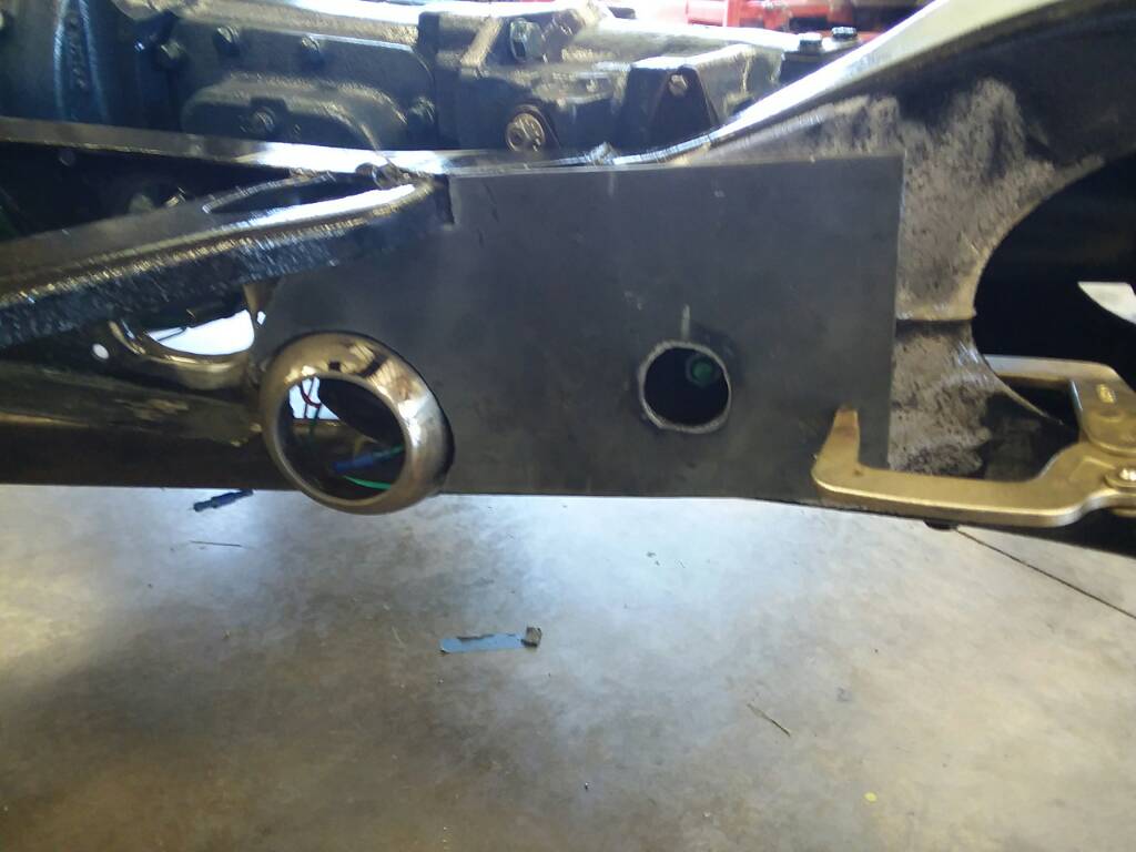

    Making some progress. Found a old trans part to make a blister with. Had lots of porosity in the weld today. I'm sure it's from the paint, even after grinding before. The frame plate will cover the left, but in tree air on what to do with the govonor side[​IMG][​IMG][​IMG]

    Also made the trans mount[​IMG][​IMG]
