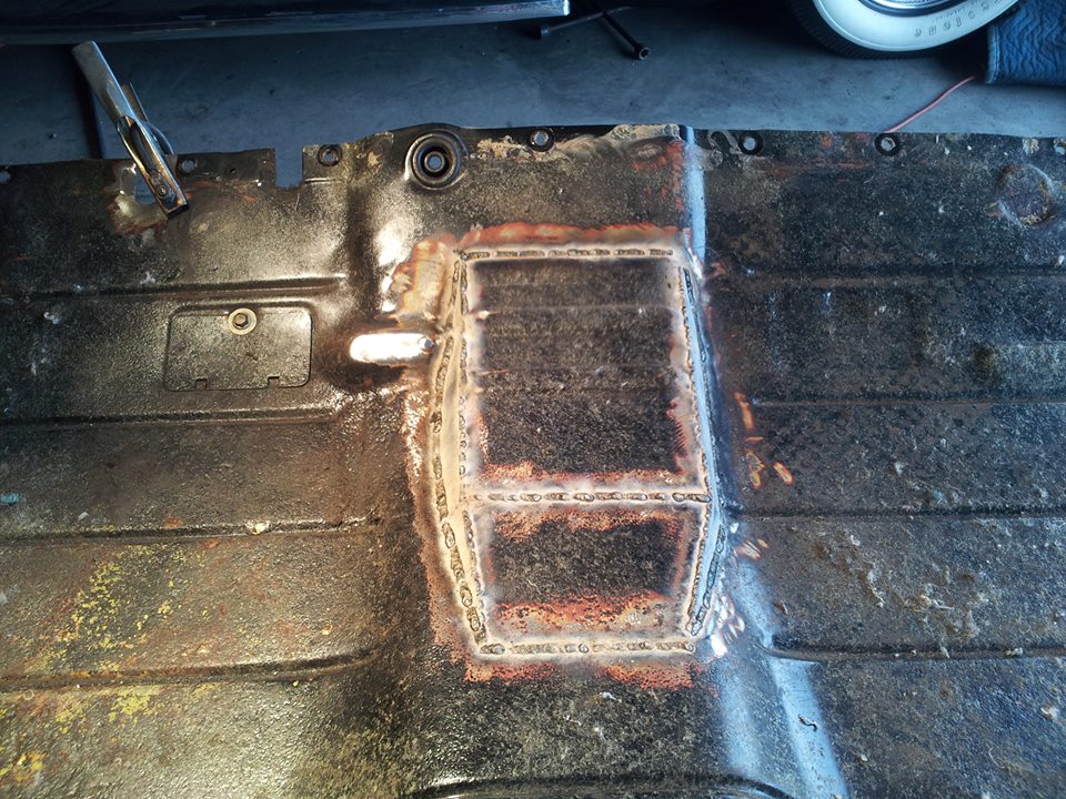

  30. englands54
    Joined: Jul 28, 2008
    Posts: 168
    englands54
    I have spent some time on the inner wells and trans tunnel. Here is the pics of the trans tunnel.. I will get the inners tomorrow for ya.. Now the trans clears nice and theres room.. Can take the engine and trans out without pulling the floor..
