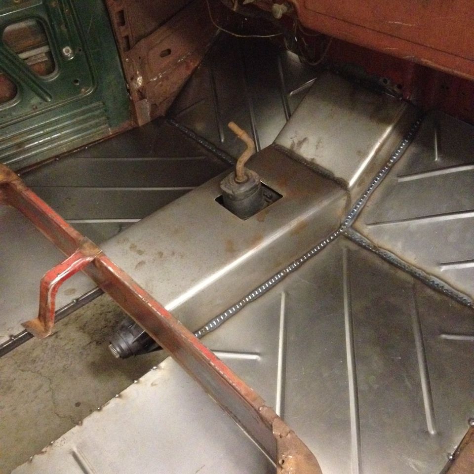

    Alright, time to get back on this build! The last year or so, Ive been busy with my Model A but now its time to get the Dodge rolling again. First thing to do now is take on the rest of the cab rust. I want to get the cab completely repaired and in primer before moving onto anything else.
    I started with the floors. I didnt like the way I had built them so I tipped the cab on its nose to have a look at what it looked like. It was a lot uglier than I remembered, haha.
    I decided to cut it all out and start over :eek:
    I built a new rear cab support but forgot to take pics. A simple piece that I bent up in the brake and shrunk slightly to get the contour.
    I then built a floor structure
    and a quick mockup to be sure I was in the right spot with my body mounts...I lost the picture with the front sheetmetal hung

    Next was to make the tunnel and floor
    All sized up
    Bead rolled and welded

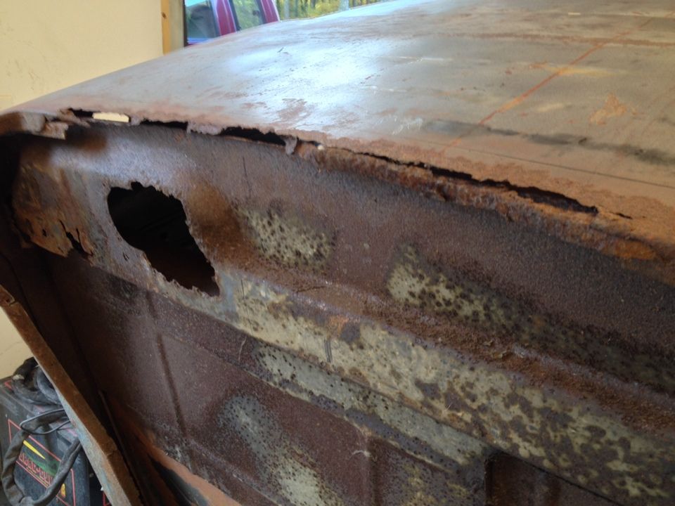

    After the floors were done, it was time to move on to more rusted cab metal. This is the roof where it meets the header panel.
    As you can see it was in very tough shape. I had a few options on what to do with this...try and make a patch panel, shave the roof seam, or find a donor panel. shaving the seam would have been the easiest option, but I really like the look of the seam and feel it looks too "street rod" style to shave it. After searching for quite a while, I found a Hamber (ozzies 57) who was willing to cut me a roof panel. I also bought a mint grille from him! Thanks Brian!
    So I decided, since I'm cutting and welding the roof anyway, why not chop it! So I marked out 2 1/2"
    and made the cut
    Roof going back on

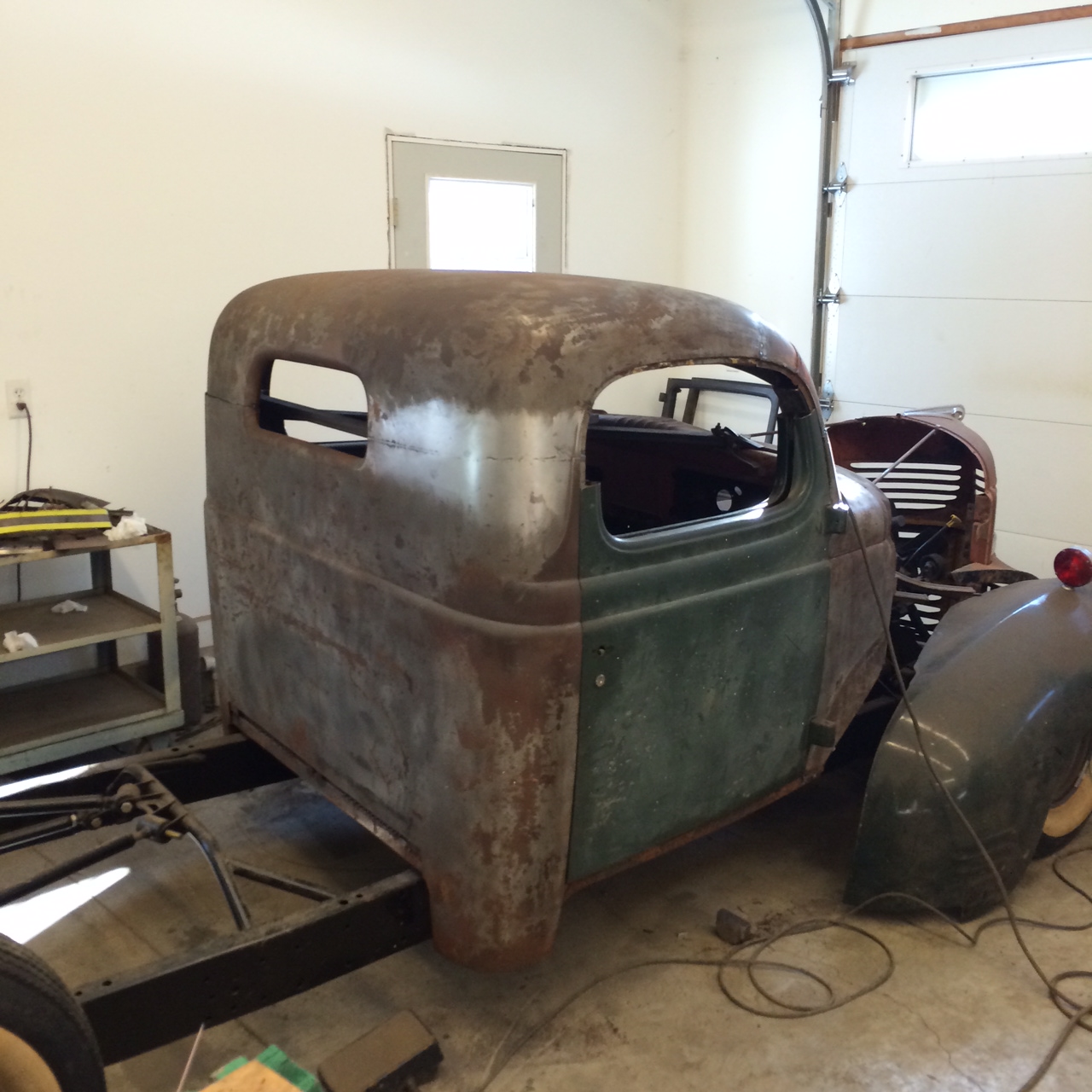

    Fitting the new header panel
    All in place, held with panel clamps
    The back of the cab looks lumpy in this last pic. It is not welded yet.
    Thats where I'm at currently. I will be tig welding it all together starting Sunday. Will keep you guys posted!

    Just found this thread and just had to say that's a great looking truck! Amazing job on the rust repair and the chop.. Any new progress?
    Is that an old Hudson Jet in the background of this picture?
  18. rusty1
    Joined: Nov 25, 2004
    Posts: 13,150
    rusty1
    ^^^looks like a 50 Ford to me....very nice build on this truck!!

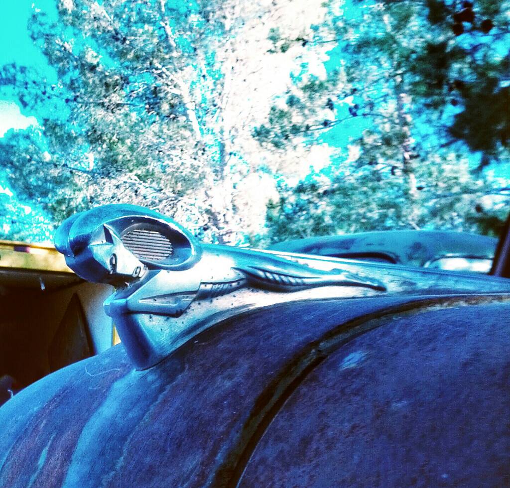

    Joined: Oct 1, 2008
    Posts: 142
    Feo
    Did your truck have a ornament like this one ? What year is this ?
  20. Feo
    Joined: Oct 1, 2008
    Posts: 142
    Feo
    sorry man didn't look close enough I see it on your truck.. my bad
