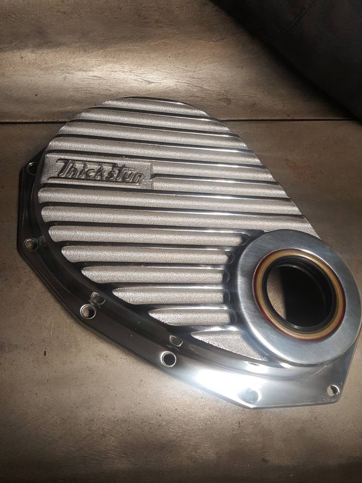

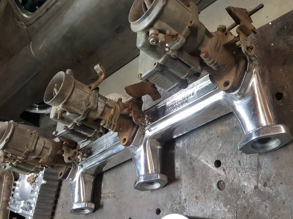

    Not much going on this project. I had a over heating issue a few months ago and discovered the block is cracked and leaking water. I'm considering trying to repair it as if like to keep the original 228. If anyone has any successful recommendations I'd like ideas. I've seen repairs done where you drill multiple holes and tap with a small pipe plug that tapers then overlap the plugs. It seems promising. I've also seen some tig rod to weld cast that appears possible but also a one shot fix.
    In the time between getting to fix it I've been looking for some hop up and shiny parts. Picked up a 3x1 nicson intake and thicktun timing cover. Going to order a set up thicktun valve and side covers this week. 20190126_214859.jpeg 20190116_184459.jpeg 20190116_184446.jpeg 20190116_184417.jpeg
