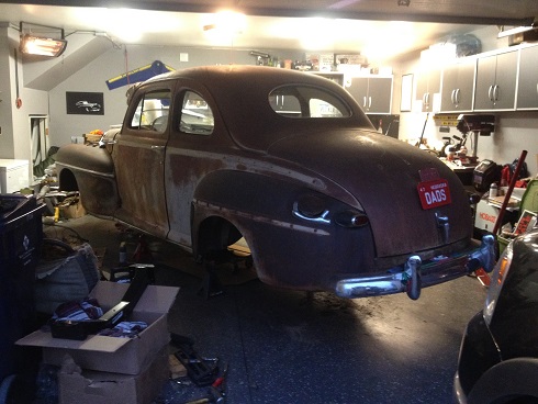

    Well, I figured I would finally get to working on my 47' Ford Coupe. I got inspired by fellow HAMBER Tim, and decided to follow suit. My wedding is in June and I recently got home from a stint in Honduras with the military. My brother and I acquired the '47 after the passing of my father 3 years ago. It has sat in storage far to long. We'll be starting with a 78,000 mile long door coupe, that sat near a barn in central Nebraska for about 20-25 years. The previous owners kids pulled the original flathead and tranny to have them rebuilt.... They are no where to be found. So, with the new blank canvas will go a 302, C4, Maverick 8", Sids dropped axel, and CE leafs out back. Earlier this week I received a few parts from CE to get me started...

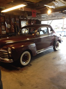

    I will be following along.... Funny, everything you mentioned is what I'm doing on my 46. I just got my parallel leaf kit from chassis eng. and I already have a 302/C4. Like wise, gonna do a dropped axle. I heard it gets super tight with the 302/C4. Might have to do a fire wall mounted brake set up and have to use the stock steering box for clearance. ImageUploadedByH.A.M.B.1385193332.866987.jpg

    Joined: Nov 28, 2011
    Posts: 54

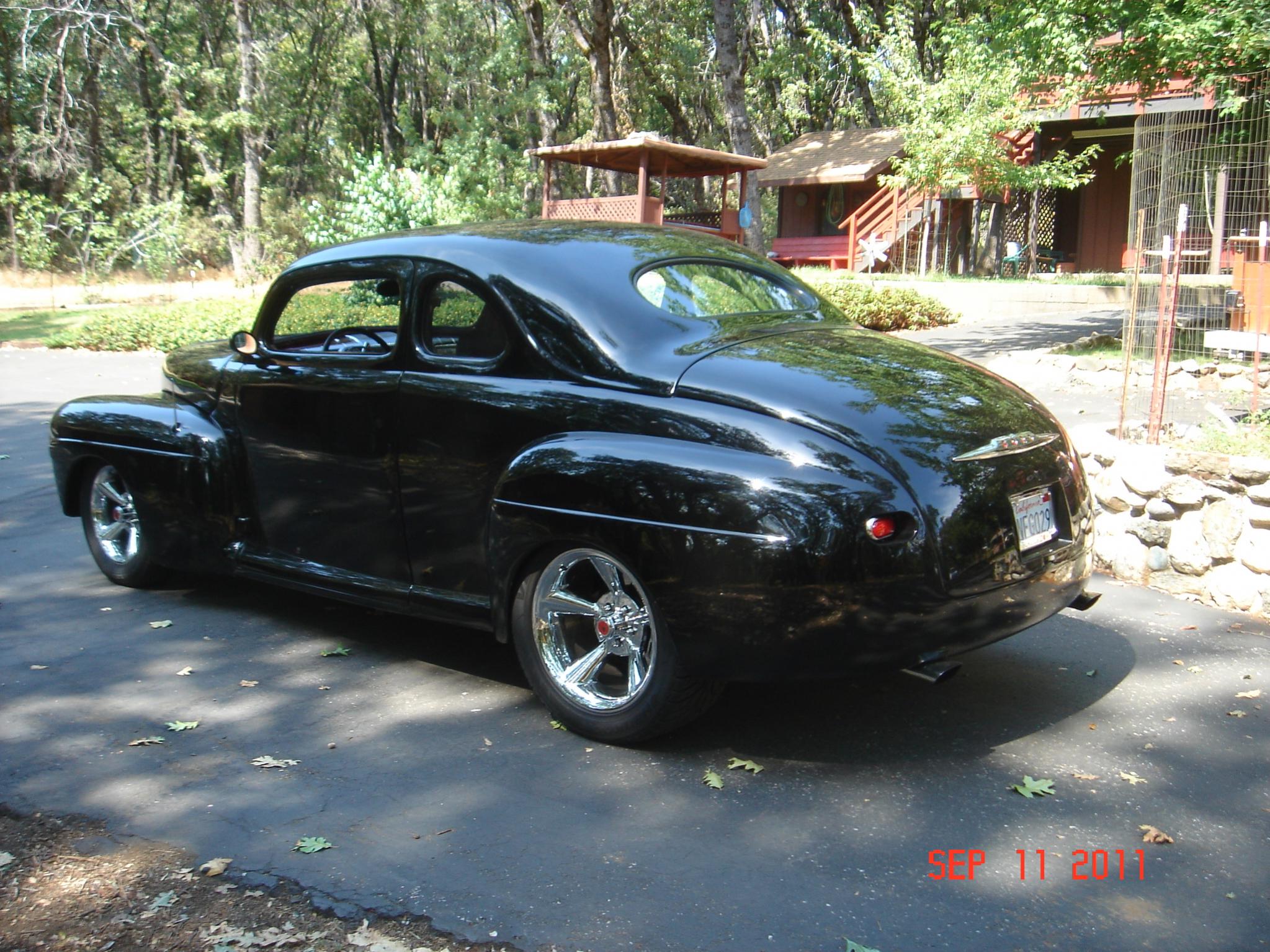

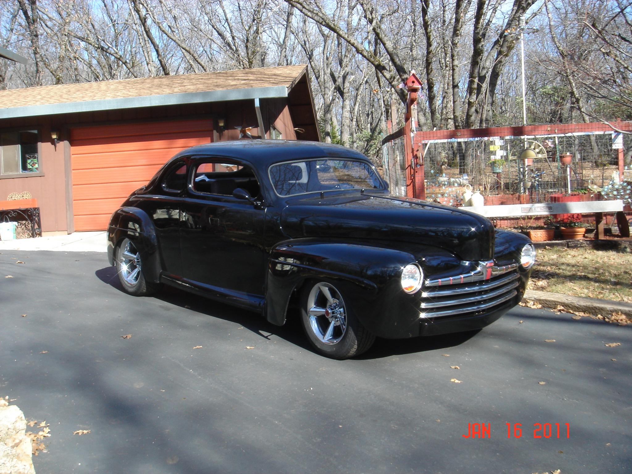

    I finally more or less finished my '46 Ford last year. It took me an incredible 13 years because I kept getting side tracked with other projects. I used a frame from Chubby Chassis and a BB 502 with Edelbrock fuel injection. I chopped the top 4" and frenched the headlights and tail lights. I call it the black widow because of the big butt that looks like it needs a red dot on it.
    Good luck on your build,it sounds like you have a good design in mind.

    Update: the rear end is done, minus the upper shock mounts. On the ground and about 14" high. The CE kit was by far the easiest bit of suspension I have installed yet, I highly recommend them. My brother and I will be attacking the front end Friday after the Husker game. View attachment 2083938 ImageUploadedByH.A.M.B.1385583295.417475.jpg
