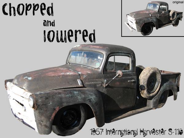

    I have a 46 ford cab i plan to section and chop. I think more people should do sectioning but then it wouldn't be different now would it?
    I also have a 1957 IH. Check out the photoshop of it i did.
