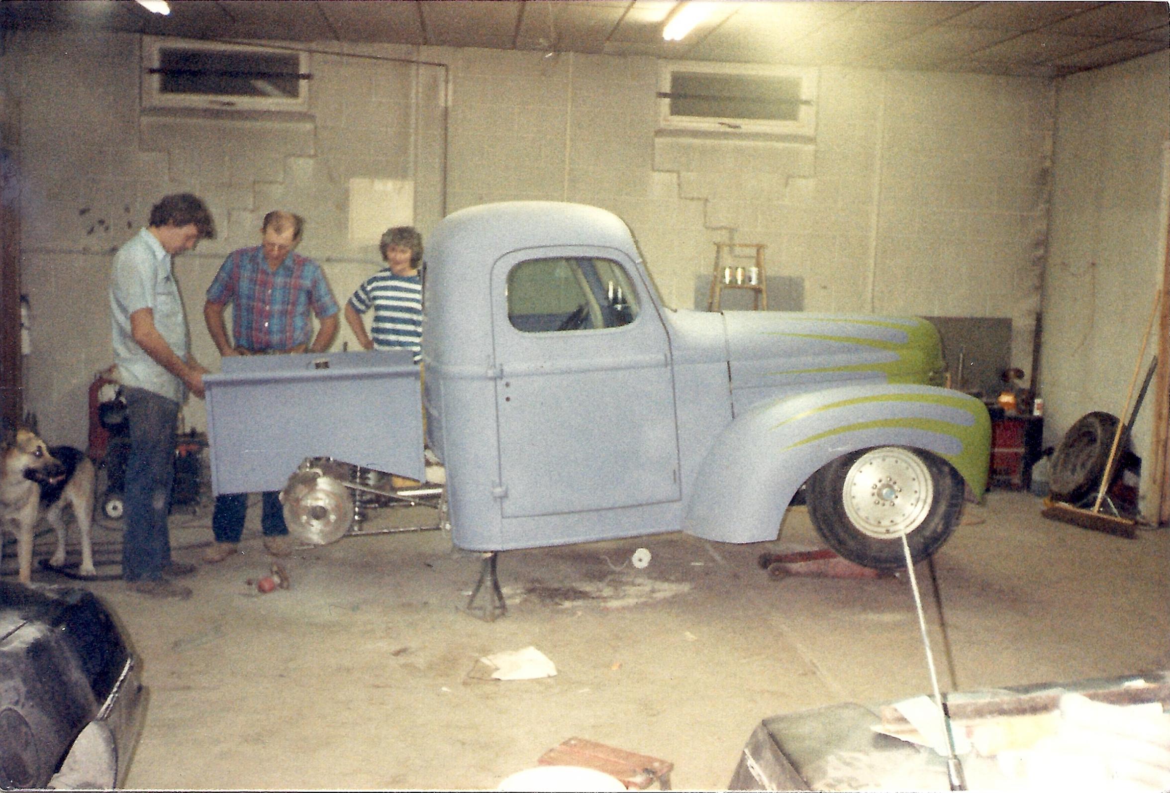

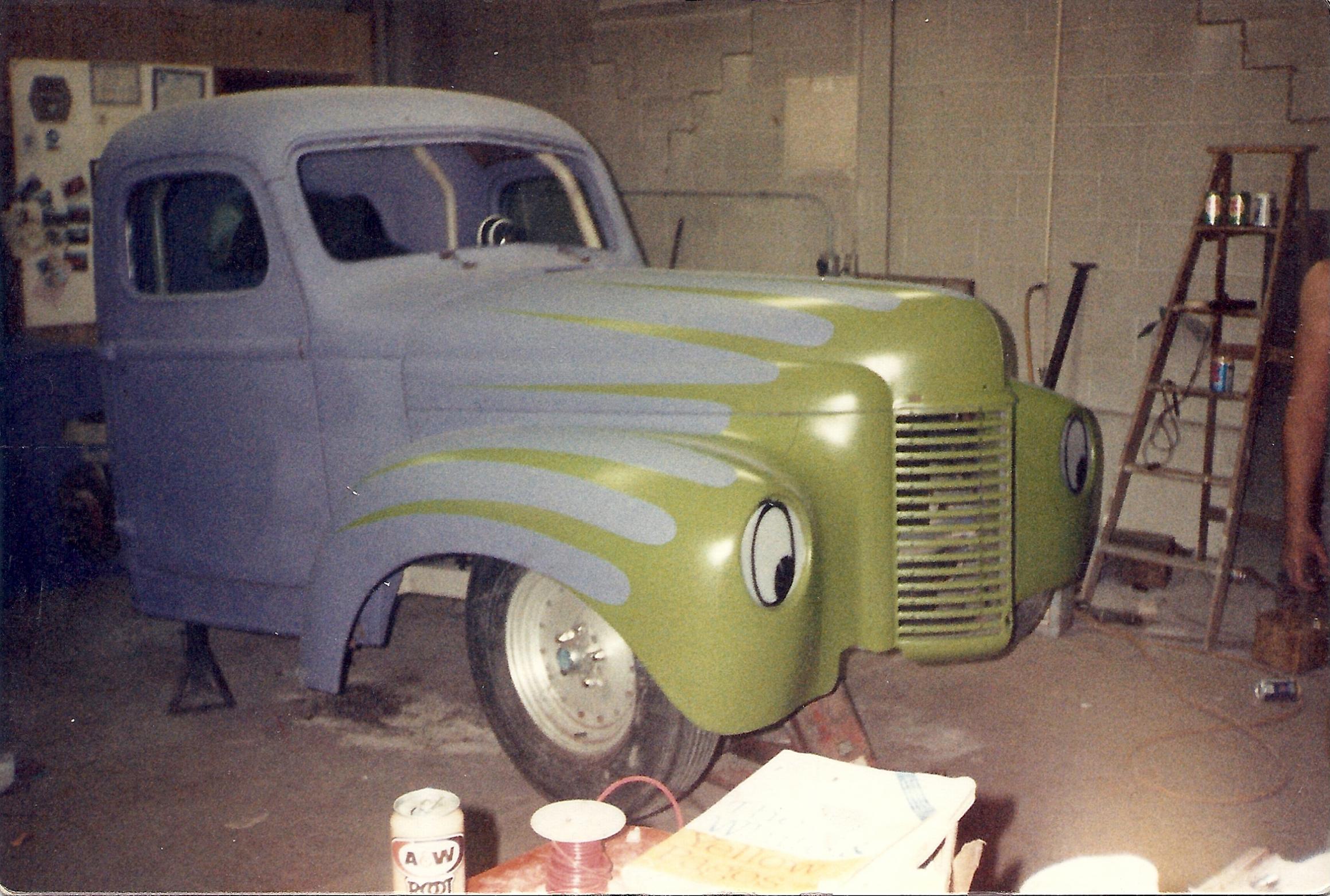

    Isn't it too high then? Sectioning the grille sounded quite resonable. Anyway - great truck and great work! :)
  2. PUTRID FAME
    Joined: Jan 29, 2008
    Posts: 87
    PUTRID FAME
    hell , she will be just right. check out the pic where the front end is laying on the dirt

    So,,do you have to section your grill and what not,,or just hack a inch or so off the bottom of fenders..Looks great and you could drive just the way it is long as you stay off the speed bumps...

    I cut my front end off flush to the bottom of cab. The grill I cut the bottom off and then cut about 2 1/2 inched, then welded bottom back on. Take a look at these pictures.
    James

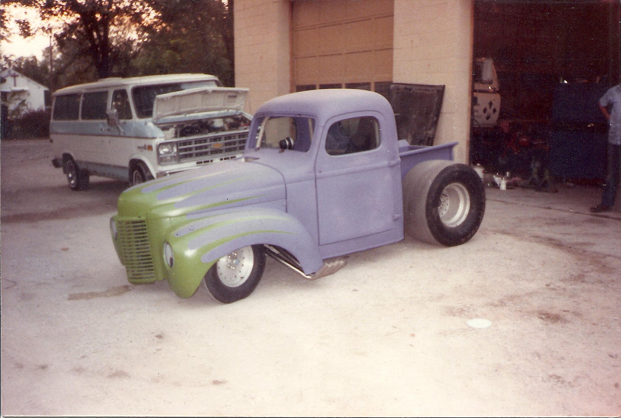

    One more picture of my 48 on it's wheels . This truck was built back in the mid 80's.
    James

    I dont need to now i ordered some 3" 2wd front lift spindles for the frame, solved my problem's now i can keep my fenders long and put on the factory full length runing boards, by the way nice truck man!
