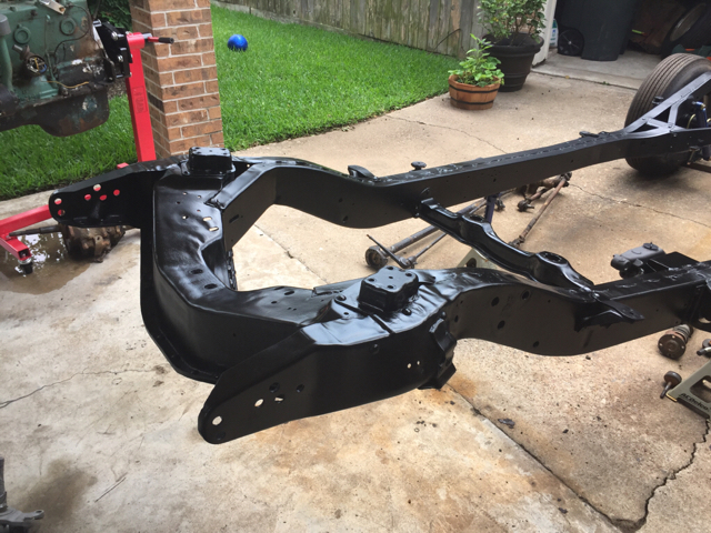

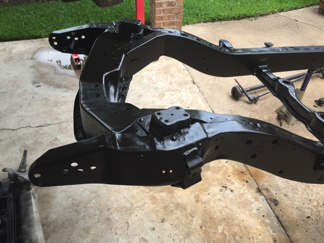

    So my buddy came by this week while I was in Dallas and pulled my motor for me. He said that since he had to rent a hoist for his Mustang he may as well pull my motor while he had it.
    Before
    After
    This then allowed my to get the front of the frame cleaned and painted. I was amazed at the amount of built up dirt and grime. I went through 2 cans of oven cleaner on the front plus degreaser and a m***ive amount of elbow grease with a s****er.
    And painted...

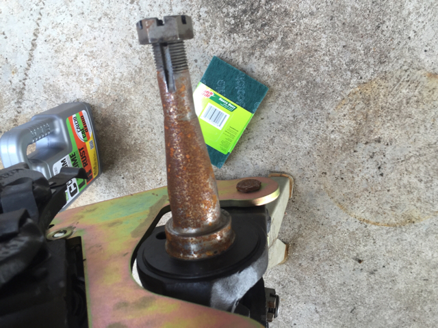

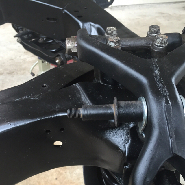

    After it was painted and "dry enough", I started re***embling the front suspension. I replaced my worn out front springs with CC850's and relocated the spring plate from the top of the control arm to the bottom.
    I also installed new shafts and bushings while I was at it. They still need to be adjusted which I hope to get to soon.

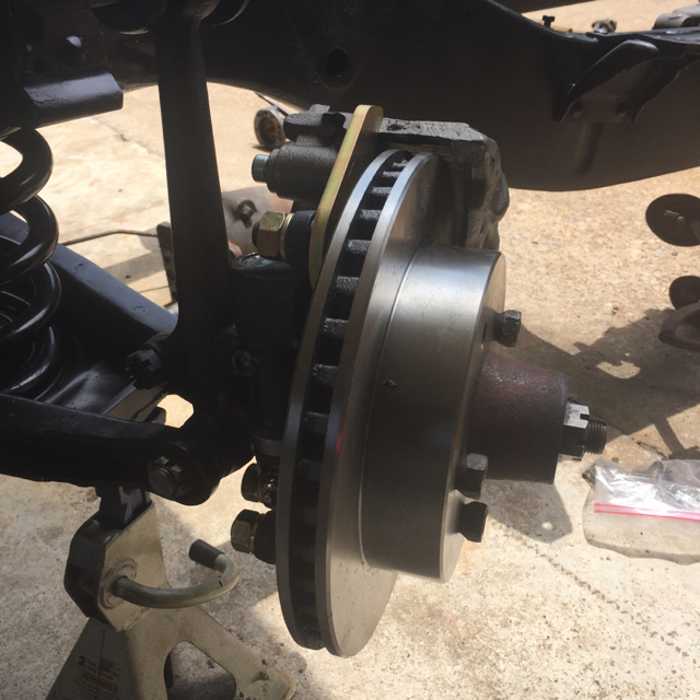

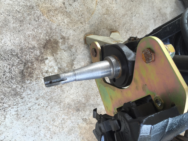

    Started test fitting the brakes at the end of last week. The conversion brackets are from Scarebird and so far it all seems to be going together quite well.
    I did decide to have wheel studs pressed into the original bolt locations. I should have those back this week.

    It appears that the two lower bolts on the adapter plate aren't making much purchase in the nuts. If it were mine I'd install longer bolts. Having another look it seems that the calipers on on the wrong sides. The bleeder valve should be near the top not the bottom. Other than those two points it's looking good!

    I will check the bolts again once I torque them down. Thanks for the tip on the calipers! I will get that flipped real quick.
    I appreciate the feedback!

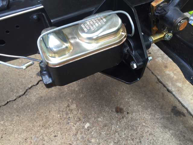

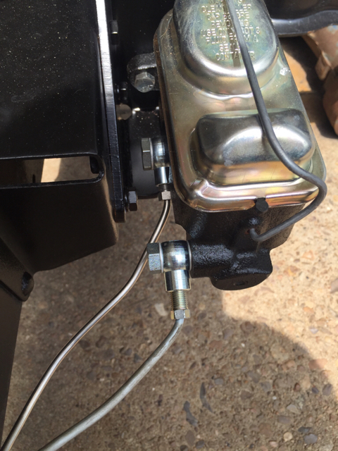

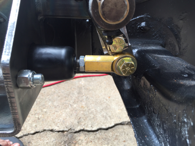

    I decided to go from the stock master cylinder to a dual setup since I am running a disc/drum set up. Figured this would be safer in the long run.
    I ended up using an ECI dual master kit which includes a GM MC, a bracket and some hardware. I had read some reviews on the P15 site about the ECI kit and I can say that had I not read the experiences of those users, this install could have proved very frustrating. However, I was able to read through those installs and made mine a breeze.

    I painted the master cylinder bracket and the master cylinder, then reinstalled the unit. Next I had to finish the brake lines to the front. Do to the tight clearance between the MC and the frame I ordered some 90 feh banjo fittings from Pure Perfomance.

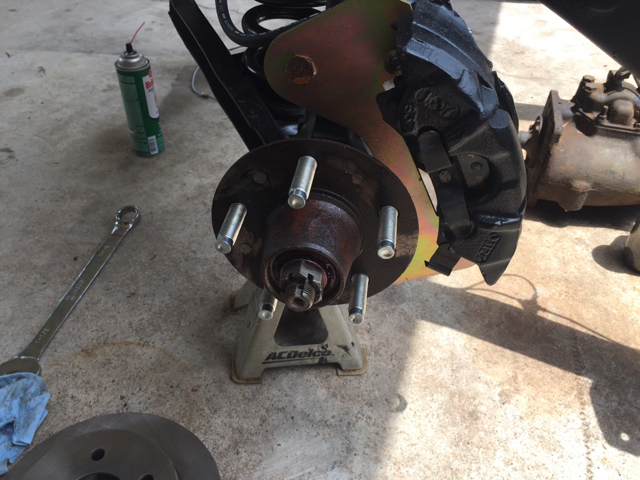

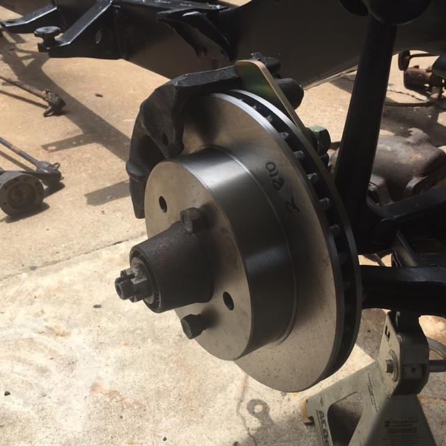

    Now that I had the hubs back with the new wheel studs pressed, it was time to re-***emble the front discs.
    I had to clean up the spindles a bit
    Then I cleaned the wheel bearing with some gasoline and re packed them with grease. I also installed new dust seals on the back of the hubs.
    Now comes the fun part...

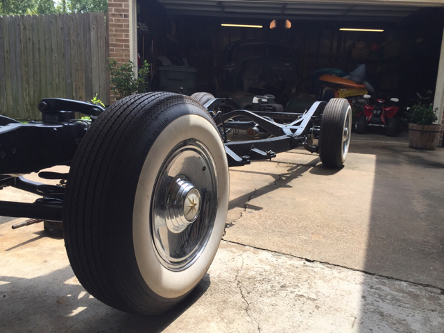

    And now the front wheels.

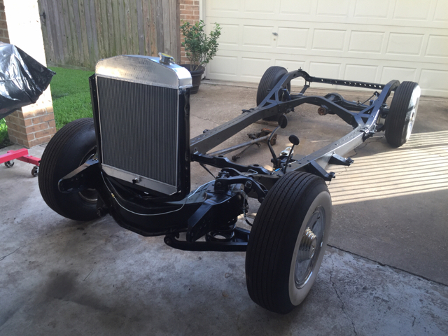

    I feel pretty good about the build so far. Obviously I still have a long way to go, but feels good nonetheless. The frame is not sitting as low as I expected, but I hope that it settled a bit more once the body and motor are back in.

    Definitely glad the frame had minimal surface rust.
    Ended up throwing the new radiator on just because. I will remove it one the motor is ready to be set back into the frame.

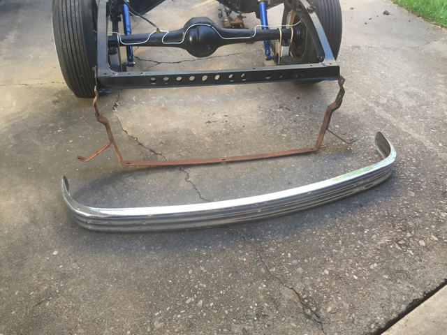

    So I have some 49 Plymouth bumpers that are in pretty good shape. I went to test fit the rear bracket, and wouldn't you know, not a direct replacement. I know need to decide if I should modify the stock brackets and cut new mounting holes in the bumper or modify the 49 brackets and the 47 brackets (find a way to combine them) to make it work.

    bobss396
    Looking very nice. You can probably make up some adapter-brackets to fit the bumpers pretty easily.

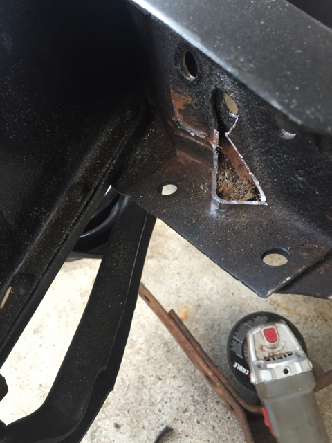

    I also started test fitting the front. Same issue as the rear (not wide enough) but the front will be easier since it seems to fit on the inside of the front frame horns. ImageUploadedByH.A.M.B.1436568405.395208.jpg
    Needed to trim the front a bit to get clearance
    I still need to grind down the edges and repaint the exposed metal.
    Now I just need to sand and paint the 49 bumper bracket then drill some new mounting holes in the front frame and bracket.

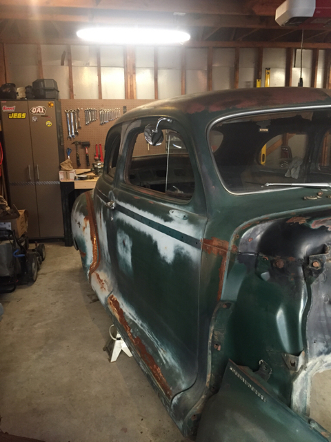

    Well even though the bumpers looked really straight, they were slightly tweaked. So I abandoned the install for now until I can get them straightened. So I am moving on to some bodywork.
    Plan to weld the fender seams
    Plan to fill the plate and 3rd brake mount. I will get the handle shaved at some point once I can figure out a better latching mechanism.
    This it what came back to me after i got the car back. This will get finished up as well.
    Plan to fill all the unnecessary holes in the firewall
    I will also fill the original mirror mounting holes and relocate some swan neck mirrors down the road. I still have some rusted floor spots but not bad and I need the rear rockers replaced on both sides. The trunk pan and the bottom of the rear deck lid will need to be replaced as well.
    More to follow...
