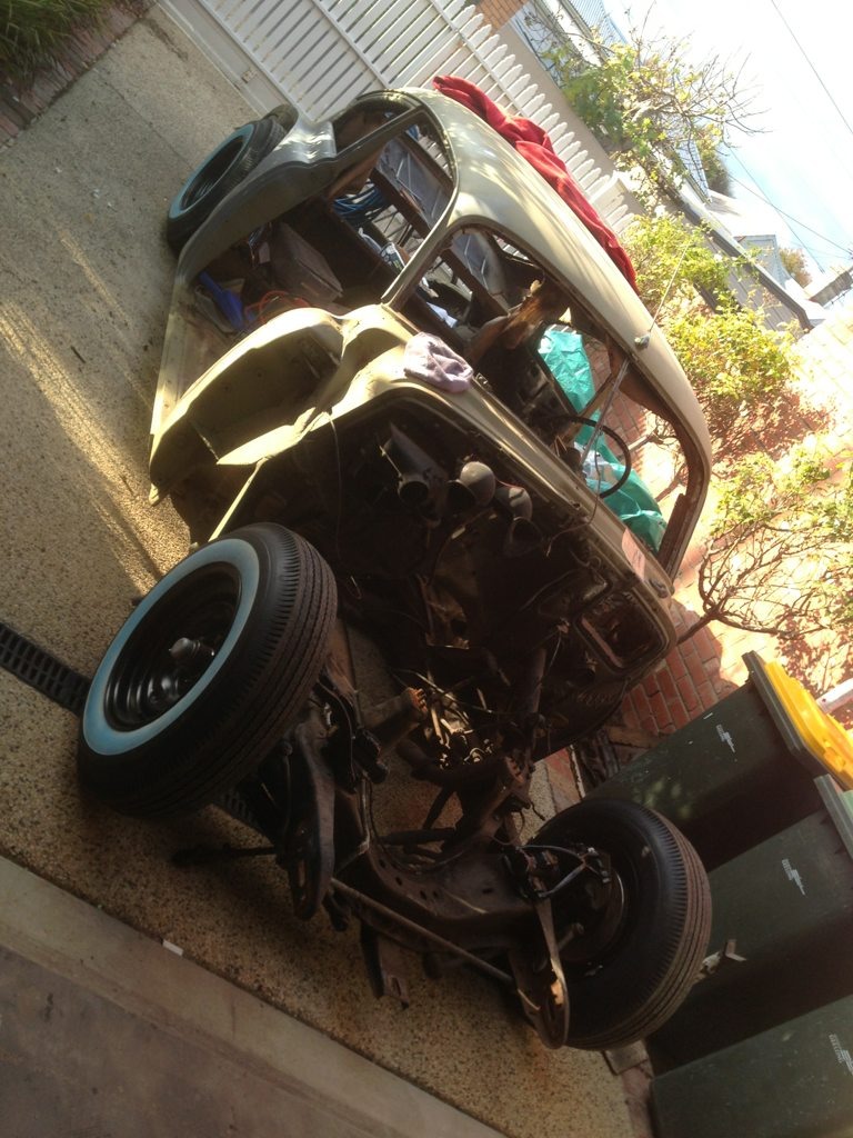

    Just a small update,
    I got the stock rims sand blasted and painted in 2pak, i wanted gloss black but they were sprayed satin black instead there stuff up, but i guess i will live with it for now. I got my New Rolling stock fitted BFG silvertowns 670-15.
    It will lay idle for a few weeks then its heading off to get the rear floor section, tunnel and chassis notch done.
