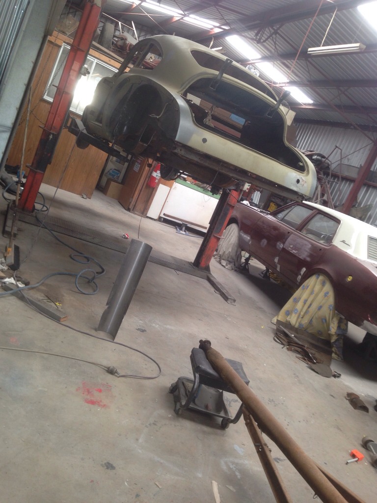

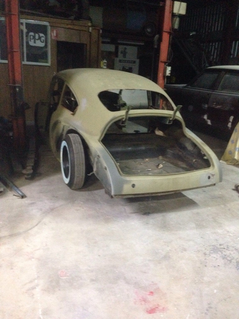

    ImageUploadedByH.A.M.B.1394104642.901257.jpg dropped it off tonight a my mates shop, tomorrow is when the fun starts and get it on the ground. ImageUploadedByH.A.M.B.1394104709.549702.jpg

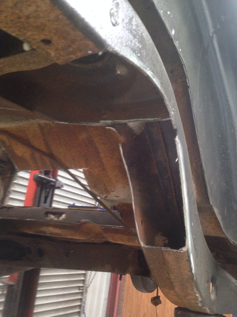

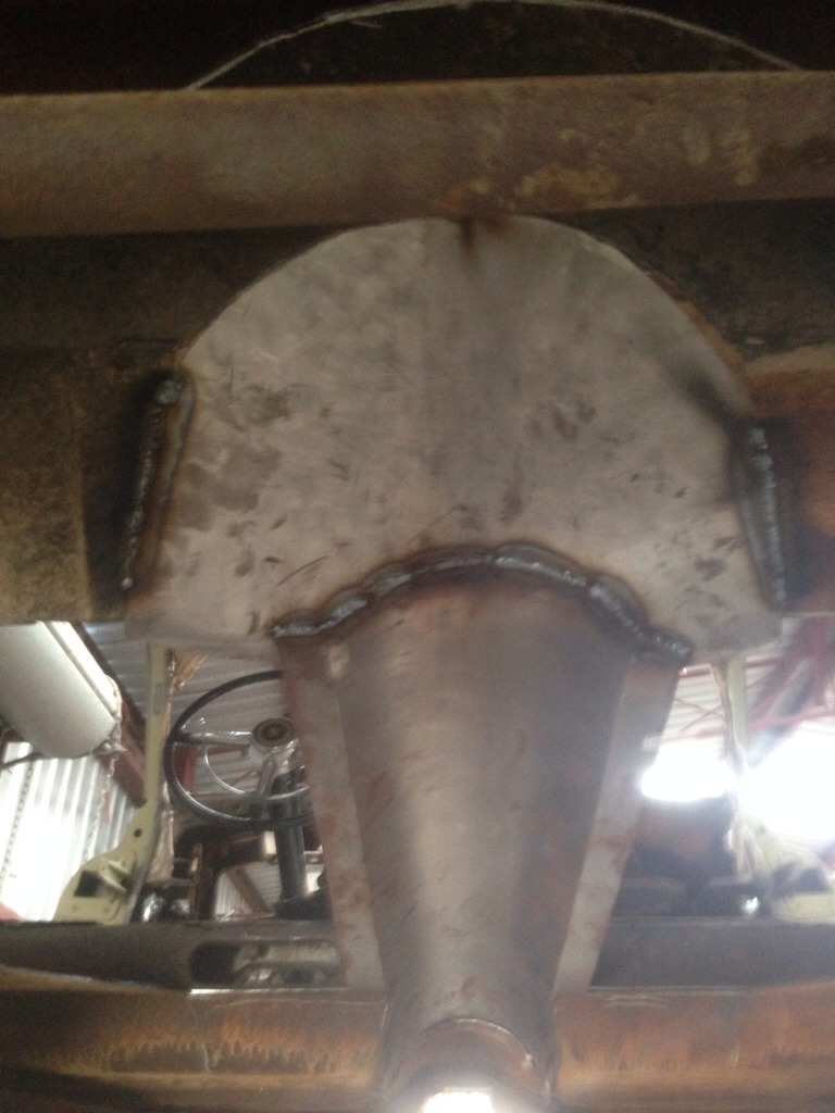

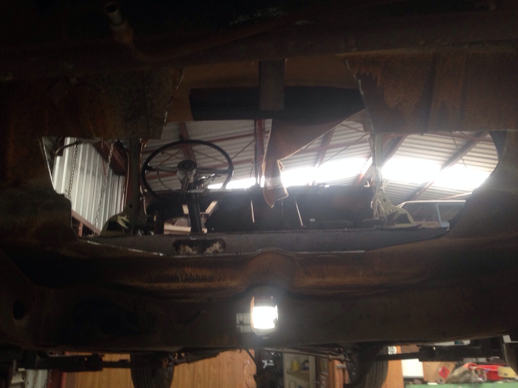

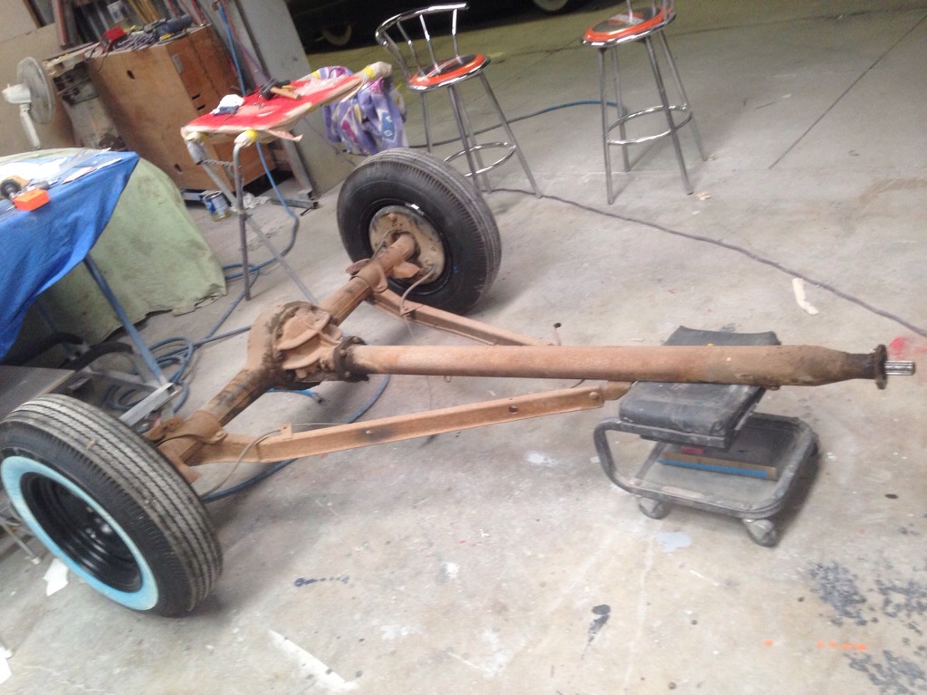

    Today's efforts at my mates work shop. removed the rear axel, ImageUploadedByH.A.M.B.1394270902.531782.jpg
    Ch***is notch cut out inner and outer, we tried to make it flow smooth not just cut and shut it, just need to add a strap on the bottom side and box out the inner and weld in place
    ImageUploadedByH.A.M.B.1394270130.147626.jpg ImageUploadedByH.A.M.B.1394270152.660204.jpg ImageUploadedByH.A.M.B.1394270829.421972.jpg

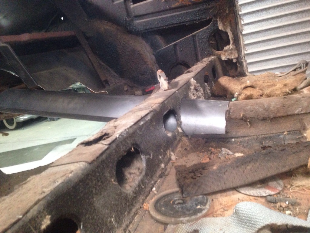

    The rear floor under the rear seat was cut out above the lower control arms and just in front of the rear seat the tunnel was cut out 8 inches.
    ImageUploadedByH.A.M.B.1394270230.638911.jpg ImageUploadedByH.A.M.B.1394270265.899485.jpg
    Above the rear diff the floor was cut to clear

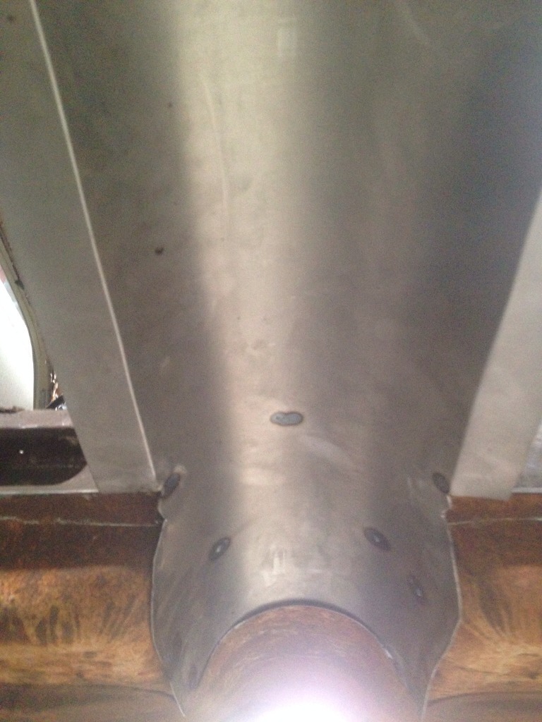

    We fabricated the new tunnel and tacked it into place. ImageUploadedByH.A.M.B.1394270683.980111.jpg ImageUploadedByH.A.M.B.1394270701.993616.jpg ImageUploadedByH.A.M.B.1394270714.379771.jpg

    A couple of rear floor sections for under the rear seat, trial fit. And also a dome for the diff housing. ImageUploadedByH.A.M.B.1394531144.090354.jpg

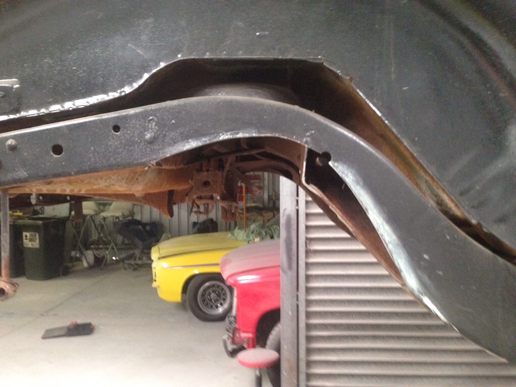

    ImageUploadedByH.A.M.B.1394611236.014148.jpg ImageUploadedByH.A.M.B.1394611270.177924.jpg
    Small up date final position of the diff, the tyres (670 r15) will just touch the top of the wheel tubs when fully dropped down. Plenty of room everywhere else.
