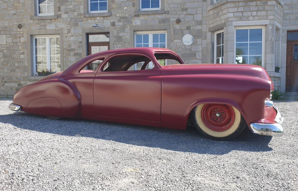

    After a very long way (15 years) and a first session of body modifications that ruined the car, here is my '49 chevy in primer (originally a fordor).
    Here a list of body modifications, although I have probably forgotten some :
    - 2 door conversion with B-pillars moved rearward
    - Top-chop 4" front 6" rear
    - Pancake of the roof 1"
    - Sectionning of the beltline 1"
    - Curved door posts and B-pillars
    - New windshishield bay for two flat gl***es based on shoebox design
    - Original dashboard modified to fit the new windshield bay with the cluster in the centre
    - Lengthened trunk
    - Pancake of the trunk
    - Lowered trunk area
    - Lengthened quarter panels 3" with modified and reversed '49 Buick taillights
    - Custom shaped fender skirts
    - '54 Ford front and rear bumpers modified and lenghtened to fit the body (and inversed... front in rear and rear in front)
    - '53 Kaiser bumper guards with exhausts in the bullets
    - Modified '50 Mercury grill surround with shortened '55 Oldsmobile floatting grille
    - Original modified hood welded in one piece with rounded corners and V shape near de windshield
    - Shaved doors
    - Shaved gas door
    - Frenched headlights
    - '54 Ford front wheel arches
    - Raised rear wheel arches

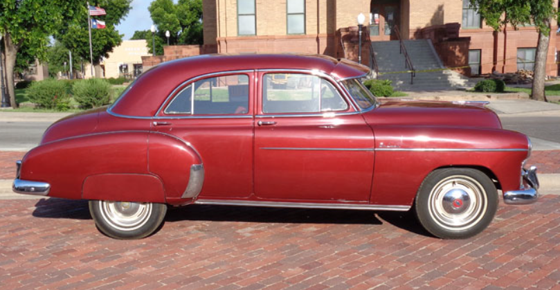

    So, if I am understanding correctly...this
    is now this?
    Mind blown!
