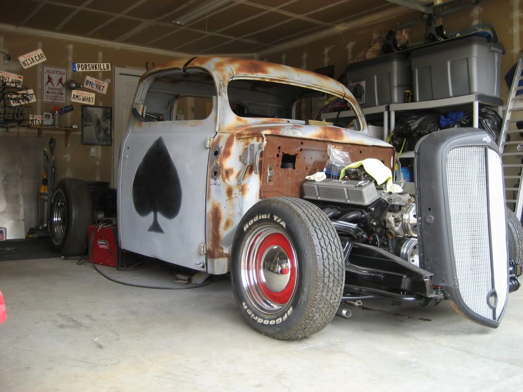

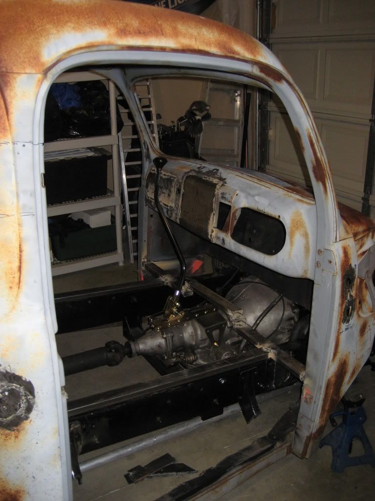

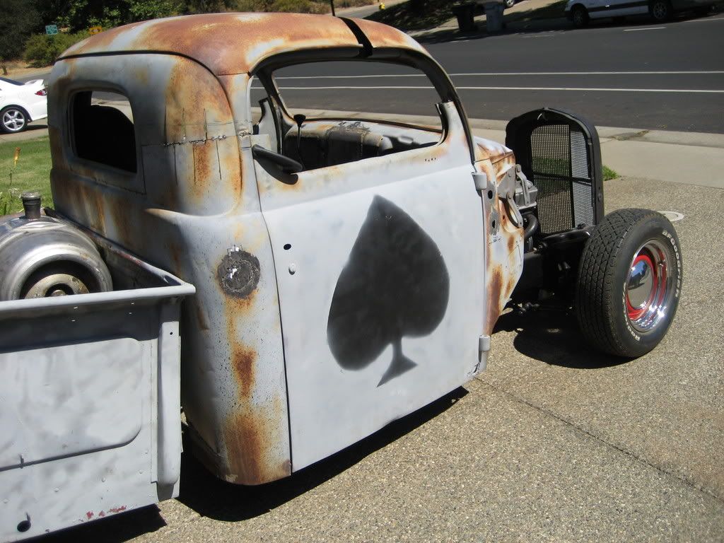

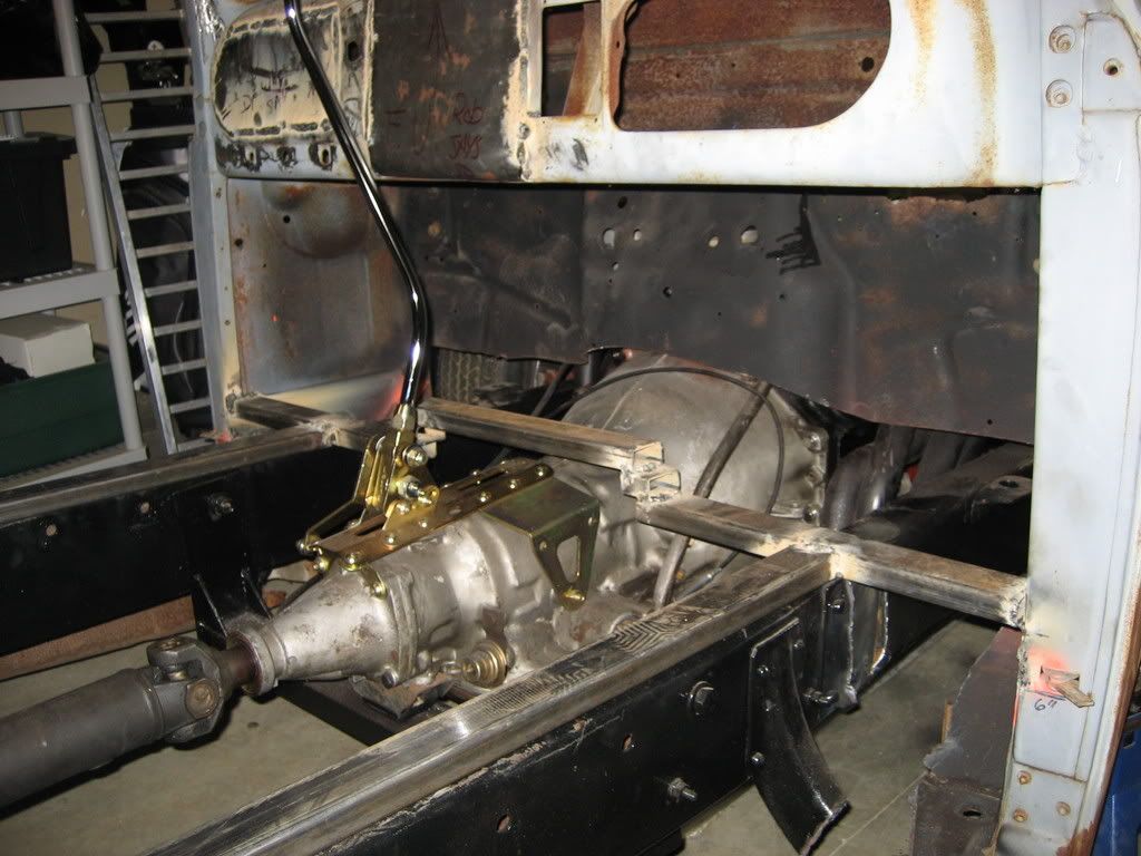

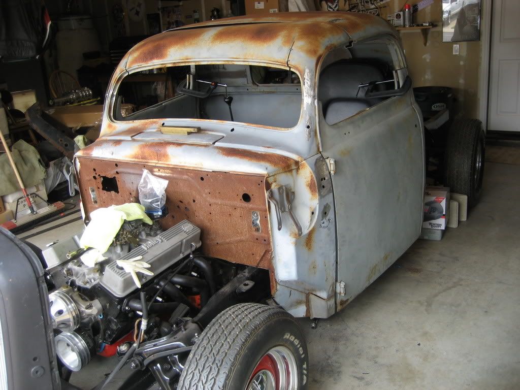

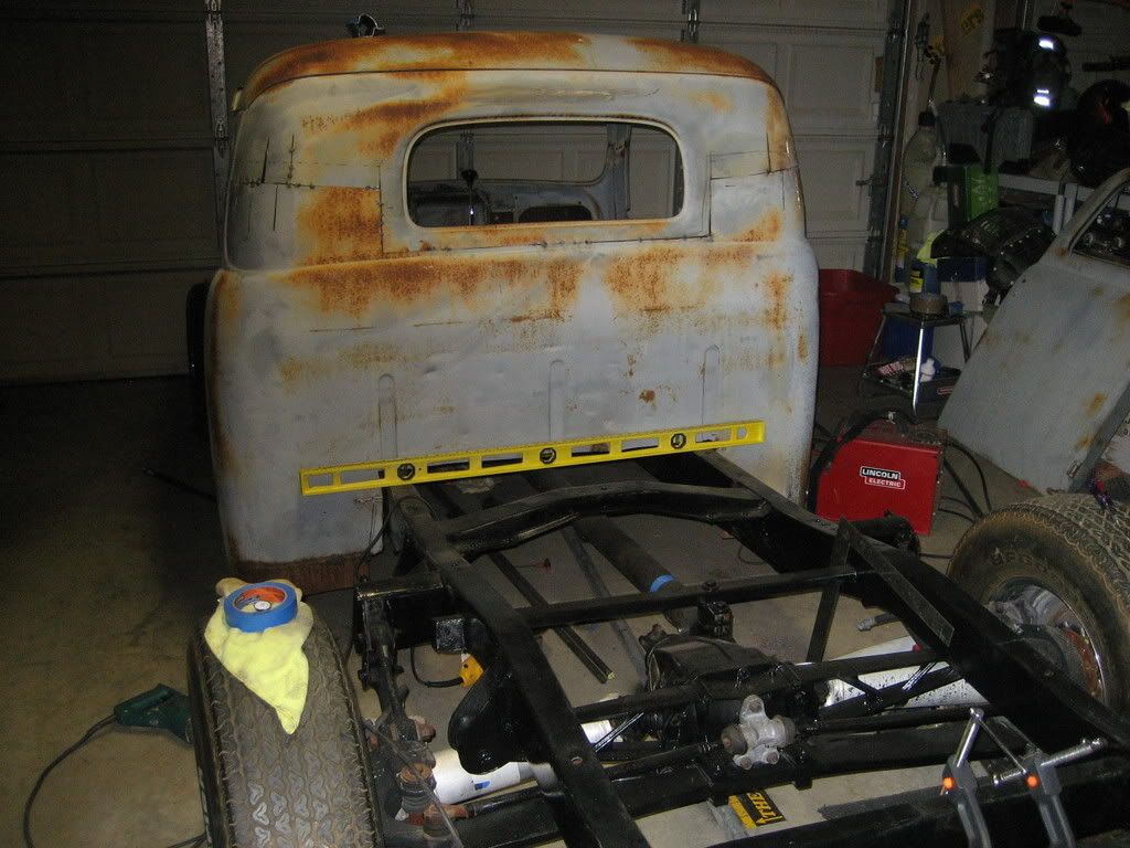

    I'll just post all the pictures to catch you guys up... The rest of the build is on Killbillet...

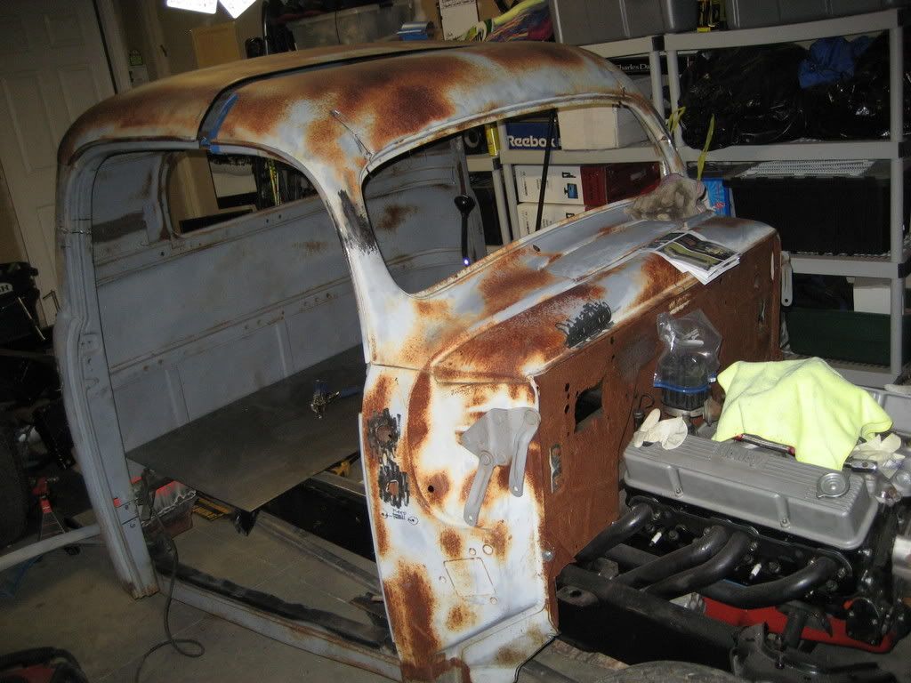

    its got a '92 vette rearend in it and a Volare' front clip 327 numbers correct vette motor and a th350. A buddy of mine did the suspension work and frenched the K member in like it was supposed to be there

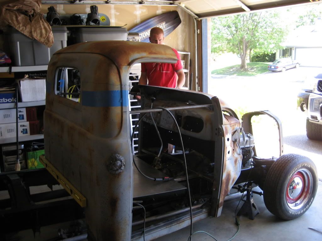

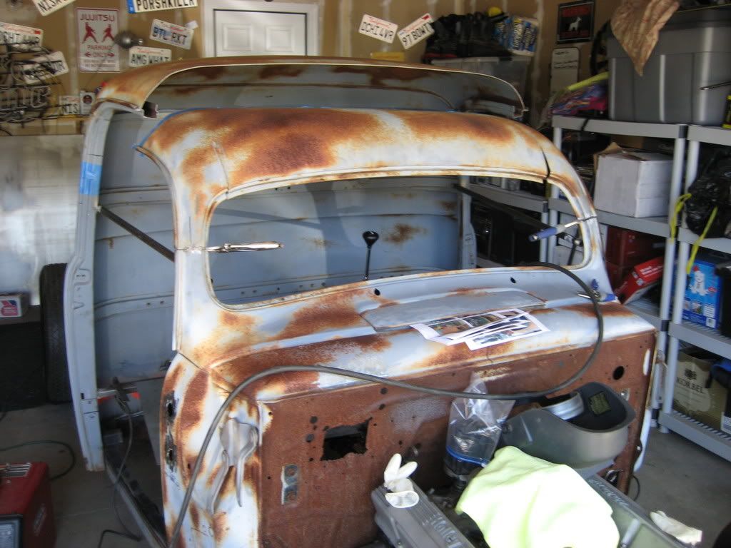

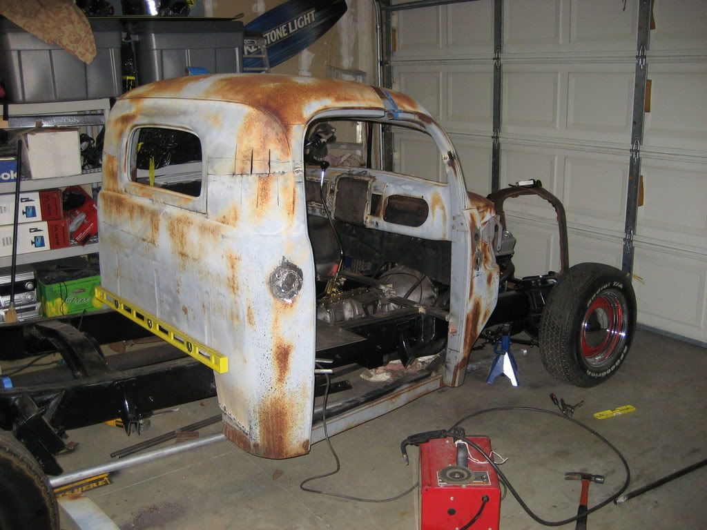

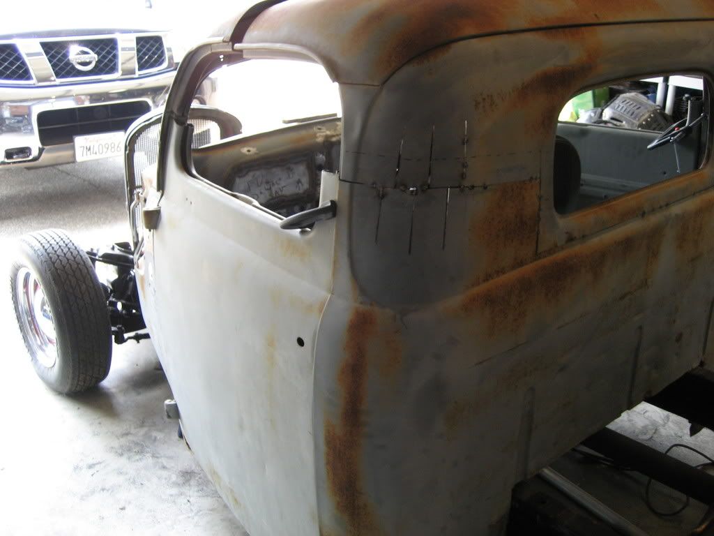

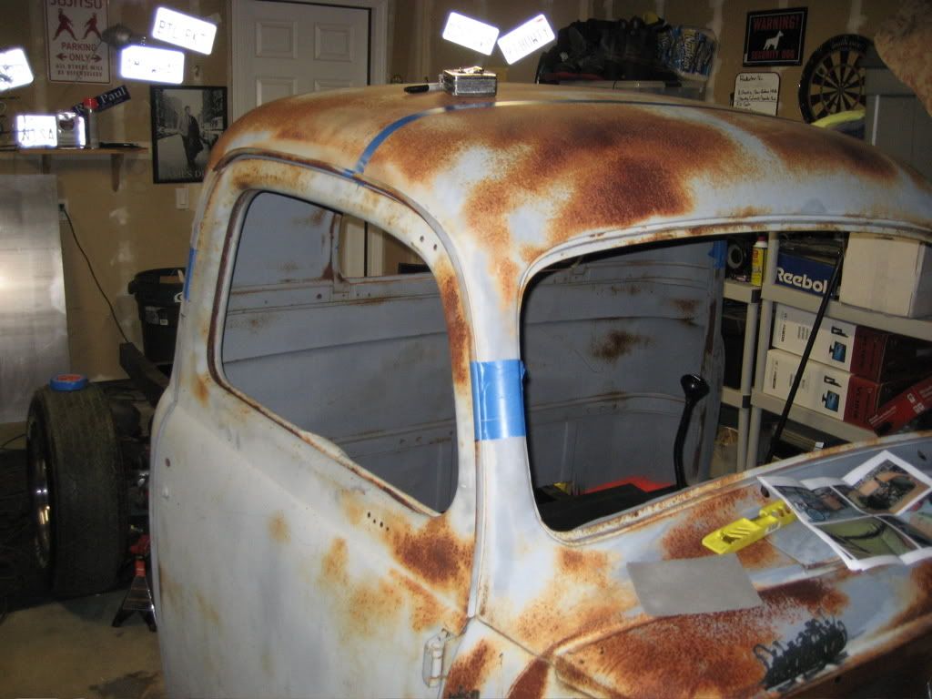

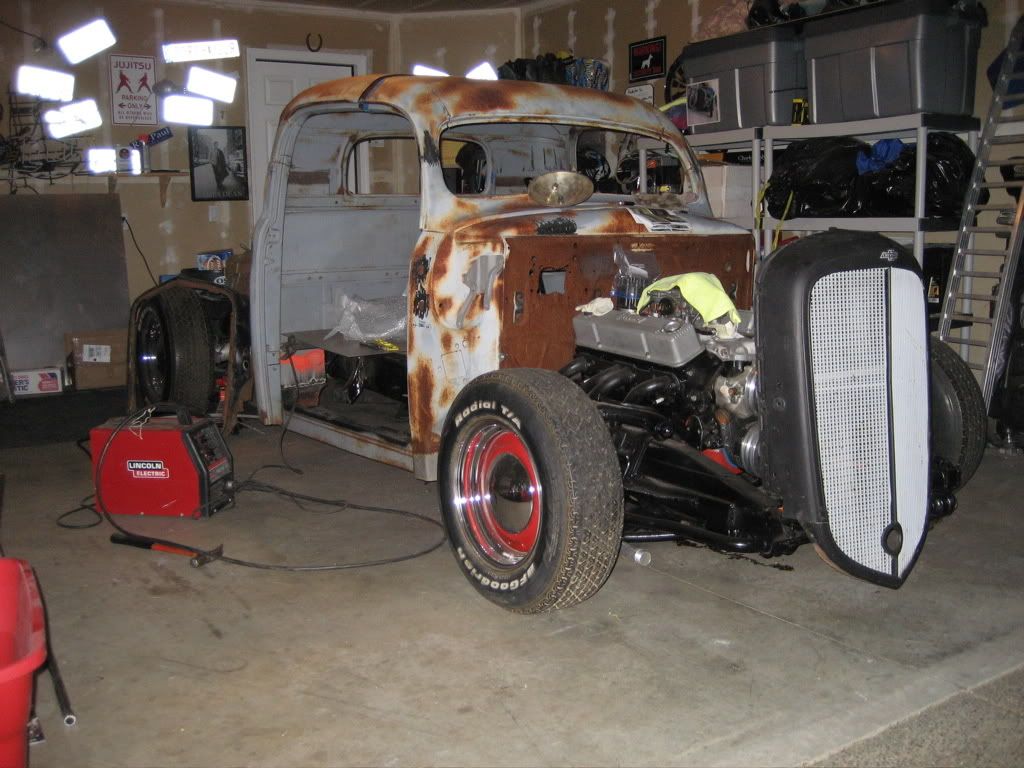

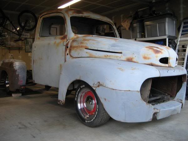

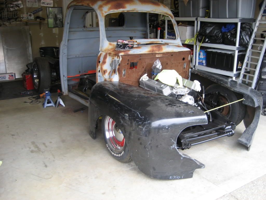

    I decided to go fenderless... The top pic is the most recent... I chopped the doors but no pics yet.
    Plans to Make a searing col. out of tubing with Press in bearings and 3/4 round stock, chop the bed and frame down 25"

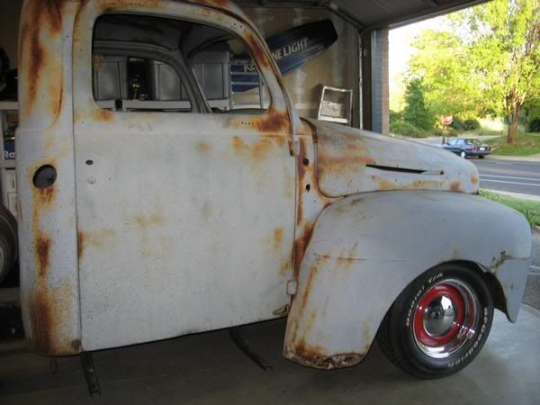

    Here's another one for reference:

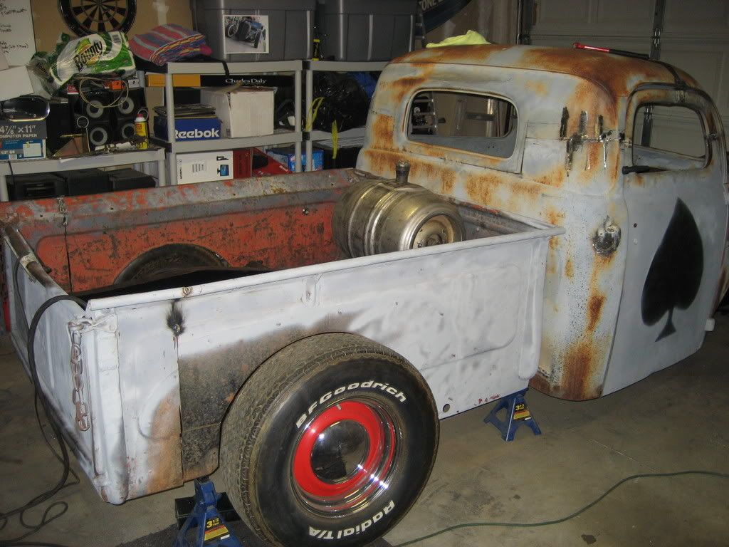

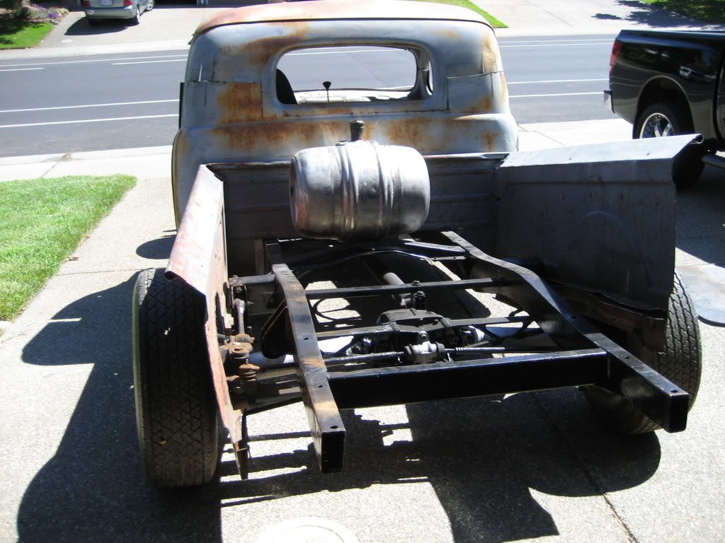

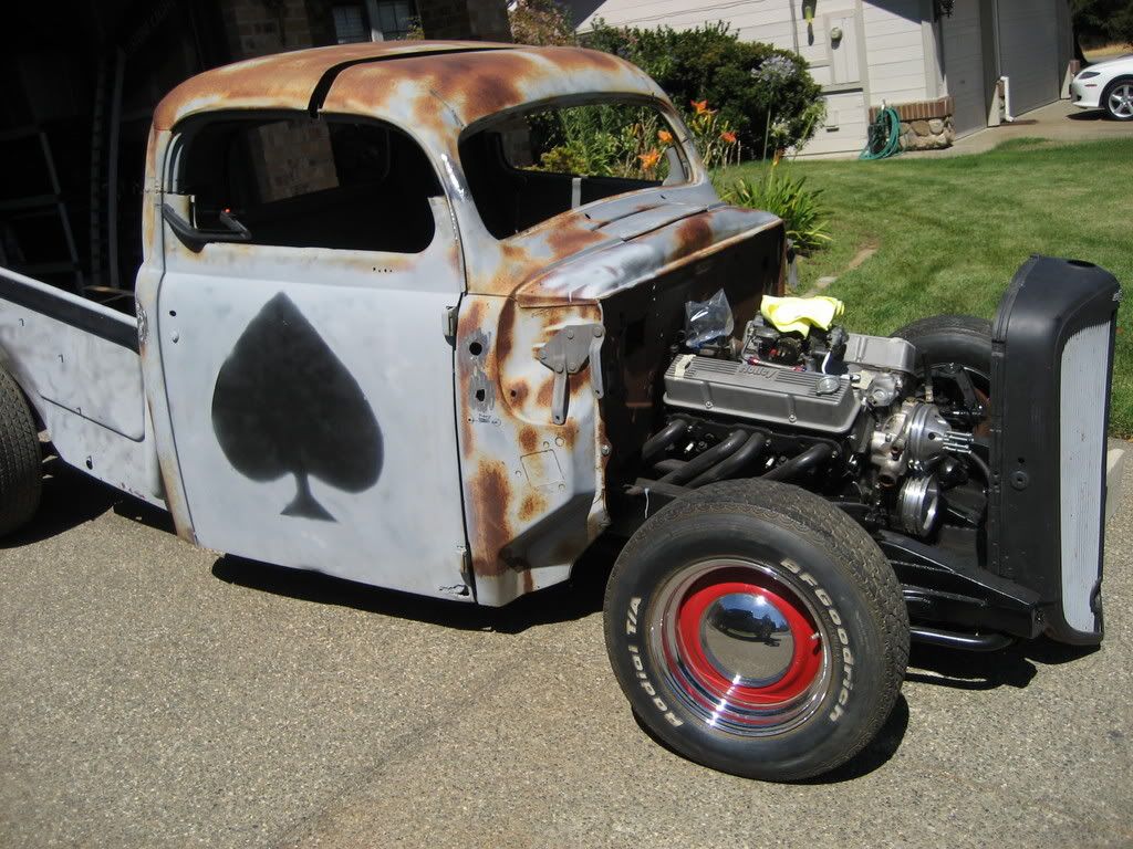

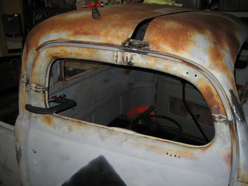

    Slowly getting there... Channeled the bed waiting on some money so i can buy metal for supports...

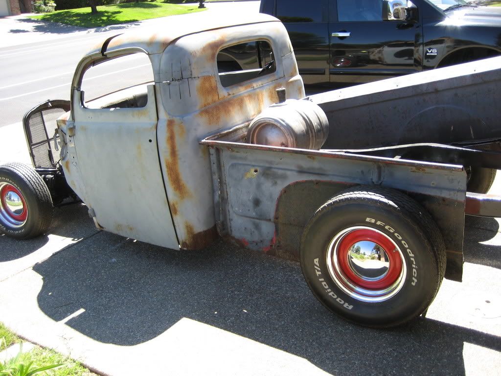

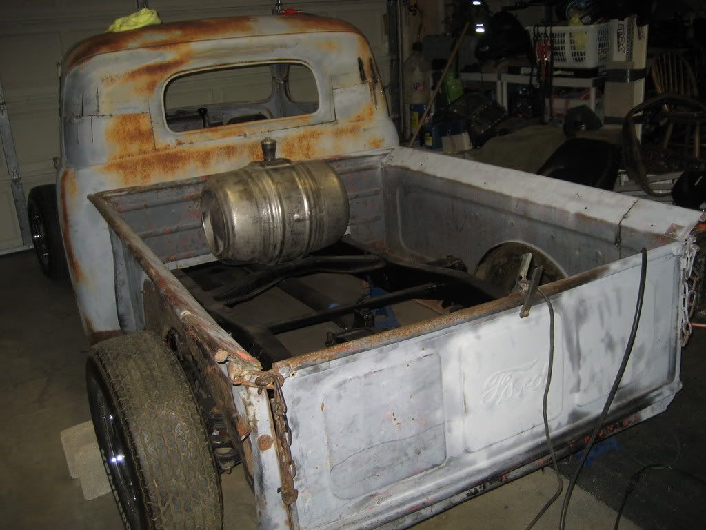

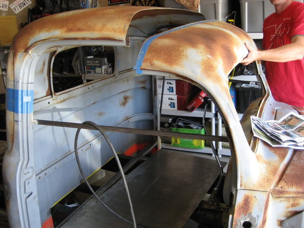

    After a long delay i got back to working yesterday and just when i got on a roll I broke my Sawz-all and burned through my last cutting disk... so this is as far as i got... Cut the bed floor out (wood and a sheet metal plate over it) chopped down and channeled the bed and cut out one wheel well.
    I need to get some square stock and weld in the bed floor next...

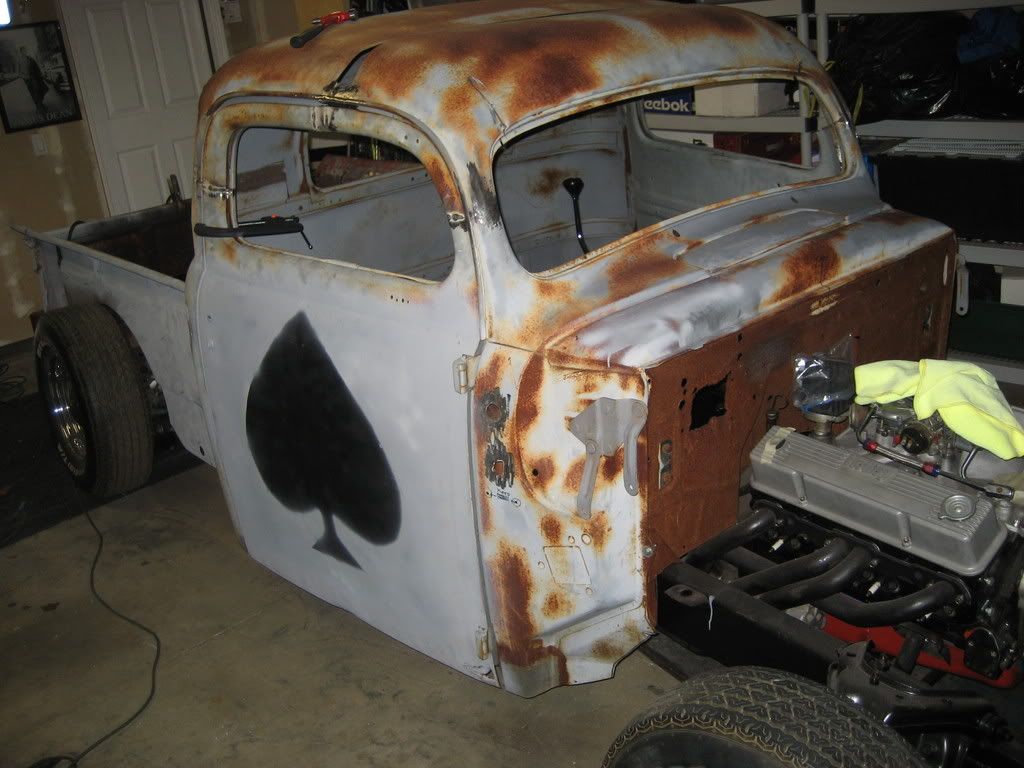

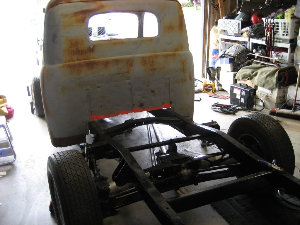

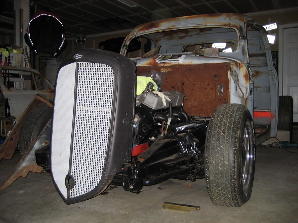

    Did some more work on it this weekend...
    I'd like to Z the frame right behind the Cab and take another 10" out of the bed but its gonna have to wait till after it gets running.
