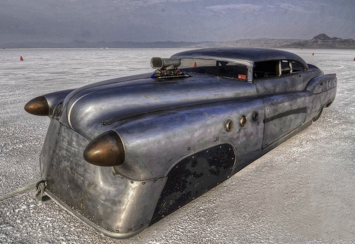

    I have a couple more straight eights on the way! The prettier one is a rebuilt 263ci with what appears to be a "home made" intake/exhaust topped with a 4 barrel edelbrock carb, electronic ignition, gm alternator, a bendensens adapter and a 700r4. Same setup I have now. The other is a dis***embled parts motor. I'd like to pull the engine that's in the car now and freshen it up at some point. This would be a good replacement with that dual carb intake and a custom header. Best part is I bought both of these motors for less than I paid for the adapter and transmission I already have. Wish I woulda found this 6 months ago!
    Since I'll have 3 of these maybe I can build a hot rod around one! This is pretty sweet...
