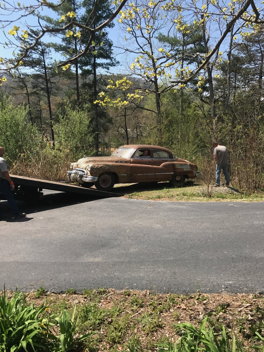

    Posts: 1
    Ialone
    IMG_3739.JPG Found this thread and love the way the car is coming along. Just picked up a '50 Special last weekend. Been chomping at the bit to get started.
