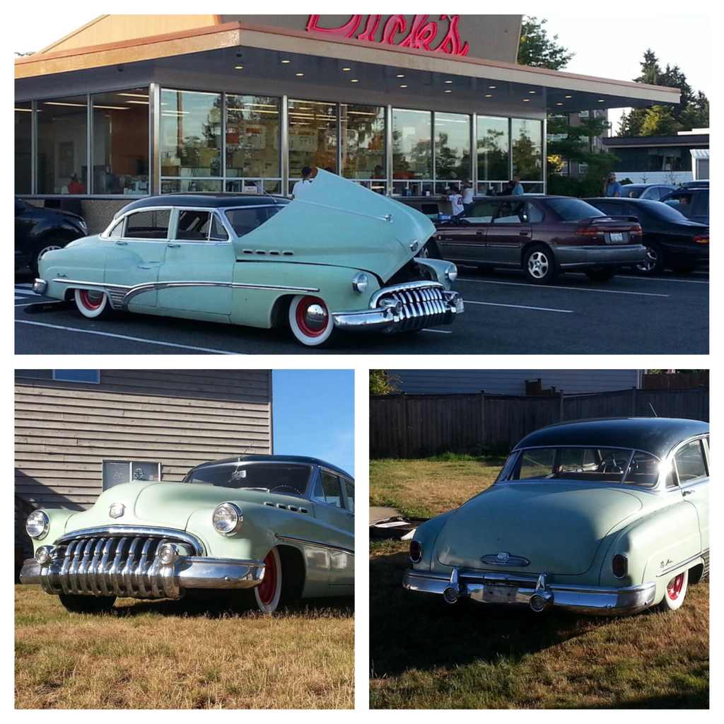

Just a quick update. I was going to have the original wheels sandblasted so I could powdercoat them but as we started to blast one of the front wheels the inside of the rim was waaay to rusted and probably wasn't safe to ride on so I decided to ditch them. I called up Coker tire for a set of 15x6 5x5 smoothie steel wheels but they are back ordered to who knows when. I'm basically just waiting on parts to get here. The air ride kit should be here tomorrow if the tracking is right. Wheels are on back order. For simplicity sake I decided to replace the 'original' hard lines from the ps pump to resivor with braided line/an fittings so I'm waiting for those fittings to show up. The high pressure hoses from the pump to the steering box are done and installed. The oil Pan gasket, oil filter media, shop manuals, and a few others things are here from Bobs' Automobilia- great guy by the way. The tourque ball retainer seal kit is here from eBay- creekside2, also a very helpful guy. And the 2 1/2" dropped uprights are here via Fatmanfabrications - Very nice pieces. I'll post lots of pics when I get some stuff done. Also, I couldn't resist this.... Yes it's going to be on the stock frame/suspension. I'm going to try not to cut it up but it's going to need some work. I'll post tons of pics of the install. Thanks! I love everything about this car. I've been looking at that disc brake conversion.. Did you upgrade from the stock master cyl? AACA has been a big help, just checkin out the archives has answered almost all the questions I had. Thanks!

Started on the rear bag brackets after work. I've never messed with air suspension and there's no instruction manual for baggin a 64 yr old buick so I came up with this sophisticated blueprint and made a lot of changes as I went. One down 3 to go. With the axle on the bump stops as low as it will go (without any modification) there is 7 1/4" from the top spring plate to bottom plate on the axle. My spring cups are 2" tall to allow the bolts to drop and take everything apart if I have to. With both spring cups 2" and the bag fully compressed (has internal bump stops) is 3", that's 7" so I don't think I'll have any issues there. I don't want it to lay frame. I want to cruise the **** out of this car and if there is a failure I want to be able to get it back without s****ing the whole way. If it's not low enough I can always build new lower spring cups and cut everything up.

Rear bags are in. I decided to remove the larger bump stops and made my bottom spring cups 1" tall instead of 2". Should be nice and low now. Still plenty of clearance for the torque tube
My '50 Buick Special Sedanette rear fenders would not let 235-75-15 tires slip up into place. Not enough room between bodywork and brake drum.
We got the buick up on the lift. I replaced the torque ball retainer, gaskets, shims, and mount. What a pain in the ***! Now I know why the previous owners just let it leak. I didn't take a bunch of pics because it was taking long enough already. The torque ball and inner retainer had some scratches so I polished them up with scotch bright pad. After about and hour a piece I was able to get most of the groves out and a nice polished look. The old paper gaskets were mummified to that inner retainer so it took a wire wheel to get that off and then alot of polishing. Anyway it's all back together with new fluid and no leaks so far!
