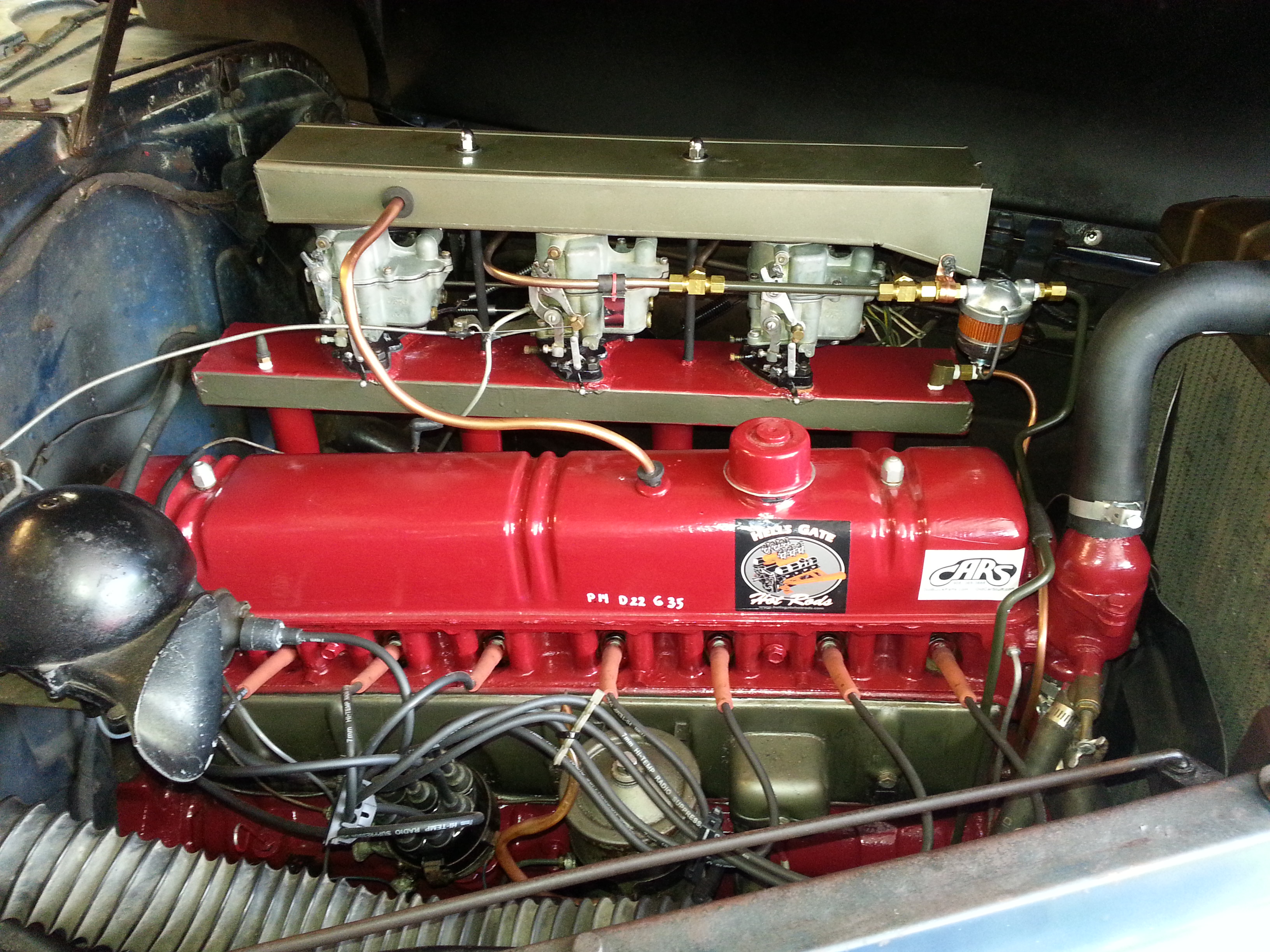

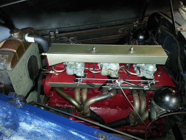

    Great looking Buick!! On my old 52 I ran the 41 intake and exhaust set up and ran the exhaust true duals. Sounded great too. There are a couple of videos I posted on youtube . One of the engine detail and another of the car running for a sound bite on the Smitty glasspacks. The left motor mount modification was very easy too.

    Yes I patterned out the holes from the left side and used a plasma cutter to cut the holes on the X member on the right side.. Also mine is a dynaaflow and to allow room for the pipe run back I eliminated the OE trans cooler on the side of the trans and just ran a universal on in from of the radiator. As for the Right pipe, as it dumped out of the manifold it turned and went forward to the lowest part of the oil pan than cut over to the passenger side. I spent over an hour with the guys at the muffler shop mapping out the whole system, plus since I was air bagged we had to make sure everything had clearence thru all suspension travel.. Here is a youtube video that shows more of the pipe work.

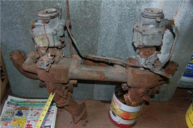

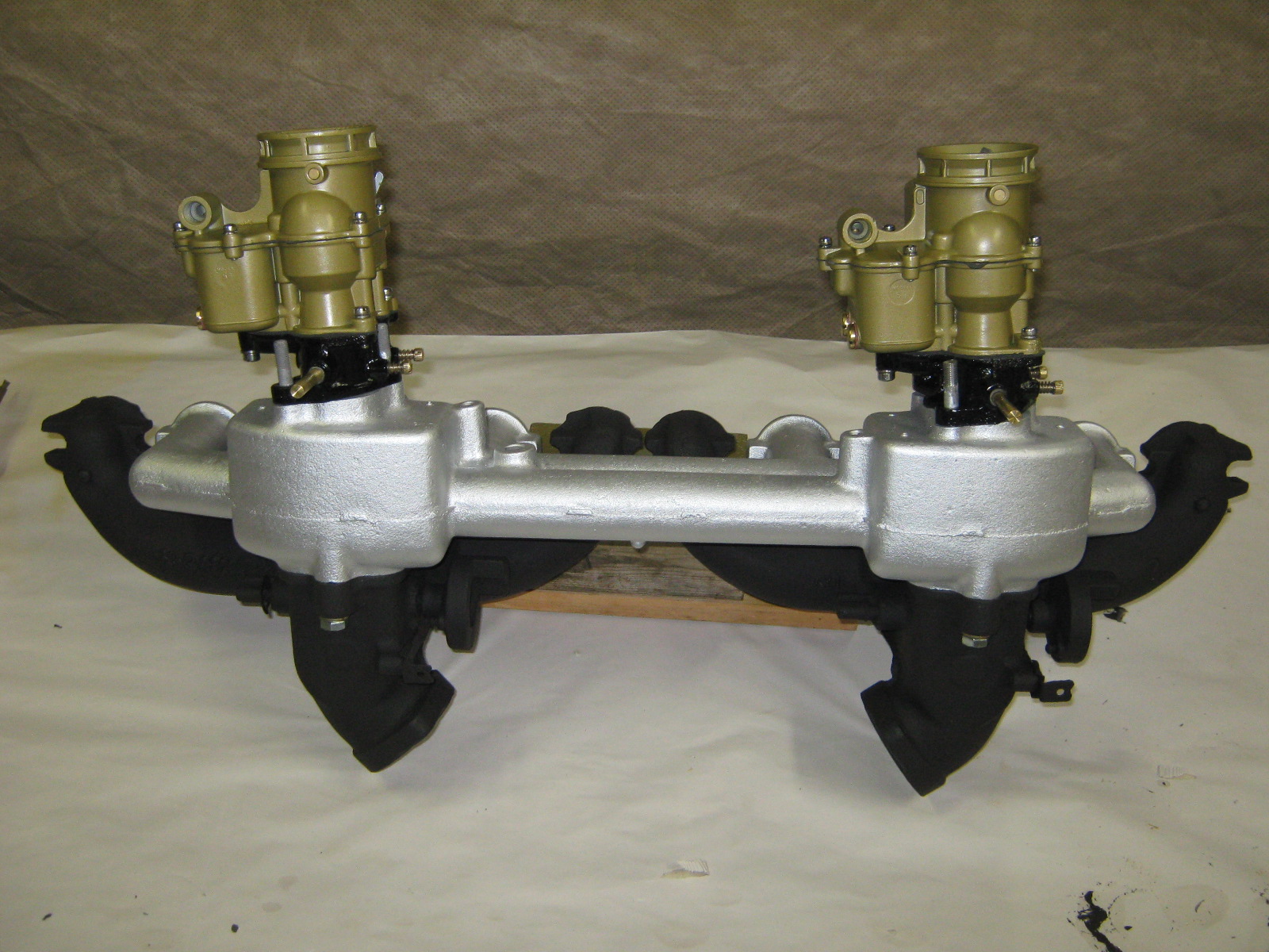

    here is the before and after of the intake/exhaust system. I purchased it from a man who found it in a barn. I ditch the stromberg carbs in favor of Holley 59's off a flat head ford, they bolted right up!.
