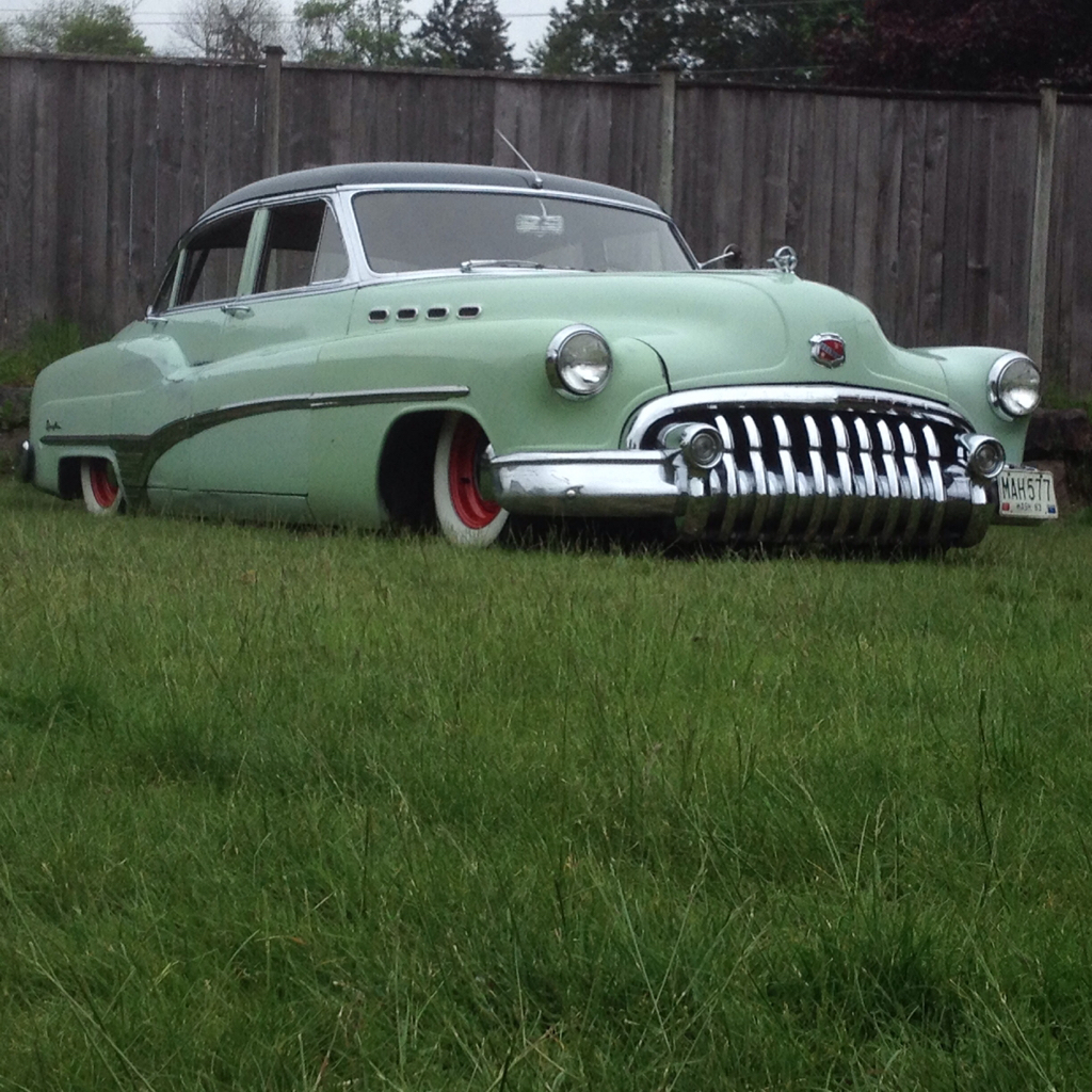

Congrats on getting her road worthy and being able to show it off. How's that Dyna-slow treating you??? Is it marking its territory. lol
Haha thanks, the dynaslow is treating me pretty well.. It's having some trouble staying in park but other than that it's doing what it's supposed to do. I've fixed all of the trans leaks and a few oil leaks from the engine but the rear main seal is leaking now... That's gonna be a fun one to stop up. I just want to cruise it for awhile. I don't mind it marking its territory enough to mess with the rear main seal right now.
Temporarily, you could duct tape a folded up piece of oil soaky pad to the bottom of the bell housing to catch the territory markers. Better yet, make a little tin tray that goes under a couple bell housing bolts so you can just slip out the wet one and slide a dry one in it's place. Usually easy enough to find a curb ramp to park on that will give you several inches more clearance under the middle of the car. A rolled up piece of carpet runner will give you a clean place to slide under on. Don't forget to take along a block to chock the wheels if your park pawl is slipping. Way cool car. A clean smooth chop would really make it ***y.
Man what a sweet ride! I can't get enough of the front end and the grille on this beast. Bad *** ride my brother.
The probable reason it won't stay in park is the rear transmission mount. On the early Buick they come apart on a regular basis. you can purchase another from Bob's Automobilia or just adapt it to another type of mount. I use one for a Turbo 400.
@CHUCK50DODGE & @knucklepower Gracias! @Crazyolman I replaced the rear mount when I did the torque ball retainer and seals. I've read that the linkage can sometimes be adjusted to correct the issue. I'm not quite sure how to adjust it for this Sometimes it will stay in park but most of the time it slips. I just use the parking brake and lay it out when I park.
Man this thread has got me to wanting a 50 again. Almost traded a 54 for one once (almost....). Could be the parking pawl, broke or worn. Have you tried unhooking the linkage to see if it will go into gears. If so then maybe the linkage does need adjusting which is just hit and miss until you hit the sweet spot. Also are you sure when you replaced the rear mount that the ****** was lined up well?
