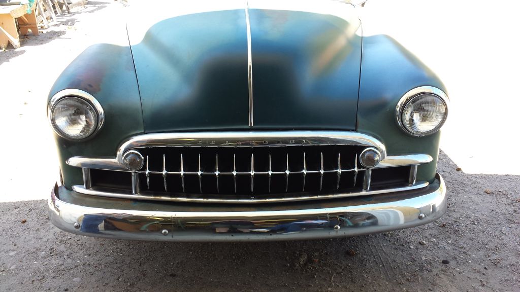

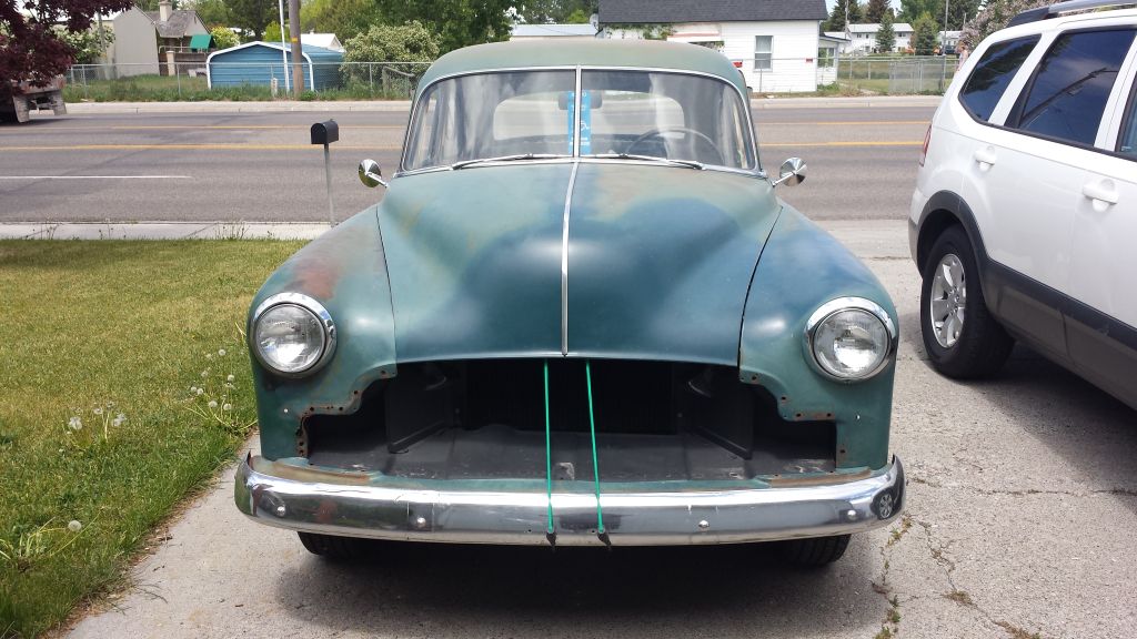

    Here's the front with the rust I need to fix before I pit the grill back in.

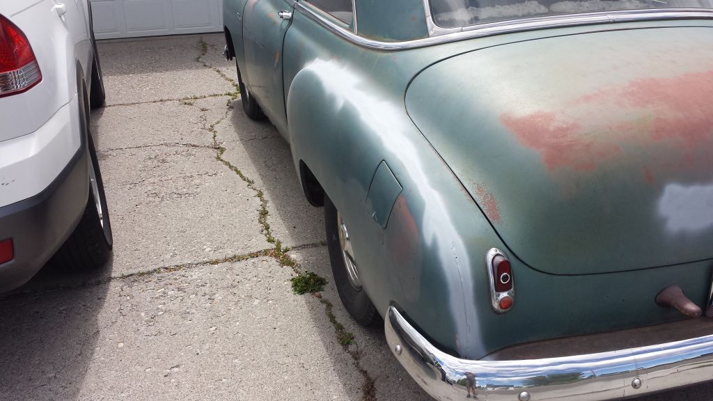

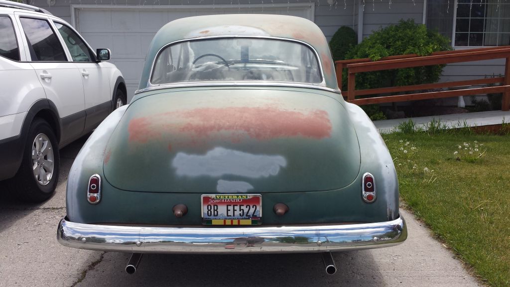

    Look Ma, no trunk holes. Paul welded them up for me. No bondo yet. Lower pics show the fenders and fill that needs to be done. Threw on quick spray of primer to cover the bare metal.

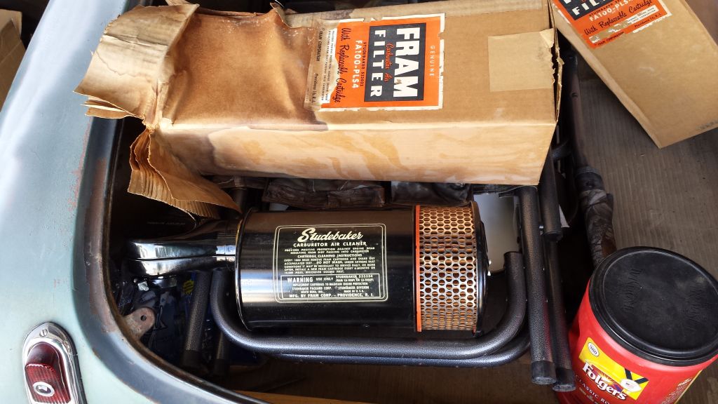

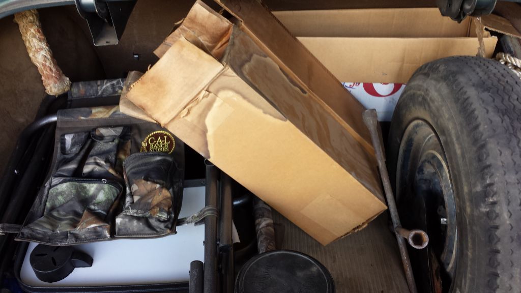

    LOOK! Up on the top shelf! Behind the box of old carbs and the worn out cheater slicks! Could it be?....Could it possibly be?...
    Yes, it is! SCORE!,,, SCORE TWICE! N.O.S. hiding up there since the 50's. Just waiting for the right 50 Chebby to come along.
    Jumped right into my trunk! Won't be hiding much longer :) These tuner kids have no idea what real N.O.S. is LOL

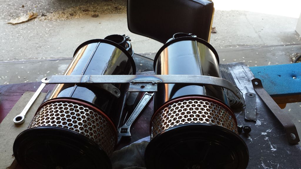

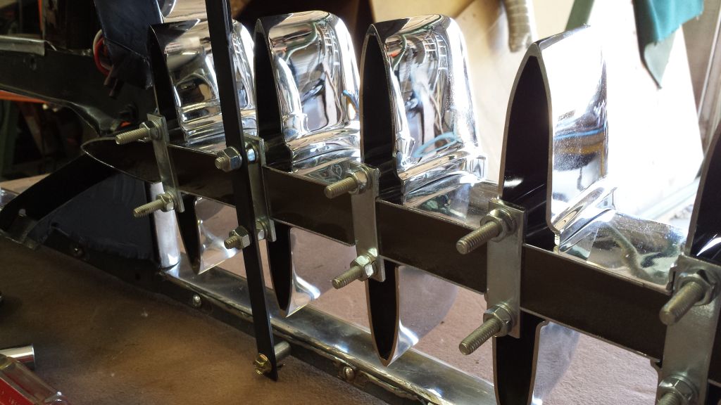

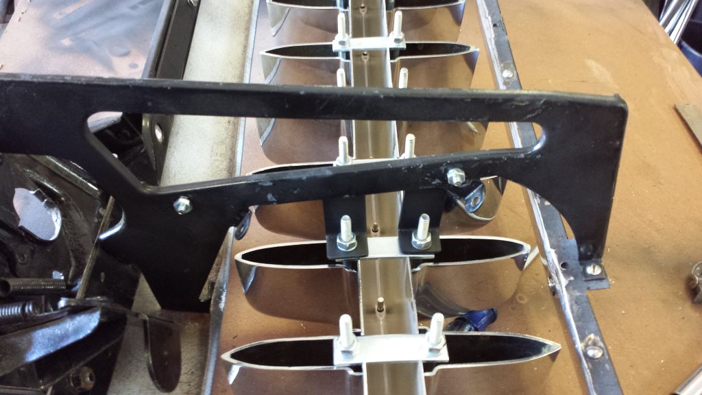

    A little fab work to make a bracket to connect those holes near the bottom to the bolt that holds the coil to the block and a pair of short pipe extensions to clear the valve cover& connect to those model B carbs and away we go. No more lubricating the engine with bugs!

    Final mock up. Almost there. Fun day today.

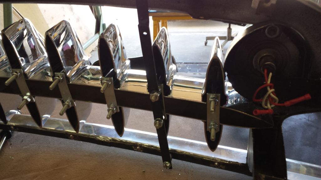

    And finally, no more bungie cord holding the hood down. Didn't show the 1/8" by 1/2" stiffening strap on the back side of the center bracket. Parts from a 49 Chev, 50 Chev and early Vette in this grill. Off to Cruise Night.

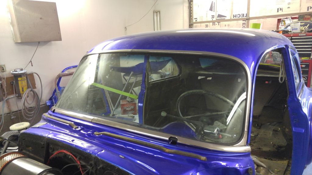

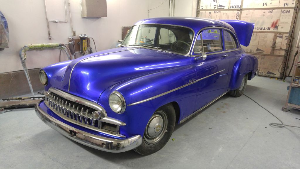

    As of this afternoon. Weather here in east Idaho telling us summer Cruise Night season is over. Time to continue on the car. 1 piece Olds windshield when this gets back together. Can't prep or paint anymore due to asbestos in lungs so Adrian Beezer is shooting this for me. Seems dark Cobalt blue is the new silver or refrigerator white for 2017 with all the car companies so I did Cobalt Kandy over Orion Silver so it wouldn't be mistaken for a new Toyota Corolla or Chevy pickup. I'm feeling Blue :}
    Parts start going ON the car instead of OFF the car soon...

    Starting to go back together. Pulled the seats to take to the upholsterer and snapped a couple shots.

    1 piece Olds type windshield is in.
