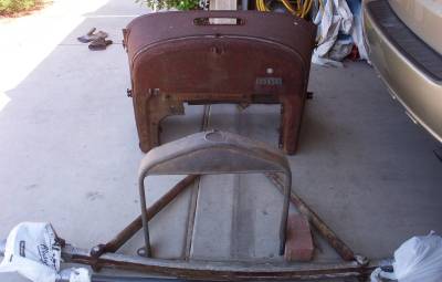

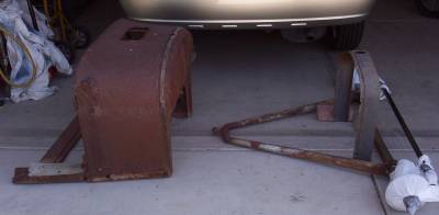

    Here is what I picked up for $50 today. Basically, a 26-27 rpu cowl, dash panel and original grill shell with Ford script. No major rust, no bullet holes and no dents. The front axle was not part of this deal; however, It ended up being free after I finished selling all the stuff from it I did not need.

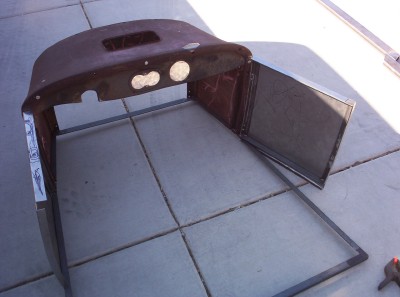

    I will make my own subframe since the back of this one is missing. My plan is to get the roadster pickup back section from Macs and then fab my own side sections since I want to make this a little longer than the original for more room. Are there modern day doors that I can use as sheet metal donors with the same curavture? I heard that beetle doors work for the model A, how about for the model T? I know I can get original sheet metal door skins, however, want to make it a little longer than original.

    Exactly what I was thinking. Making my own square tube sub frame and channeling it 2". The frame will be a custom job by me using square tubing.

    heres how I did mine after I skinned it I cut the tackwelds out that held the door frames

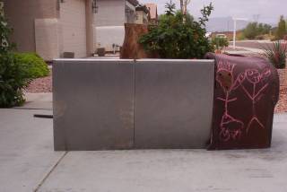

    What do you guys think? Seems too long to me. How about taking 5" off the back?

    Sorry forgot to mention this, I am building a rpu so I would prefer not to have a sloping line in back. The panels are c cab rear quarters from Howells. Pretty good quality for the price. I as write this, I am working on the sub frame. The more I look at it, it needs to be 5 inches shorter. Ths would also make it slightly longer than the fiberglass t bodies.

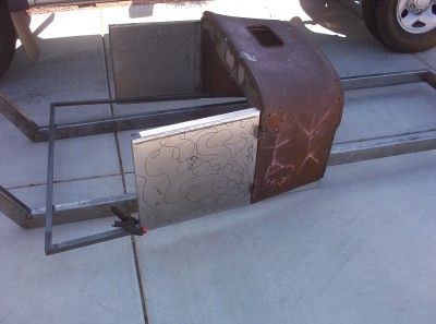

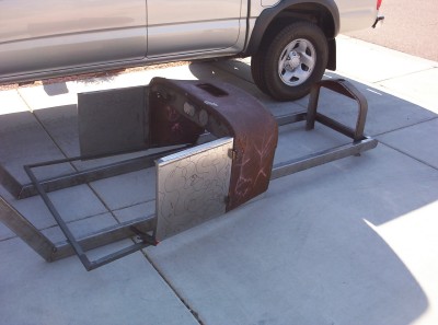

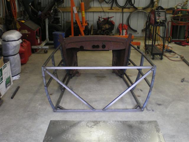

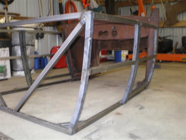

    I have not had the chance to work on my project for a while since I was training for the San Deigo marathon. Now that is over, and the next marathon isn't for another 6 months, I figured I get some work done. I removed all the old rusted subframe and built a new one;cut the firewall , filled all the extra holes in the dash and even built the aluminum back panels for the gauges, built the passenger door and hung it and started on the drivers side panels. I also built the frame which is Zeed in the front. The Z is in the cowl area so you will not see it. Took a whole day to weld the frame and get all the members level and square. The kick up in the back still needs to be trimmed; however, I will do that once I get an axle and tires so that I can get the stance correct. I also did a mockup using some old bike tires. Here are some pictures:
