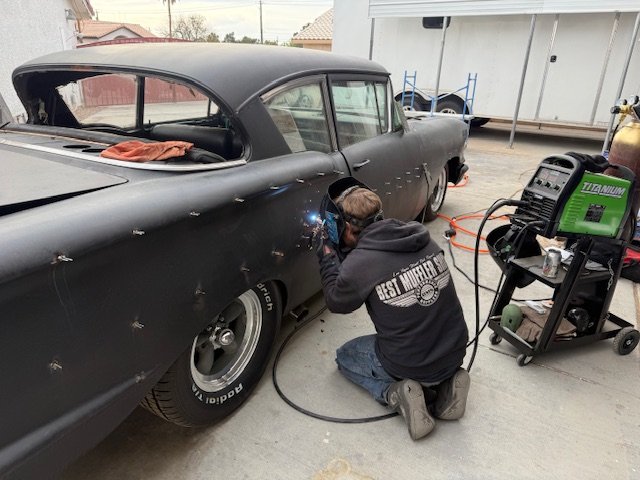

    So, got the welder out and a box of nails... I use the roofing nails to weld the holes of to have a more finished look on the inside and it uses less heat. nice filler... those are big panels and last thing you wanna do is warp them...

    so we get that done...every hole welded... then went back and ground them smooth... and she sat...at the cars and coffee in vegas... Met a guy Darwin Homes....maybe some here know him... he's from the modesto area... ties to drag racing.. custom car builder, worked with windfield and such... wants to come over and look at my cars.... were sitting on the porch, he says whatcha doing with that 58...?? I say ...I gotta strip it and finish the metal work, then paint it satin black....... he says I'll help you get it done.....hell yeah...so I did a chemical power wash...
