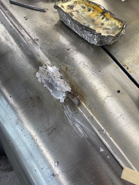

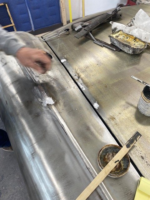

    went to cars and coffee.....met this guy.... custom painter....we were sitting out on the patio.... he see's the 58, says why don't you just let me finish the body work and put some good Matrics primer....So the deal was... finish all the body work and block it to 80 grit, and just leave ot a satin finish car.... so I easy offed the paint and took iit to him to do....I'm a , I hate to pay some one to do what I can do myself guy.....so real hard..... but I did it.... IMG_4926.jpg IMG_4927.jpg IMG_4928.jpg IMG_7668.jpg

    IMG_7670.jpg IMG_7671.jpg 6525382778666144973.JPG the guy stripped the rest with a metal prep tool... what ever they call the barrel sander and did some lead work on a couple spots.... no bondo in this car...
