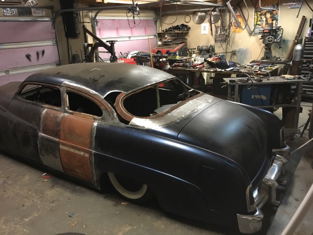

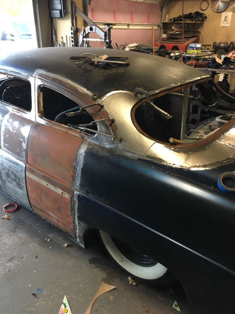

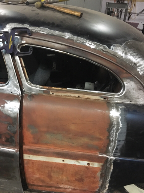

    So next. Finished up the roof. Chopped the wind wings. Modified all garnish moldings. And making the stainless fit a 2 door. I will probably make new ones from scratch at some point. Not real happy with them. Now we are up to date.

    How are you bending those stainless window moldings? I know you said you weren't real happy with them but I'm wondering how to do it. I've collected a ****pile of them for my '51 but I'm not real sure what the best way to reshape them would be. If I chop the car I have to know how I'll deal with those before I start cutting.
    Also, how did you do your vent wings? Did you heat and re-bend, or cut and weld?
    Would love to hear more tech details there, even if I'm just learning what doesn't work. The car looks really good.

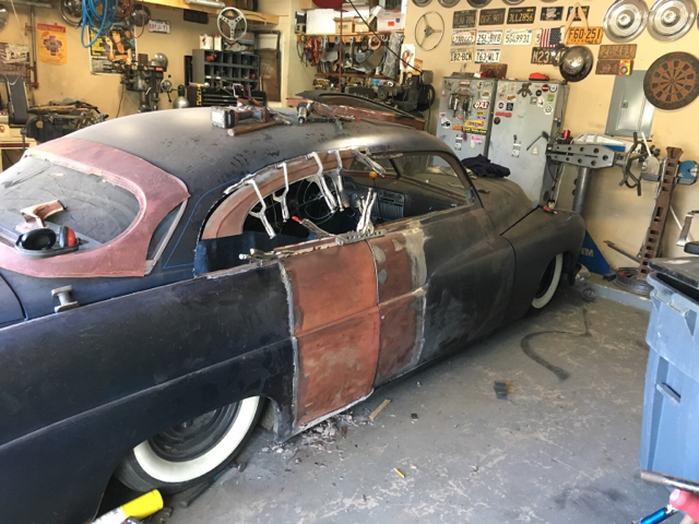

  3. The vent wings were fairly easy. First you need to dis***emble them. The make a buck for shape you want. Heat them up to a dull red where the bend needs to start. Then start bending. The just chase the heat up the as you bend it. Trim and re polish. The stainless trim. Cut little reliefs on the back. Heat and ben. Welding ****s. I had to make a copper tube to go inside so I could control it. Super thin.
    If anyone has a extra p***enger wind wing upper pivot I need one. [​IMG][​IMG]

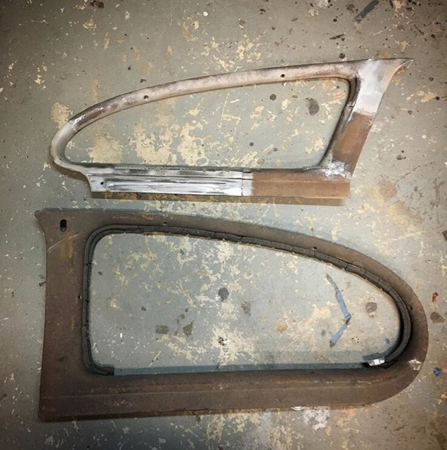

    I came across this wonderful work a few months ago. I was secretly wishing it would go away. Now it's time to address it. Little rust little br*** A Lot of bondo. it's all there. I debated on whether or not to buy new quarter panels when I started this. I decided against it as there were kind of pricey. I feel like it would've been smart. I came across this little gem today on A back road. [​IMG]
