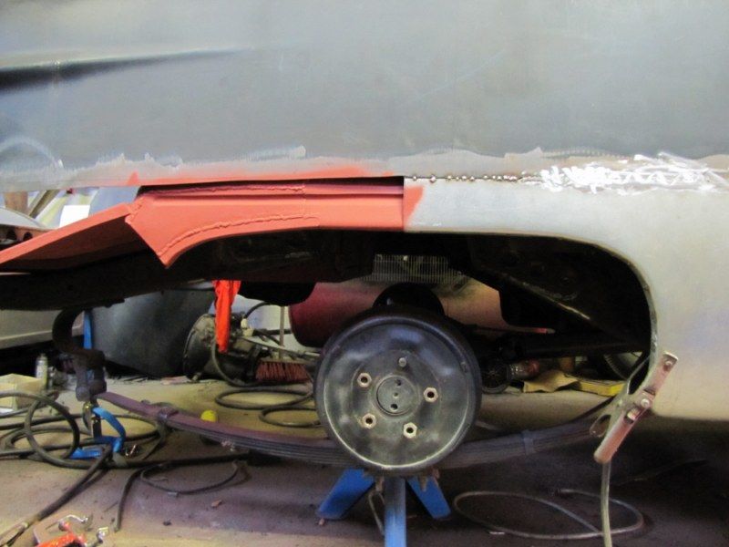

    Here is a little update:
    The inner fender was a bit pitted from the rear,so i decided to fix it too:
    I welded the last missing quarter panel i got at last week.There was a little wrinkle on the wheel opening corner and i had to hammer it a bit before welding,otherwise it was pretty good:
    Now i have to pull it out of the garage,turn it around and push it back to the garage,so i can start working with the drivers side.I think i'll grind all the bondo off from the drivers side when its out,no need to dust the garage with that stuff.

    It's still great to see you're doing a great restoration/build with no stones unturned. Well done! I love the fact that you're tackling the areas that will never be seen again by others, and you know it was done properly. Respect.

    Well,i guess only reason to fix those unseen spots is that i dont want to re-do same things after few yrs.If i see thin,pitted piece of **** that use to be solid metal decades ago,i dont give any mercy for that.
    This side was fun to do,too bad i cant say same thing about the drivers side.
