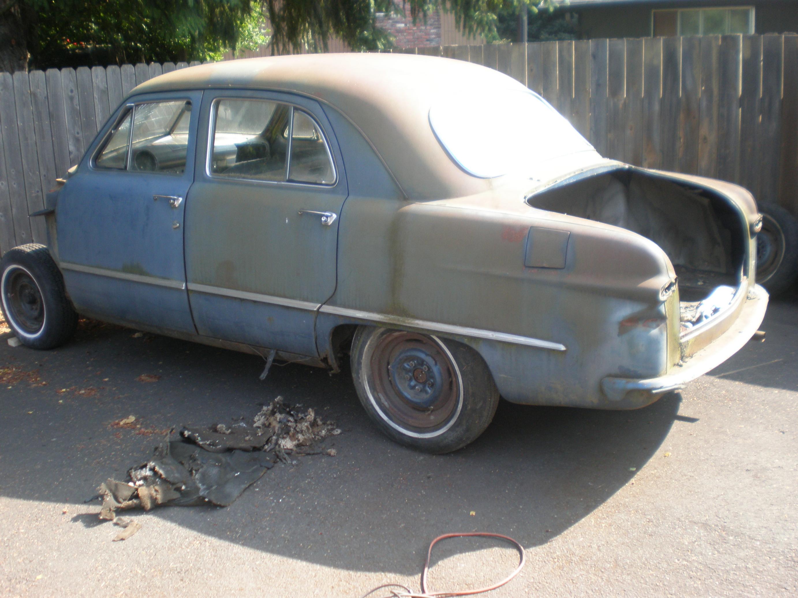

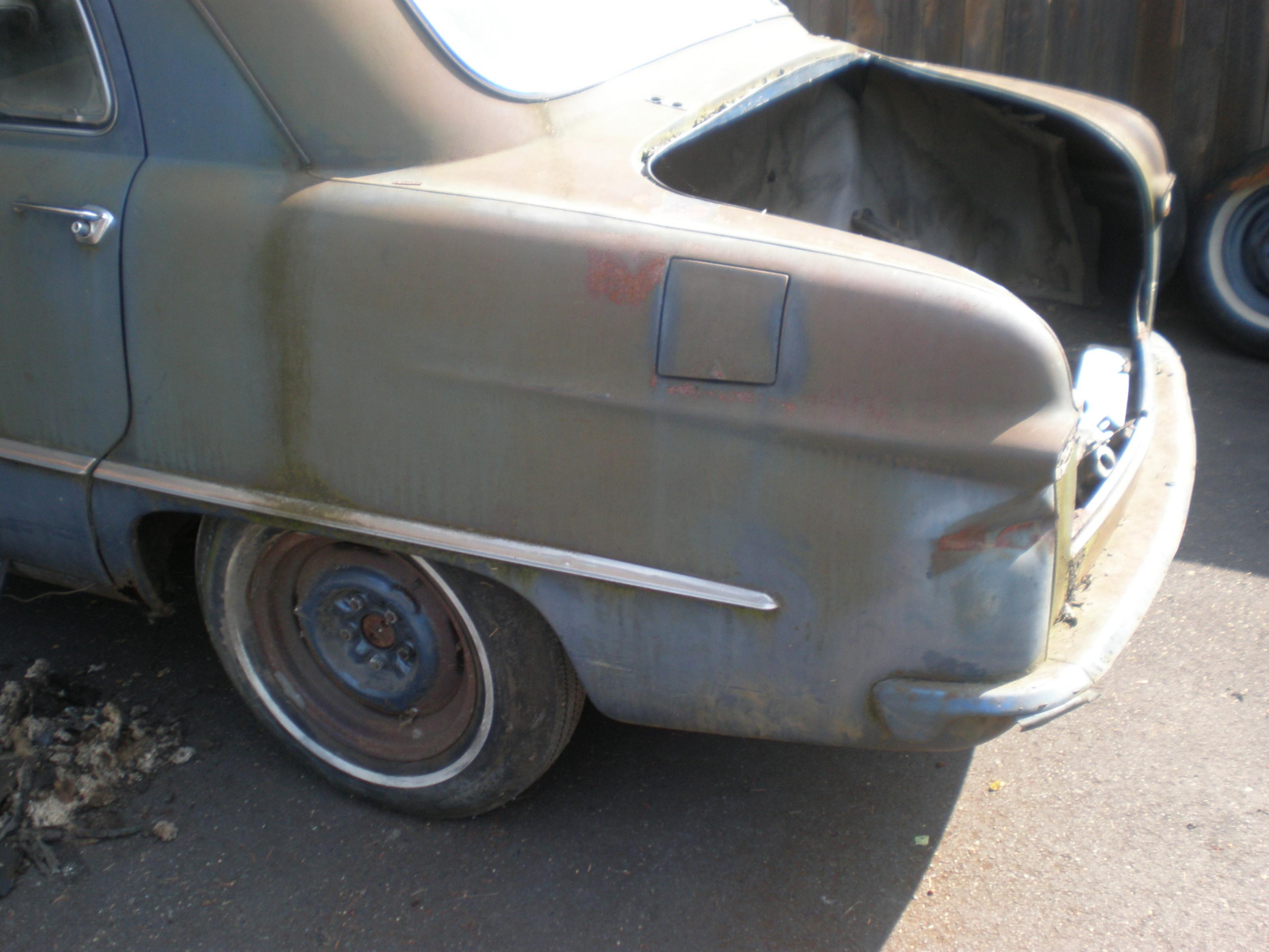

    Hi Finn - Sorry about the delay in getting these pictures. Here is a picture of the new parts car, and the quarter panel I have for you. The rear part by the light is banged in, but the rest of the quarter is in great shape. Just let me know if this will work for you, and I will get it cut out and shipped this week. Do you need any other parts?
  27. Finnrodder
    Joined: Oct 18, 2009
    Posts: 2,970
    Finnrodder
    from Finland
    No problem,that looks like a good donor piece.I think that dent isnt a big problem,it should be easier to hammer it up when its cut off from the car.
    Friend of mine owns a planishing hammer,that might be handy with the dent..
    Actually there is something i need,i'll hit you a pm about that.
    And big thank you for taking your time with the donor piece!
