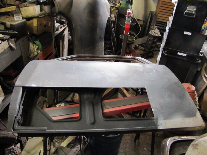

  20. Finnrodder
    Joined: Oct 18, 2009
    Posts: 2,971
    Finnrodder
    from Finland
    Thanks!
    That looks pretty cool ride.
    Thanks man.
    I've done some progress,but i havent updated this thread for a while.
    I got the corner piece done and repaired the inner structure too for the door.
    The corner patch was curvy in 2 direction and shrinker/stretcher was good tool for that job.
    Now i am working with the skin patch,i've done most of the welding but i have to do some dolly/hammer job.There was a slight dent on the top of the door skin and that caused a little oil canning,so there will be some job to do...

  23. Finnrodder
    Posts: 2,971
    Finnrodder
    from Finland
    Thanks Carsten,i guess i can figure that door mess out.Thats an old pic taken in Florida few yrs ago,nowadays i look like something between santa claus and caveman:D
    Yeah,thats really annoying thing.There was a slight dent what causes that oil canning.It was hard to spot,that door skin looks pretty decent in that pic.
    But hammering and shrinking disc helped with the oil canning.Now i have to hammer/pull the rest of that dent out.
    Its just pretty nasty place to hammer it out because the door frame is on the way.I think i borrow a stud welder from friends of mine.They are two brothers who have an autobodyshop.I think i have to borrow it at weekend,after working hrs.Its good to have 40 yrs old friends,who have been in industry over 20 yrs.Those guys knows their ****:D

  25. Finnrodder
    Posts: 2,971
    Finnrodder
    from Finland
    Well,that wasnt a big success.I had to start it all over,the dent that was above the patch area just turned the whole skin something that military persons in states call FUBAR.
    Sometimes things just wont go like in the movies,but thats just sheetmetal.Not end of the world..
