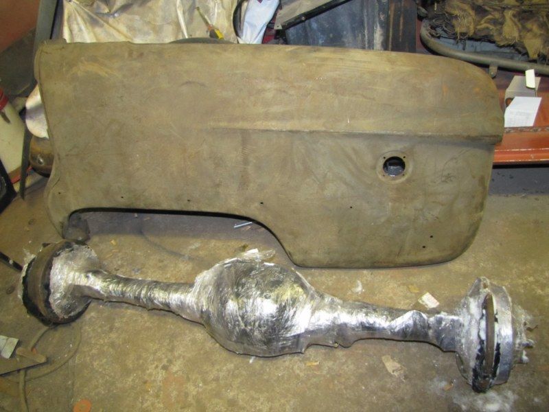

    While i was at the work at today,these were delivered to my home:
    So i got my christmas presents few days earlier at this year.
    Thats a NOS 4 door quarter panel and 5 slug Maverick rear end.I bought them awhile ago and friend of mine from Ohio,Harry,picked them up for me and sent them to my shipper.So,big thank you Harry!.
    Those will solve a lot of my problems with this project.Especially that quarter panel,i guess thats a cure for the quarter panel hell.I like to thank msalamanca too for keeping his eyes open with Maverick rear.Its good that there is guys like them.
    Es***Coupe was going to send the quarter panel for me,but he disappeared like a fart in the Sahara desert.I havent hear from him for a long time.Well,i dont blame him.Sometimes life can come on the way.I hope everything is fine with him.
