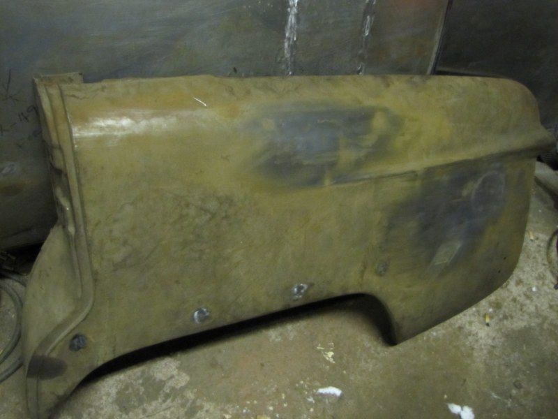

    Yeah,thats my another hobby.I got 73' Shovelhead,which has been in my possession over 10 yrs now.There is a pic of it on page 20 of this thread.Just dont want to repost same pics to this thread..
    I dont see myself as a brand maniac,but i guess pre-84' Harleys are closest what i can call "my thing".
    Here is a small update too:
    I decided to shave the gas door hole before installing the quarter patch,it was just easier to do it at this point.I also welded the trimholes and bumped few dents out.Its a "new" panel,but i guess long term storing can cause small dents by accident.There are few low spots,but i think i can deal with them when the panel is welded on the body.
