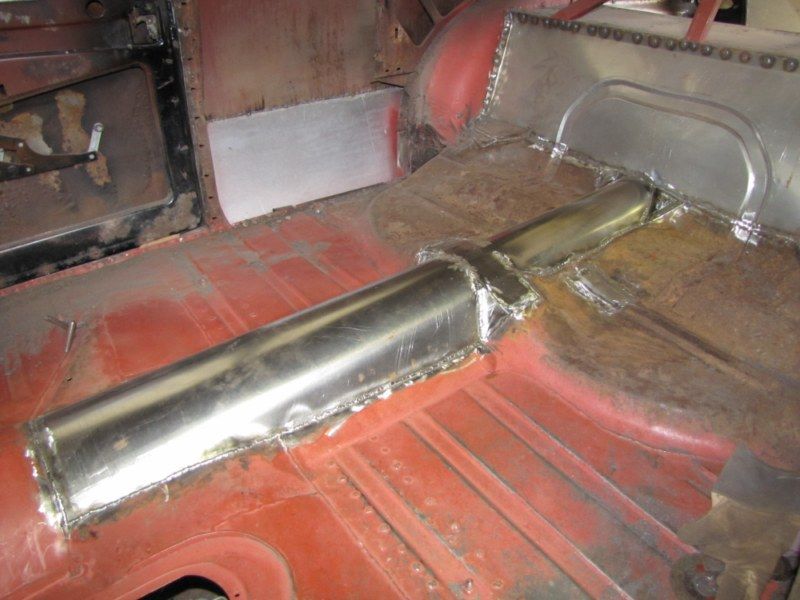

    I've planned to do this for a long time,so now was good time to get it off from the to do-list.I raised the back section of the ****** tunnel:
    It took some time to get it stretched to the correct shape and ****-weld it,but its there.There was some pitting and pinholes(again),so i had to make a small patch under the rear seat.
    If i ever to floorjobs like this i think its good to start with rockers and floor bracing,after that ****** tunnel and then the floor panels.
    That kind of order will make this kind of job a bit easier.

    Can you tell me how much you raised the tunnel??
    And how much clearance are you allowing for driveshaft... I will be doing mine similar and am looking for ideas.

    I didnt take any measures of the tunnel,i just took off the driveshaft from rear end,cut off the tunnel and raised the driveshaft against the rear x-member.Thats how i figured out how much i have to raise the tunnel.
    I am going to notch the x-member,so i counted that too with the raise.That raise is not much,but i am pretty sure that i have to modify the bottom of the rear seat.
    I dont know about the clearance yet,because the motor and ****** are mounted too high at the moment.I think it will be just fine,after the motor and ****** are mounted a bit lower.

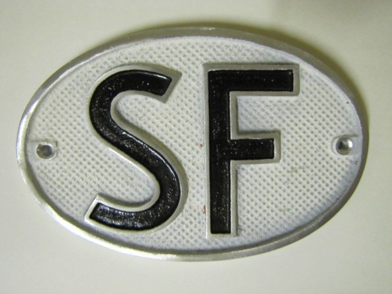

    Almost forget this.I scored this cast sign,i've been looking one for a while:
    Thats a recast of vintage country code sign for cars.
    SF stands for Suomi Finland,SF was our country code before they changed it to FIN.Nowadays those codes are painted on those stupid euro plates.When travelling in foreign countries at 50's to late 60's,law required that there must be a country code on the car,so we had those plates then.
    Later they were replaced to stickers,but there is nothing cooler than alloy cast sign:D

    Great score on the alloy cast sign!

    I guess original one could be a bit cooler than this one,but i guess i can live with it.
