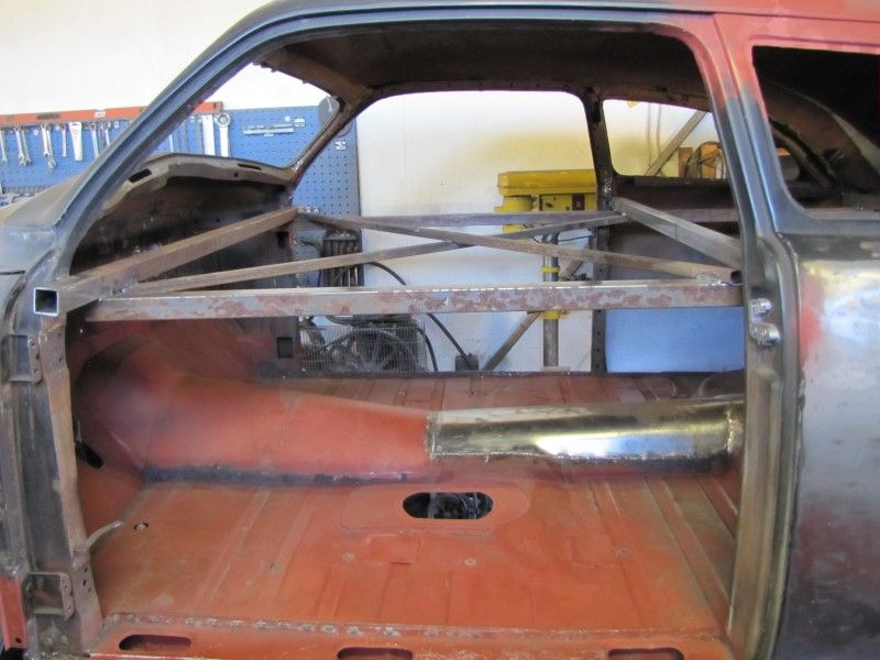

    I made a bracing for the body:
    Is it necessary,dont know.But like ausbuick said:It's better to be safe than sorry

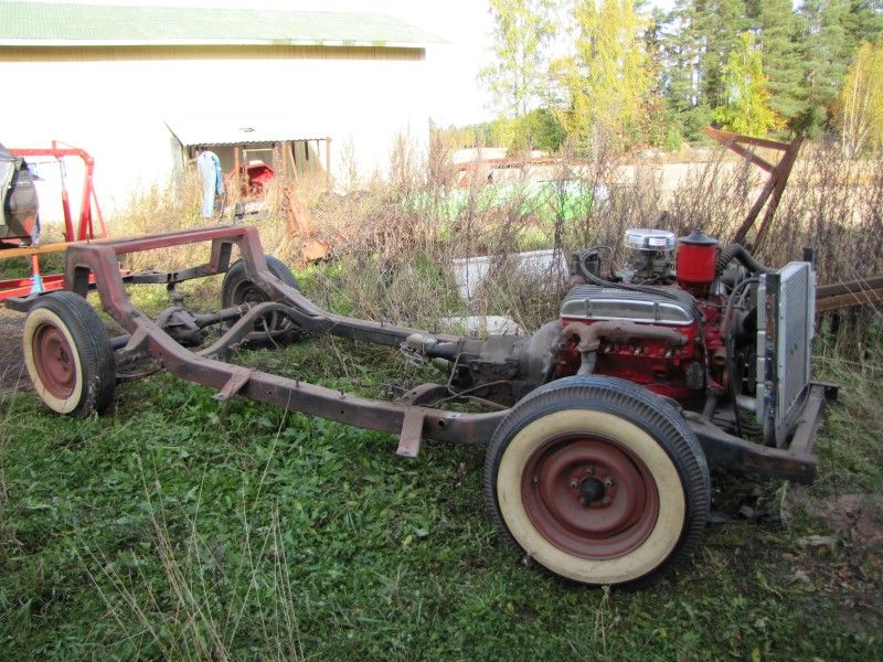

    The frame is actually pretty good,comparing how bad the body was:
    We pulled the motor and ****** off the frame too,but no pics of that..

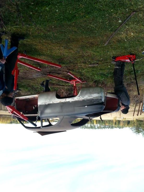

    Then we mounted the body on the rotisserie...
    Son of a *****.....It works too!
    And back to the garage...
    And now i can finish the body easily before the sandblasting,there are few spots that will need some attention.
    Only thing that pisses me off with rotisserie is that i didnt make it earlier:)

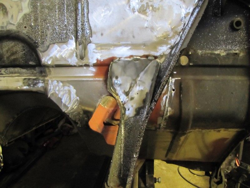

    When we lifted te body off the frame,the p***engers side body mounting leg was so rotten that it fall apart from the bottom.The brace needed some attention too.
    I got those issues fixed:
    I also cleaned up the welding seams from the firewall
