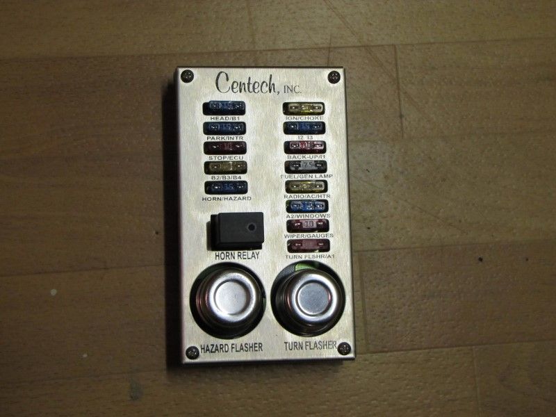

    Well,looks like my christmas present came right on time again.I bought a Centech wiring harness and at today the mailman delivered a box to my home that had this pile of wiring inside:
    I guess its too early to buy stuff like this,but i needed that fuse panel,so i can make a mounting bracket for it.
    I havent figured it out yet where to put it.I like that its not visible,but it must have easy access for fuses..

    I had to make mounting for the fusepanel,so this is what i got done:
    This is the Centech fusepanel.Its really compact and i think it looks like a bit better than a chunk of plastic with fuses and relays.
    Well,that looks like too "street roddish" to my eyes,so i have to figure out where to put it out of the sight.

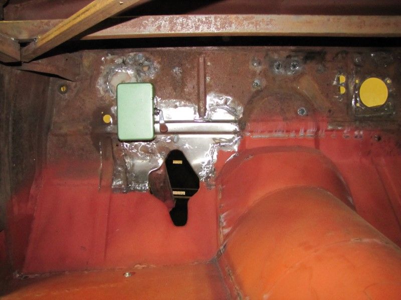

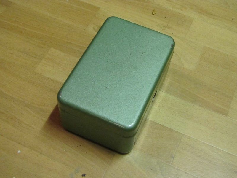

    Then i remembered the vintage cashbox,made by Kaso oy in Helsinki.
    Its rediculously small as a cashbox and the lock is busted too.So its pretty useless for that purpose.
    I guess we have a winner in this hide your fusepanel compe***ion.
    Fits like a glove,so its time to put a box in the box:D
    I welded a bung on the spot were the lock was and made a handle from stainless steel.I had to modify the latch catch too.Then i mounted it on the firewall by floating style,so there is room for the insulation and panel behind the box.
    I havent drill any holes yet for the wiring,because i dont know what kind of grommets to use.I guess i'll ask that from a friend of mine who knows the electric stuff better than i do.

    Those pics were shot from a bad angle,so the box looks like bigger than it is and the position looks like strange too.I shot a pic from better angle,just to show how it looks like:
    The lower notch on the hole is for brake pedal and the upper is for steering column,so i think that the box is on the right spot.
    I could move it more left,but then the lid wont open properly because then it will hit the emergency brake handle.
    I am not sure about the age of that box,but i googled that companys history.They started to make safes,cash boxes etc.at 1945.
    My wild guess is thats from the 60's..maybe.
