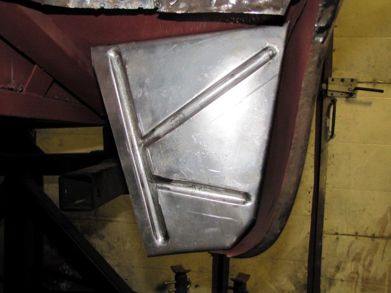

    Well,i guess i am not smarter than you.I made an exact copies of the original quarter braces.Ofcourse they didnt fit,because the trunk floors are far from originals.The quarter looked like **** with oem style bracing,so i had to make an another pair of them.
    Luckily the sheetmetal is cheap and i dont charge anything from my own time:D

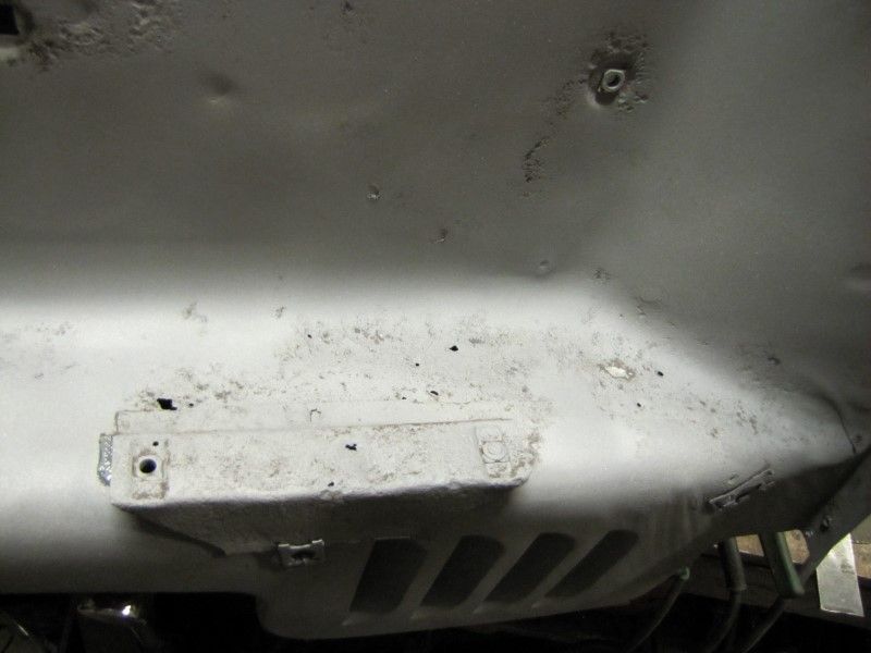

    They doesnt look bad,but i am glad i got them sandblasted.The blasting revealed few spots that need some work.I didnt even notice them before.
    The fresh air tunnel needs some fresh steel...
    And the battery tray area,what a surprise...

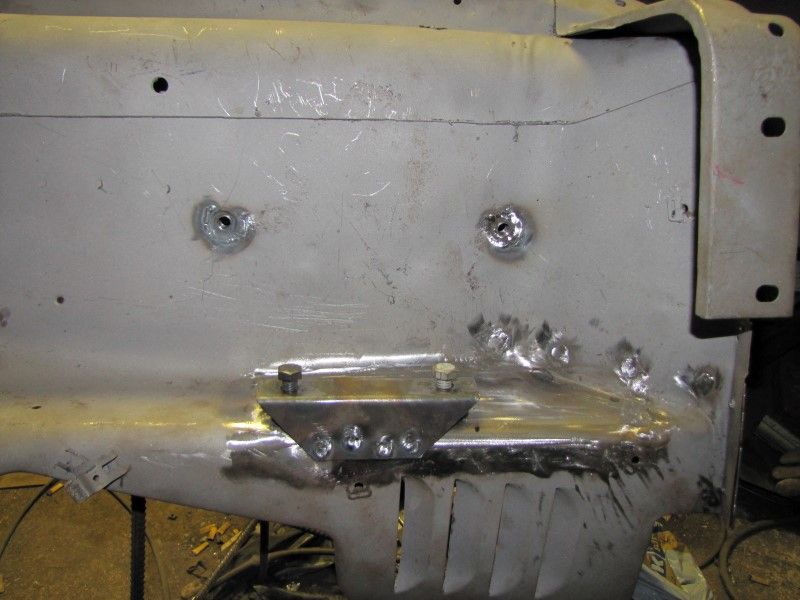

    I got the battery tray area done and there was a stress crack on the factory "press wrinkle",i fixed it too.Its pretty much done,but i have to fabricate new battery tray mounting bracket.
    Some fresh steel in the tunnel
    And back area of the outer side needed some new steel too.
    Luckily the p***enger sides inner fender is a bit easier to do..

    I also found few homemade 7/16 bungs from my stash,so i used them on the battery tray mounting.I think they are beefier than the originals were,but i guess they wont break so easily than the oem's..
